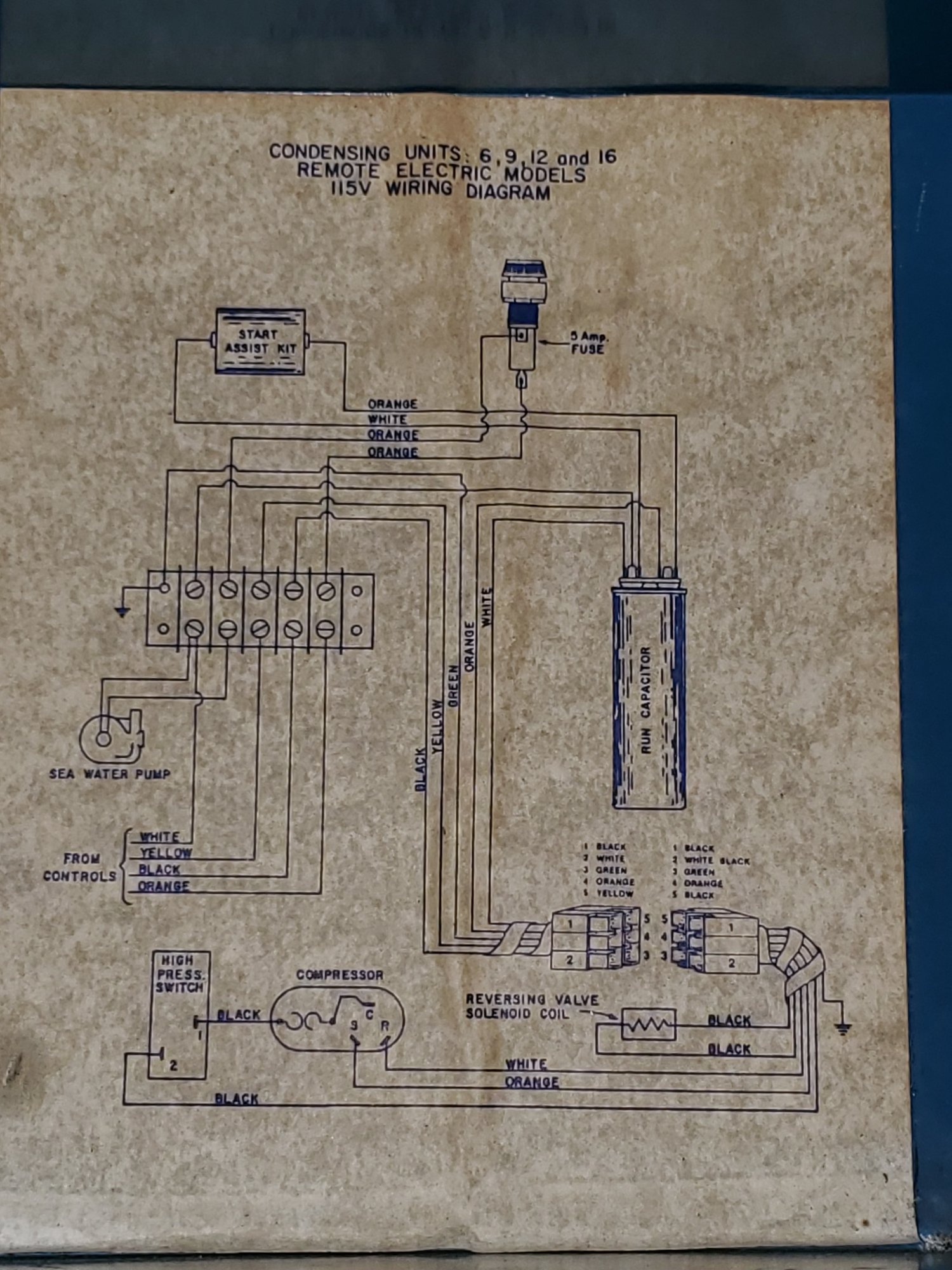

Found part of the wiring diagram inside one of the covers.
I suspect that the start or run capacitor might have failed. I my experience when a run/start cap. fails it has obvious physical signs, but this one looks good.
The wiring diagram shows a run cap. and a "start assist kit." I don't know what the kit is. A little research suggests that it's a thermistor. I'm unfamiliar with its' exact function.

Does anyone know what the "start assist kit" aka thermistor does? I'm looking for a technical answer. I know it help generate extra torque at 0 rpm, but how exactly?

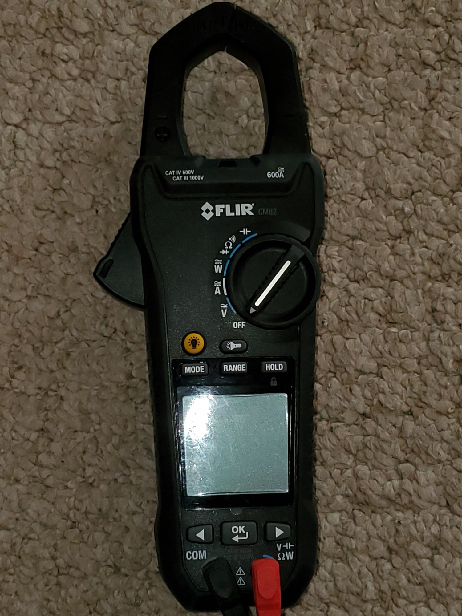

I went to work and borrowed a good meter that will test capacitors. My 25 uf run cap. measures 0. So I have found a problem.
The "start assist kit" is also known as a PTC, PTCR or a start thermistor. It basically shunts/shorts around the run cap during start up allowing extra current flow in the start winding. Just tested mine and it is also bad.

BTW the meter in the photo isn't the cheap meter I was referring to in my 1st post.

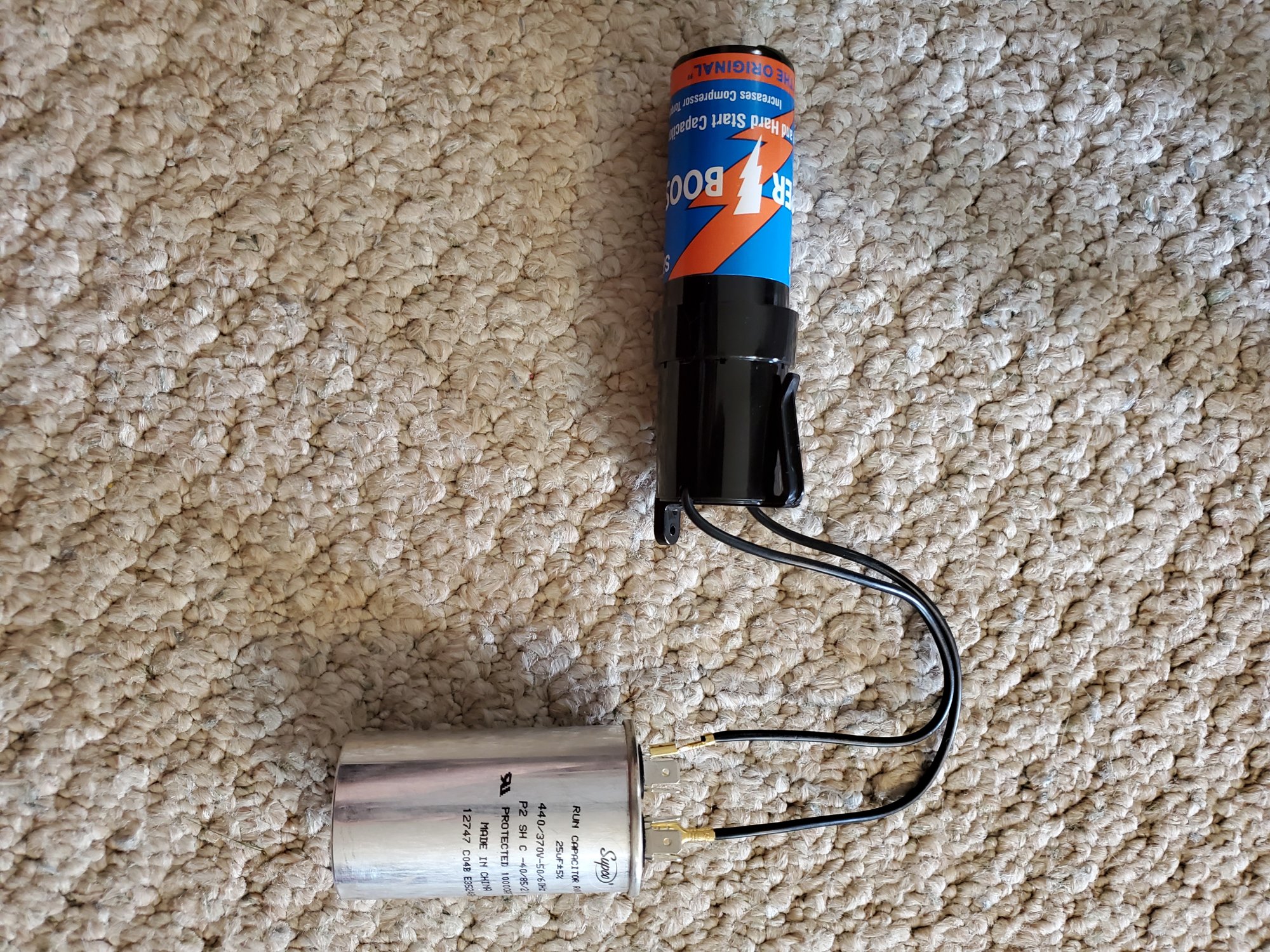

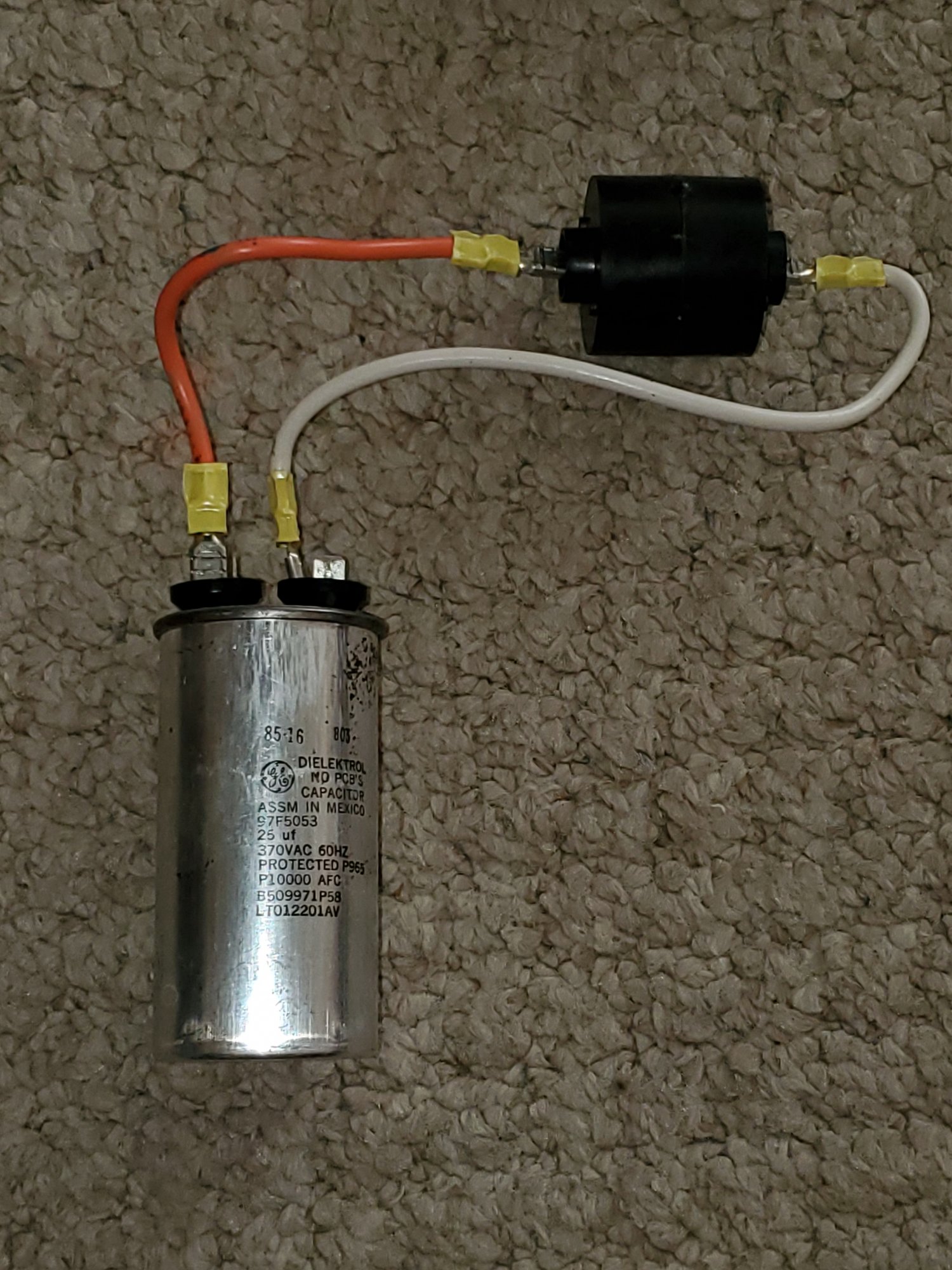

Installed the new run cap. and aftermarket start assist last night. I couldn't easily locate the OEM part. The AC works fine now.
Here is a picture of the hard start kit and the new capacitor. It works fine but there wasn't room to install it in the factory location so it's laying in the box with all the other wires.
Maybe this will be helpful to others.

At first I was a little confused by the diagram, the run capacitor is in line with the start coil. I expected it to be on the run coil but that's not how they work, lesson learned. I also had to figure out what the "start assist kit" actually was before I could test it. In this case it's a thermistor than shunts around the run cap. I replaced the thermistor with a had start kit because I couldn't locate the correct thermistor. The hard start kit is just a capacitor and PTC thermistor in series.

The 2 wire PTC hard start may work fine the first time the compressor starts, however if the compressor tries to start before the PTC has cooled it may not start. A 3 wire hard start with a relay or the Rectorseal 2 wire would solve this issue.
Jul 23, 2009
926
James,
The hard start setup that I used consists of a cap., 50uf i think, and a PTC. Super boost part # spp5.
I chose it because I didn't have a lot of extra space to mount a larger cap. and relay. I generally don't short cycle my AC and the old unit lasted a long time. I also didn't want a mechanical relay in a locker that gets water in it from time to time.
