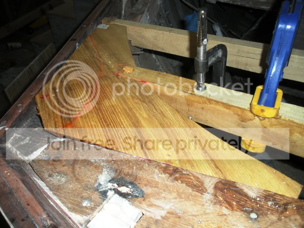

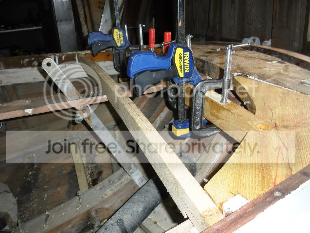

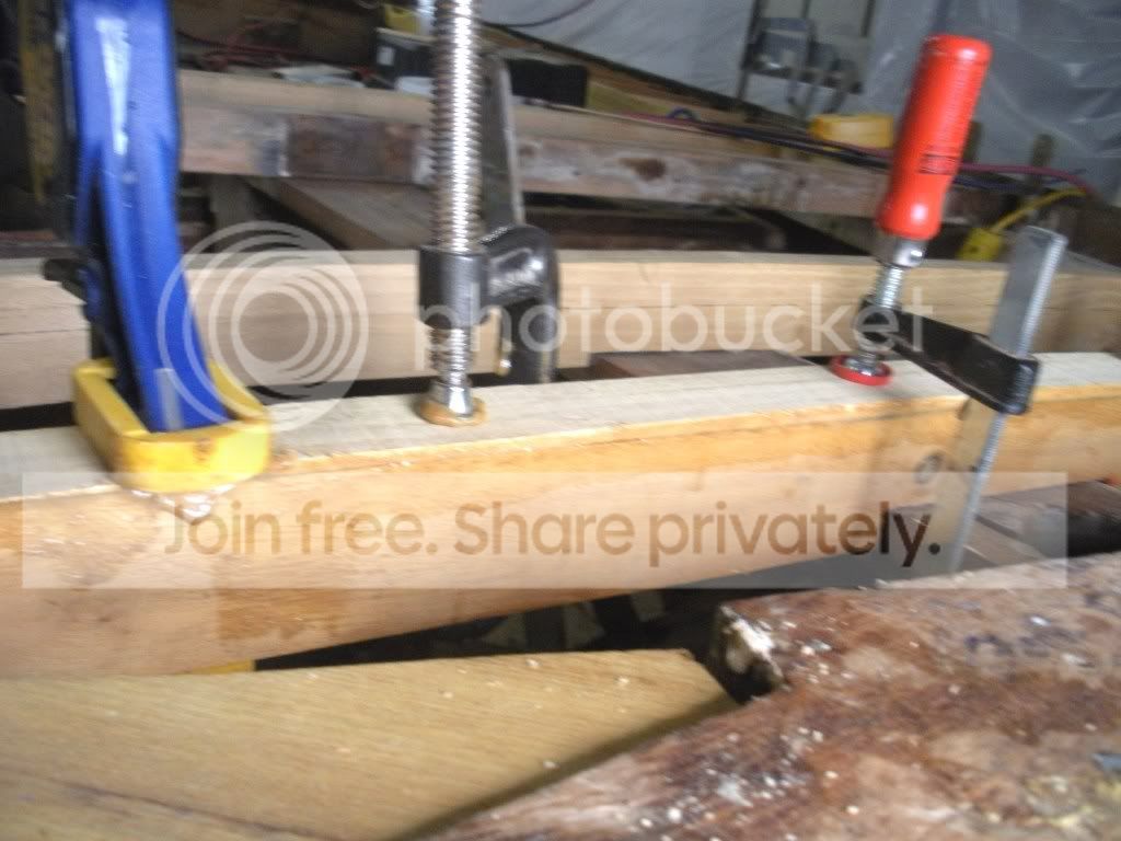

So, I get to the boat and work on the mizzen area, making some new deck beams. I made one yesterday using a template but when I put it on, finished all of the difficult joinery, I discovered the camber was off. I had to cut a camber rise and epoxy it on to match the rest.

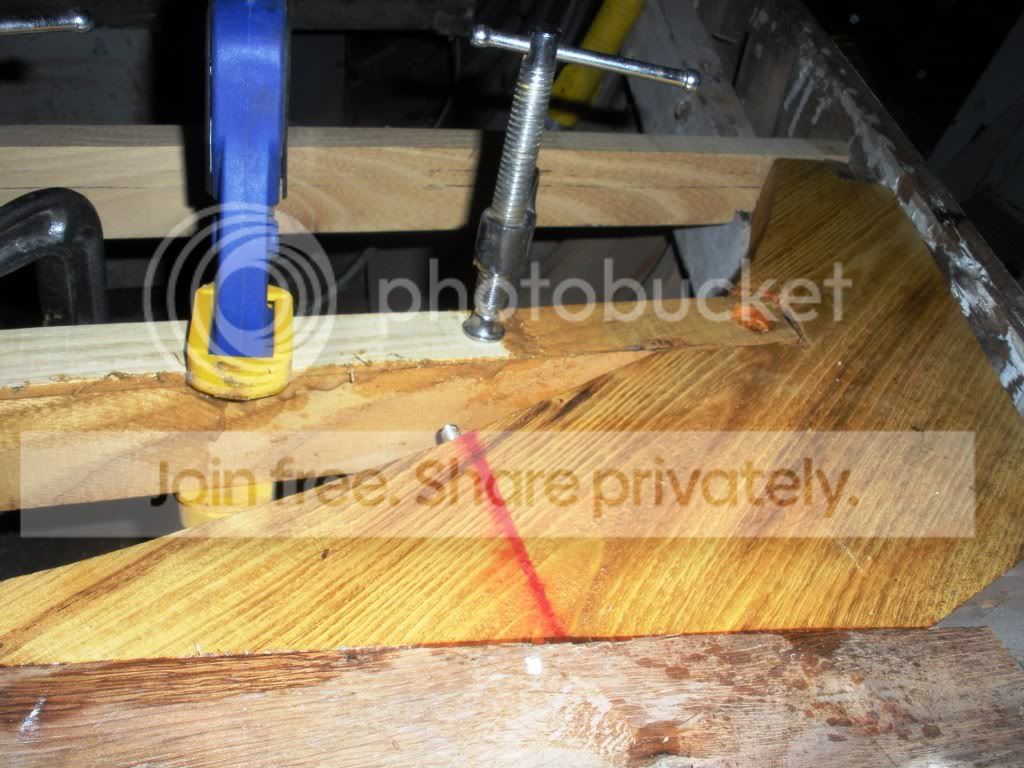

I also finish the other knee.
and got it all in place but not final bolted yet, hence it not quite lining up..
and
I need to CPES that other beam and then start on the hatch section.
