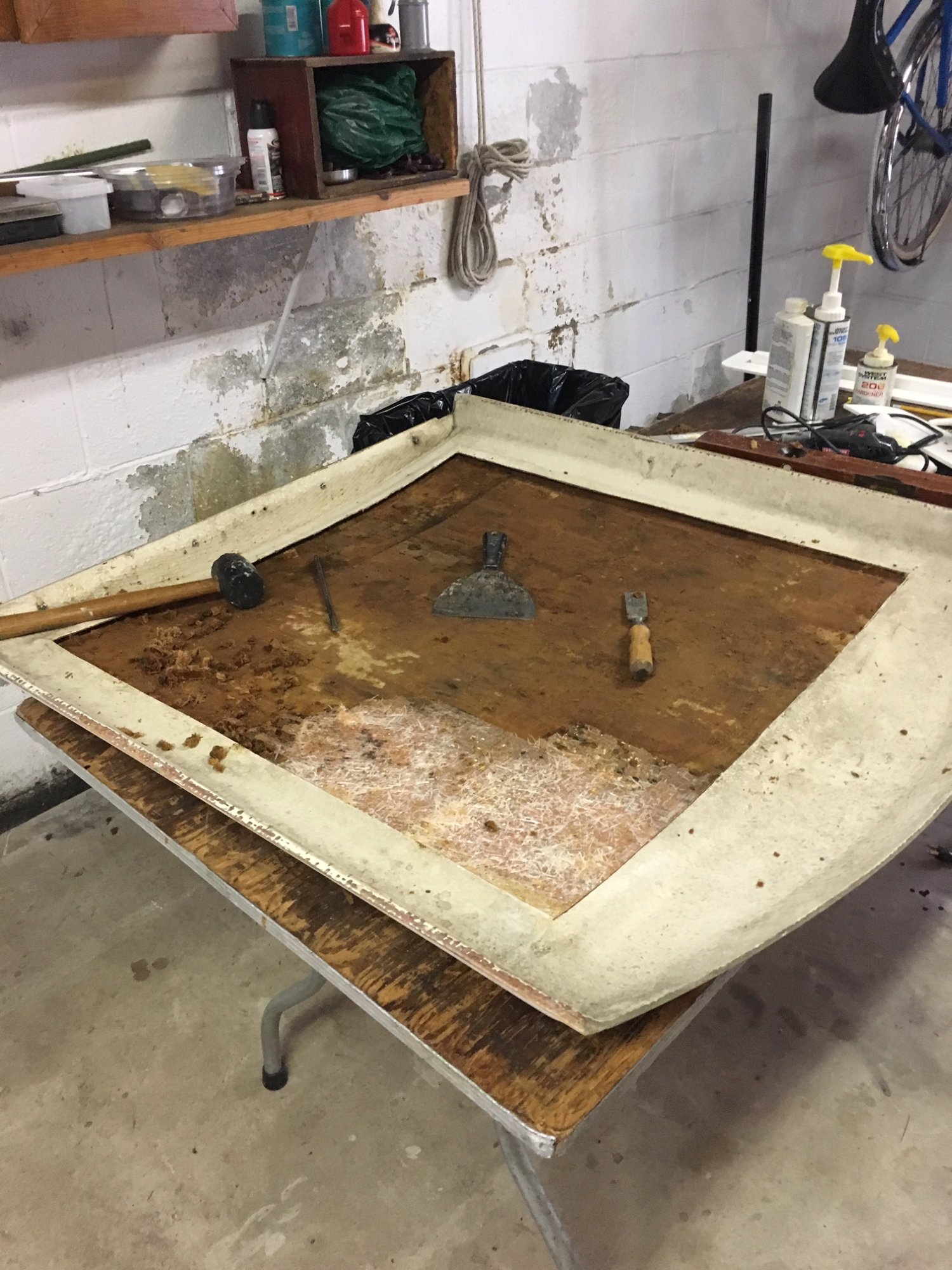

I have started the restoration of the companion way hatch. The hatch is not in a great condition, in fact worse than expected.
First I put two coats of epoxy on the topside to help keep the form of the hatch.

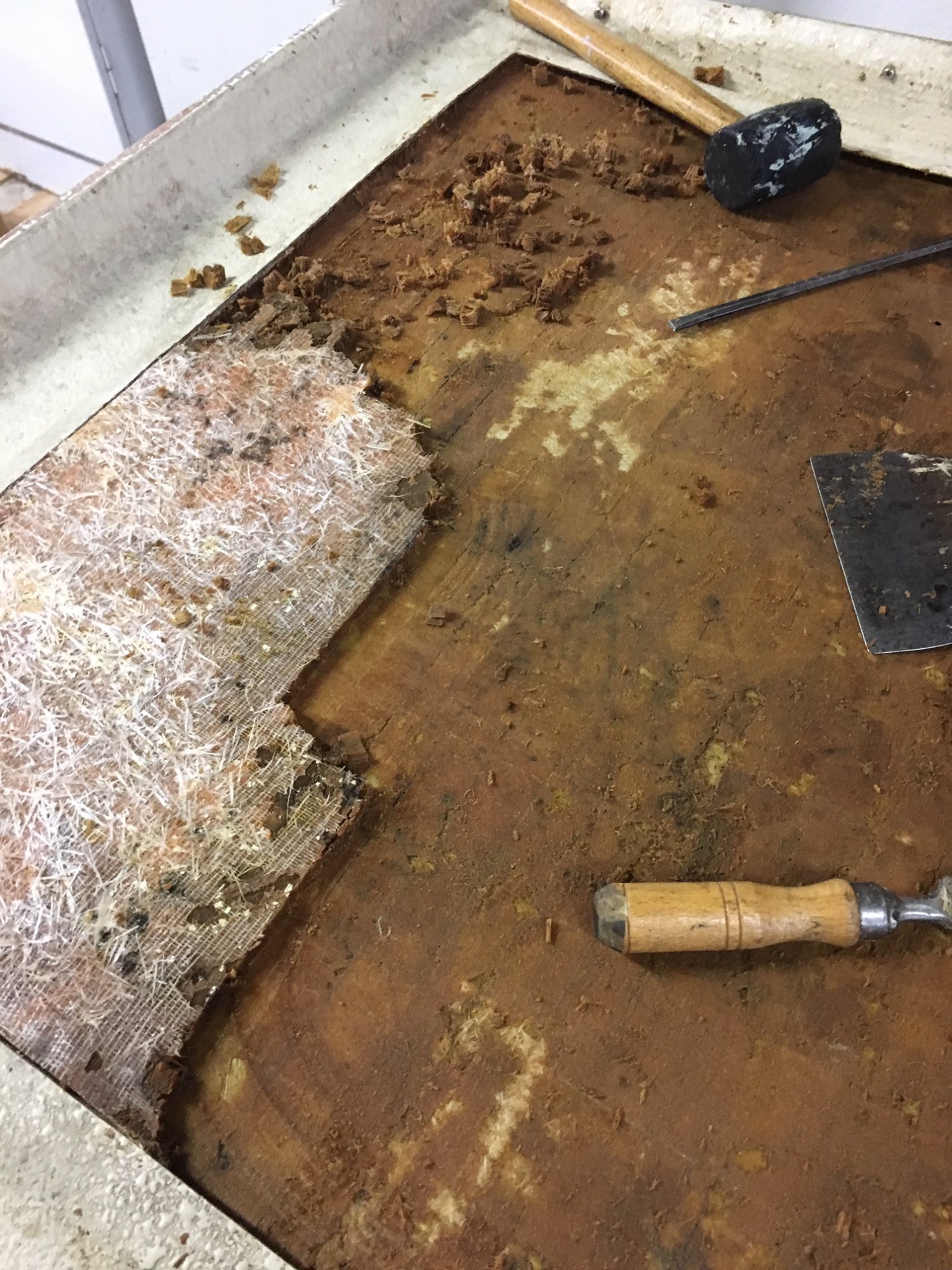

Then I turned it over and cut out the raised area which holds the Balsa boards

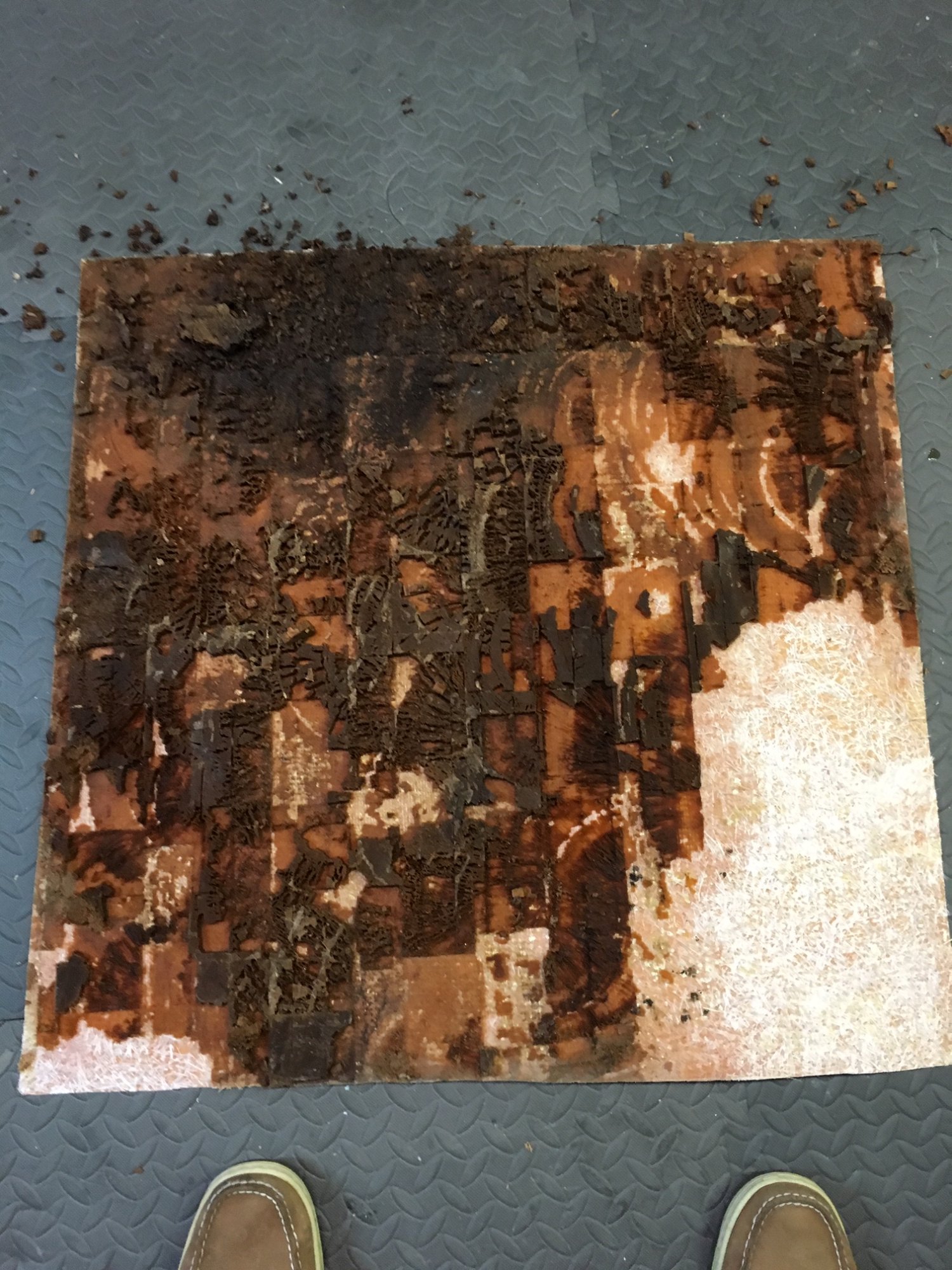

The piece that I removed had balsa attached to it also. Apart from one small corner, everything was water logged.
I cleaned it all out carefully

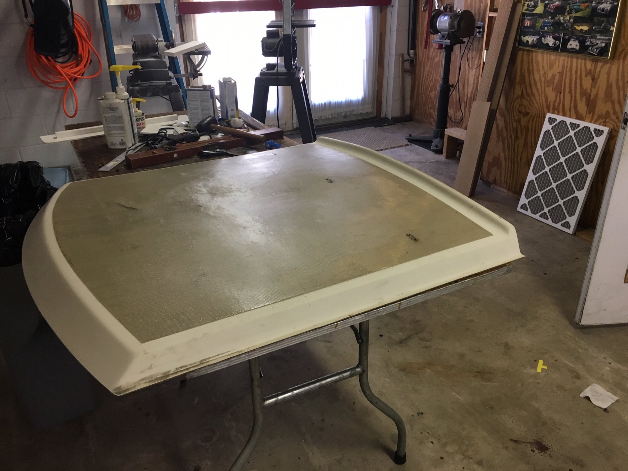

Once it was all cleared out,
I ground down the edges, washed with Acetone, ready to put a coat of epoxy on the inside

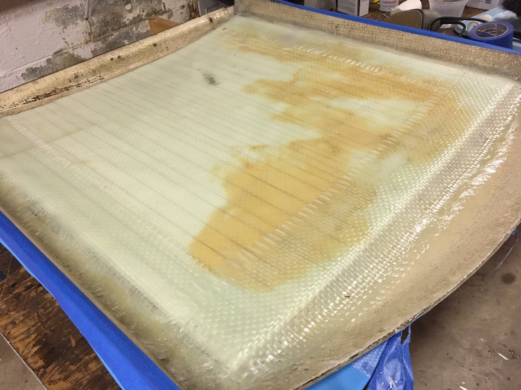

Update:

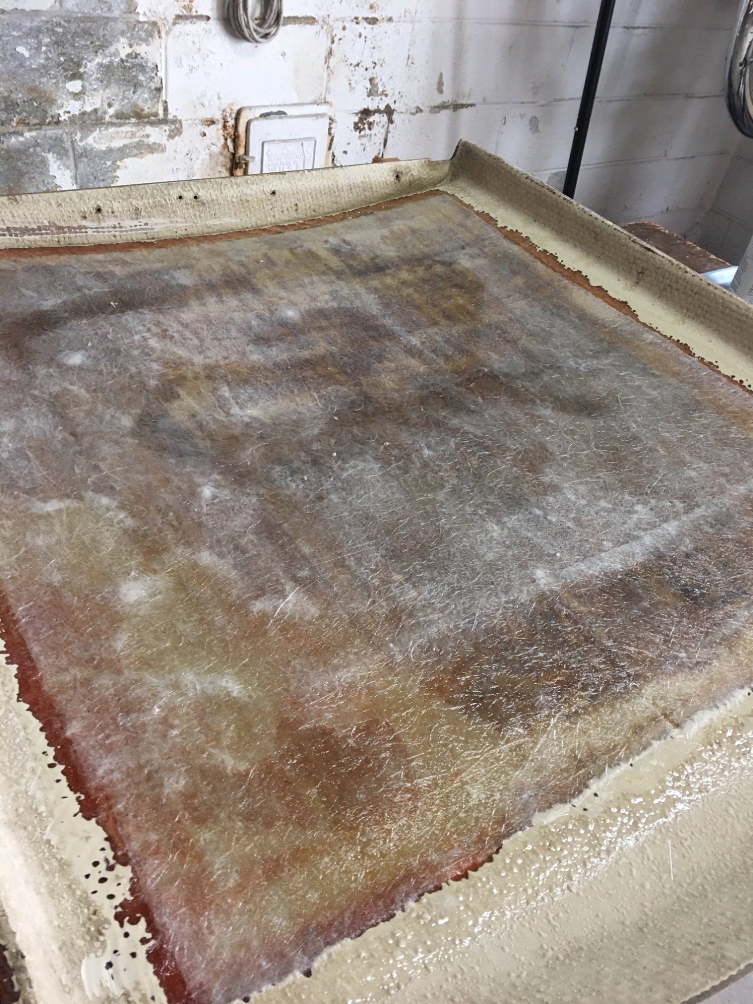

All the above was done on day one. Day two, I put down a coat of epoxy resin to seal the cleaned up interior surface. Today, day three, I laid a single layer of fiberglass strand cloth down, with slow curing epoxy resin.

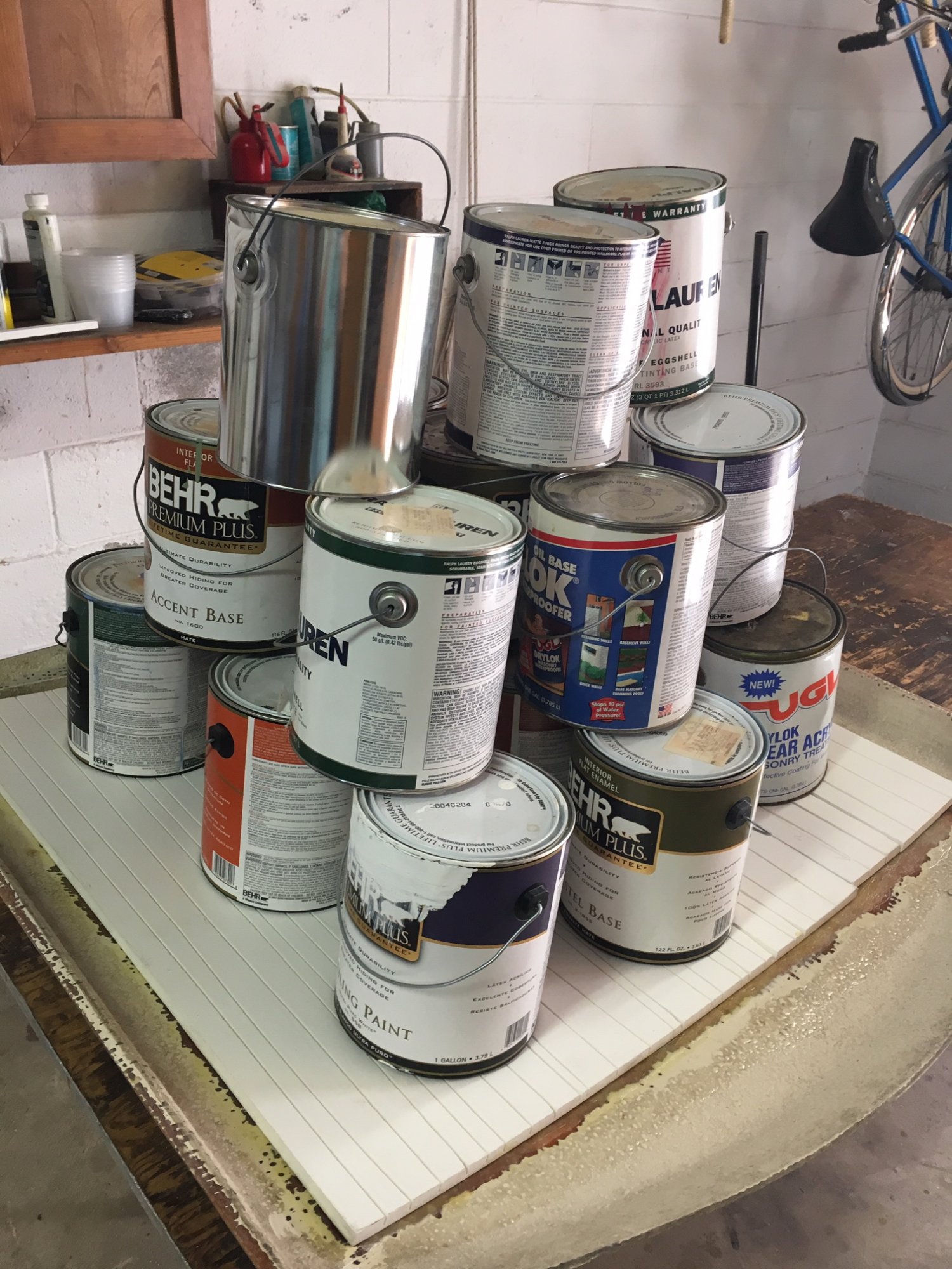

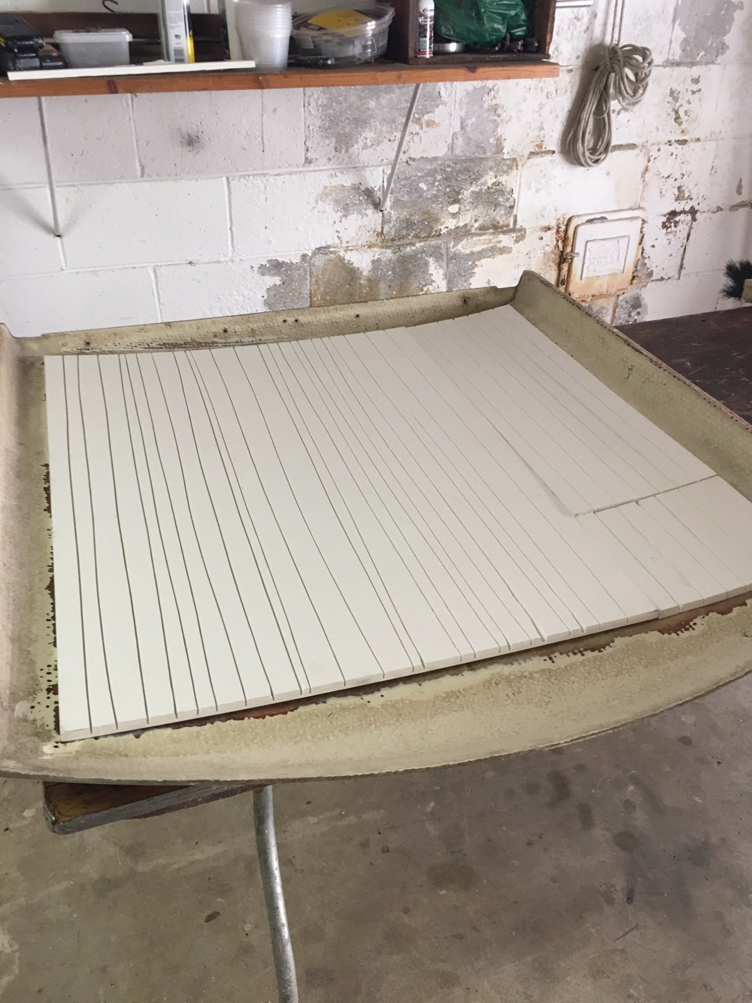

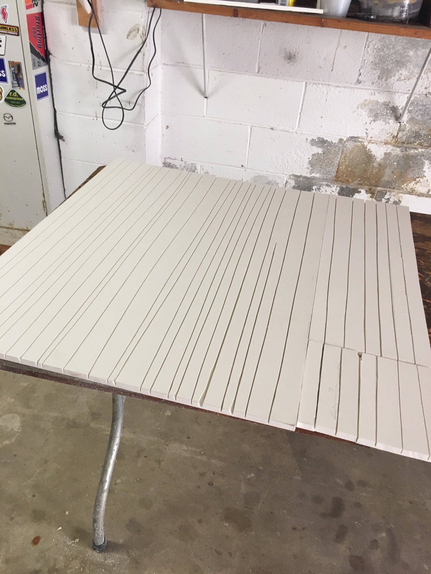

The plan is now to get some 3/8th pvc board, 32x32, cut grooves one way to let it curve to the shape of the interior, epoxy that in and fill the gaps with thickened epoxy resin. Once cured, seal it all in with a woven fiberglass cloth mat, and a final coat of tinted epoxy resin.
Picture of today's work

Congrats on what you've accomplished so far. Very impressed. Keep in mind mat is not as strong as roving. Not sure what you meant by PVC board. I would have some concern with the lack of rigidity from PVC unless it is "structural foam" made for the job such as Airex or Divinycell.

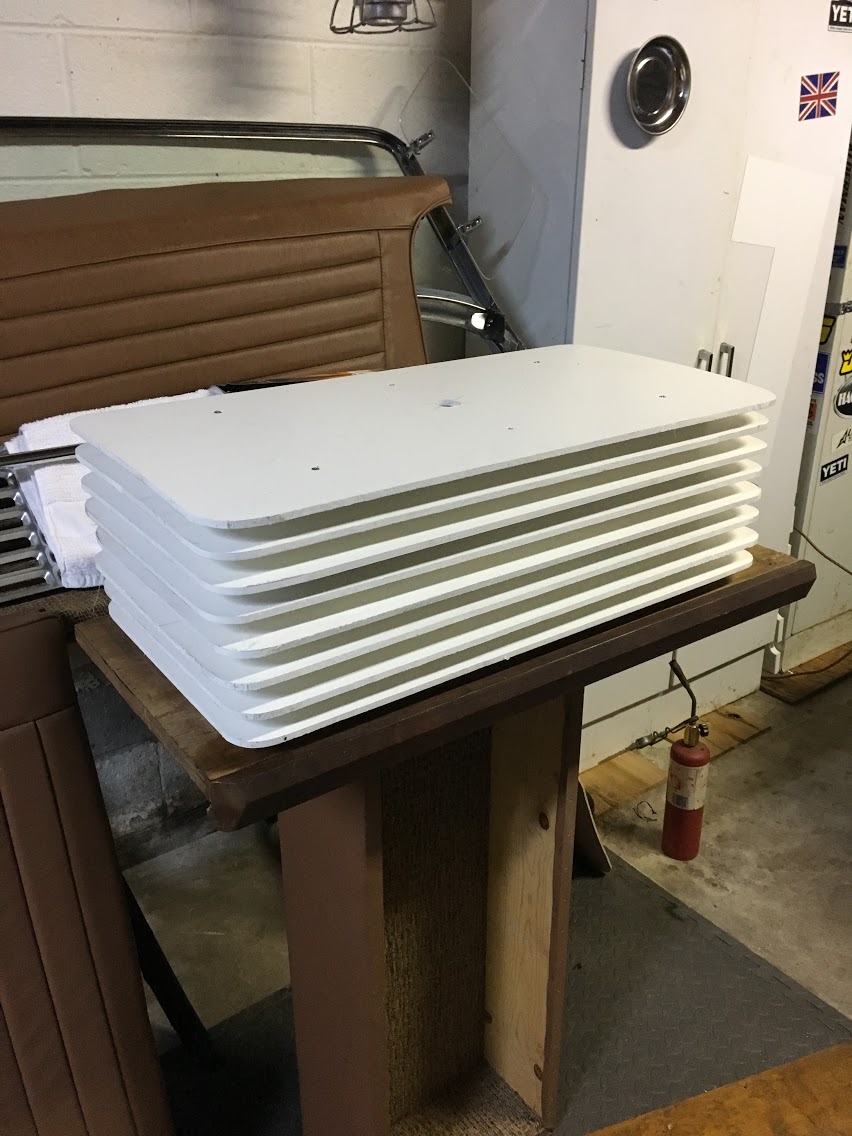

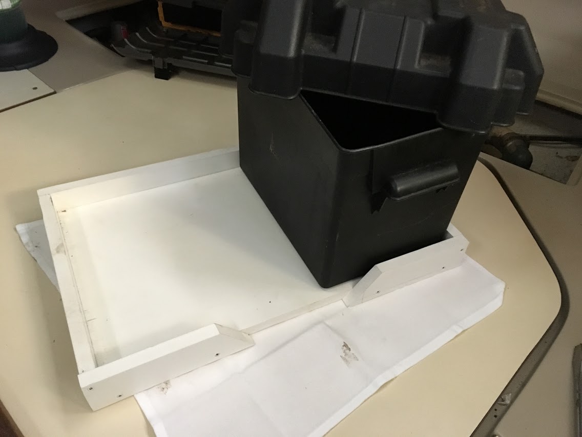

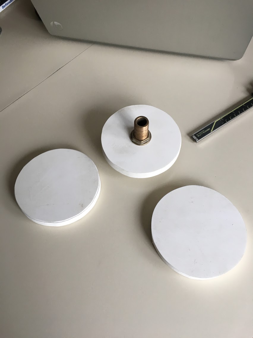

PVC Board is used in exterior construction for Soffits, gables and facias. Comes in Lumber sizes. AZEEK is a brand name of similar product. Its strong but light in weight. I have used it on the restoration of the boat in many areas mainly because it wont rot like wood.
I made storage covers for the various areas in the boat, mainly under seats and cushions, shelving in the lazarette and 1/4 berth, backing discs for thru hulls, supportive box for the black water tank in the V berth, Battery box shelf, and some other items.
That kind of board is not ideal for this application. Not rigid enough and won’t adhere well. Heavy for the strength. I mentioned some better choices my prior post.
Apr 22, 2011
976
Hunter 27 Pecan Grove, Oriental, NC
I agree with Captain Larry that pvc board would be a bad choice. The way I understand it, the way a coring works is much like a I-beam works. It is critical that the material that bridges the two surfaces is bonded tenaciously to both surfaces to achieve the I-beam advantage. I don't think pvc board can be adhered well enough to do the job.
Aug 11, 2011
1,020
O'day 30 313 Georgetown MD
I pieced together three pvc boards, cut grooves in, contact cemented the boards to the inside of the hatch to get the curve in, then weighted the boards down to the inside skin.

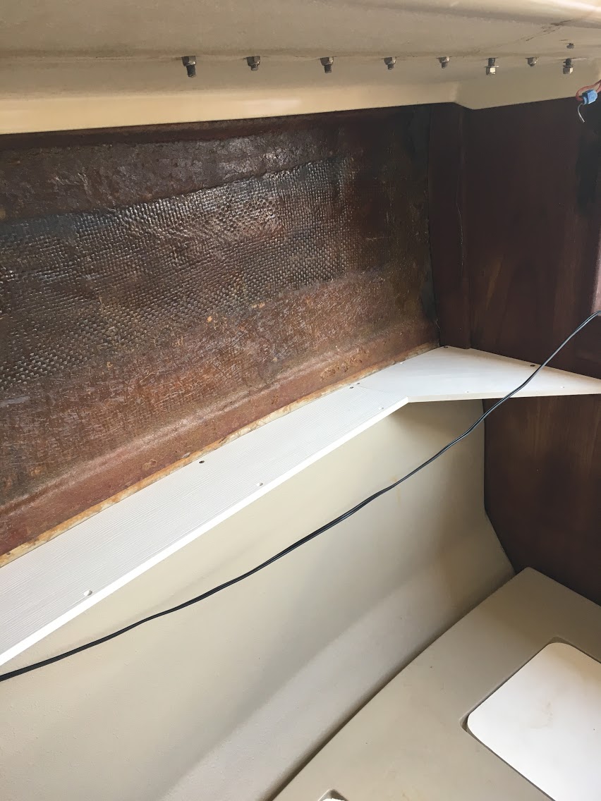

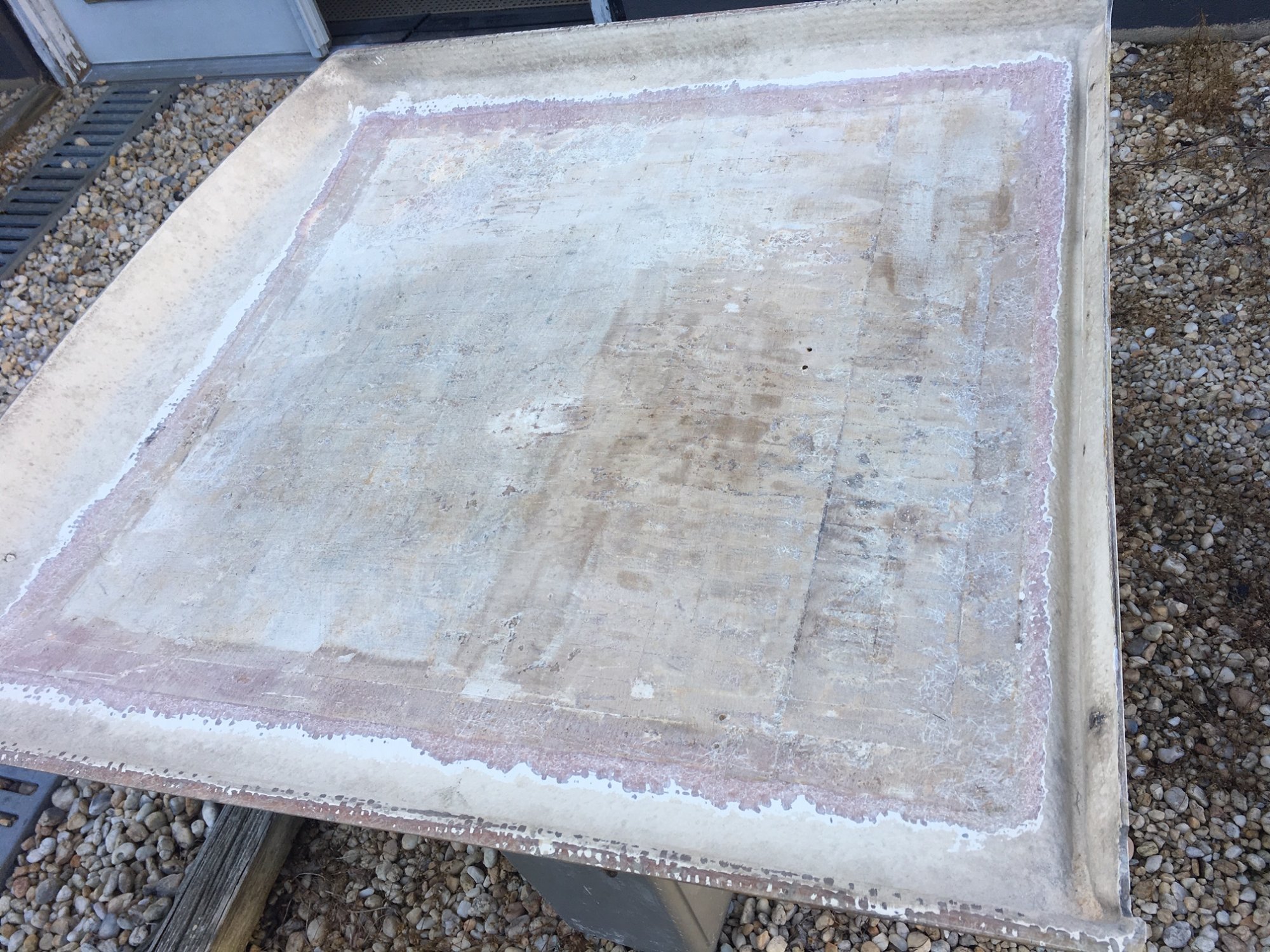

Nice job. What's the other side look like? Anybody ever add Teflon strips to the teak sliders to both shim it up to take up for the wear over the years and also to reduce friction making opening and closing the sliding hatch easier? Might be easier to add to the sliding companionway cover instead?
Aug 11, 2011
1,020
24 0z roving with plenty of slow hardened epoxy. Next is sanding and then a coat or two of cream color or white Interlux Brightside paint. The stain is a mishap with some old resin.
