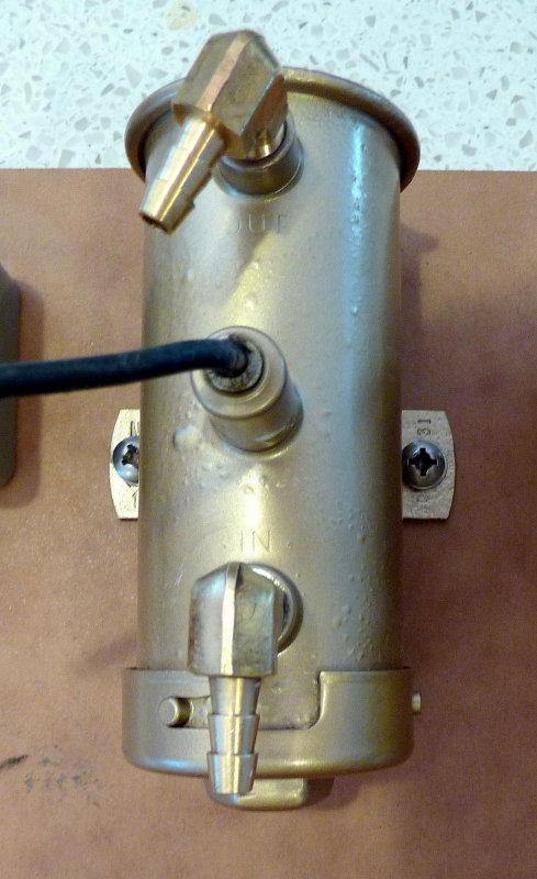

Changing The Internal Filter in A Facet Interrupter/Gold-Flo Fuel Pump
This is a Facet "Interrupter" or Gold-Flo fuel pump. They are found on many vessels especially those that shipped with Westerbeke or Universal engines.
The Facet "round" pumps are reliable, this one is over 27 years old, but many owners miss a key maintenance item, the pumps internal filter.

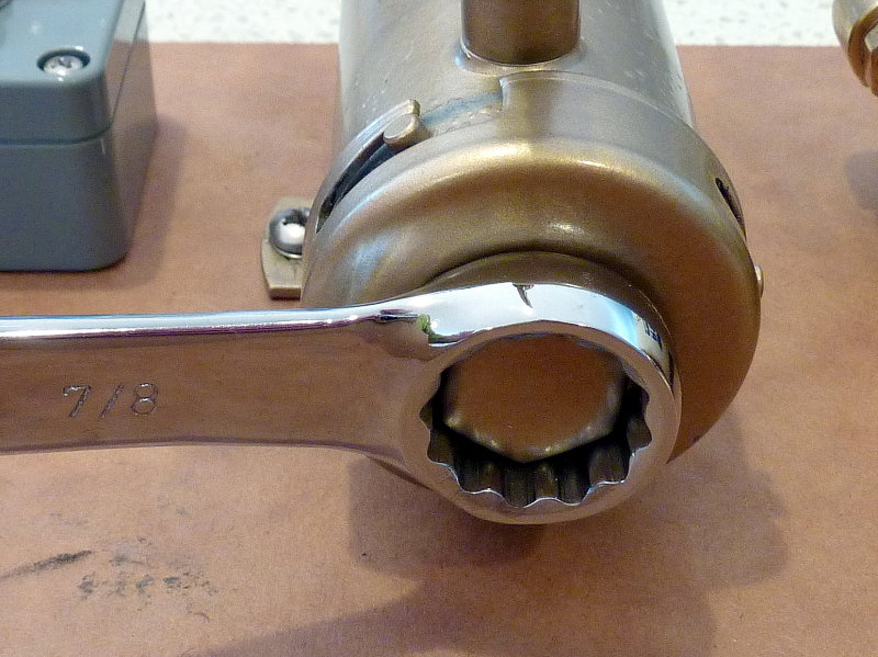

Open The Base
To access the pumps internal filter a 7/8" wrench is used. The pumps base twists off in a counter clock wise rotation.

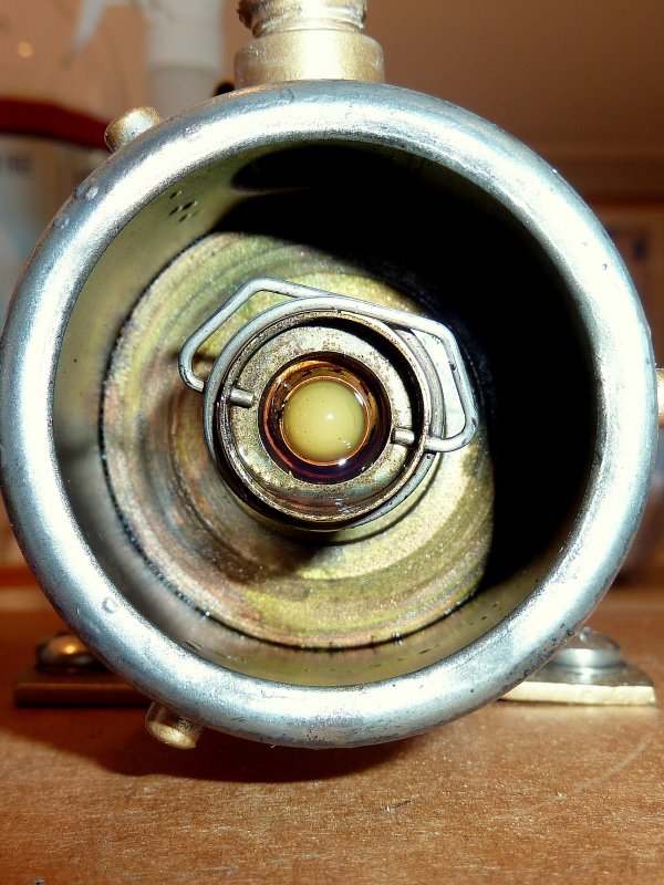

Base Off
In this photo you can see the sealing gasket, still in the base, and the filter still in the pump housing.

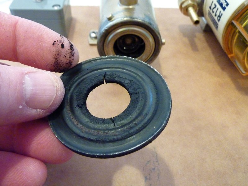

The Gasket Is Usually The Weak Link
As you can see this gasket should have been replaced long ago. Owners who do know about these filters often assume that because most of these pumps were installed after the primary fuel filter that changing the internal filter is not necessary.
This pump leaked due to a failed gasket and made a mess of the boat it had been in. It was also badly rusted and as such a decision was made to install a new one due to age and condition.
I cleaned it and painted it and now use it as a portable fuel transfer pump. If it fails I will know about it and it won't fill an owners bilge with fuel...

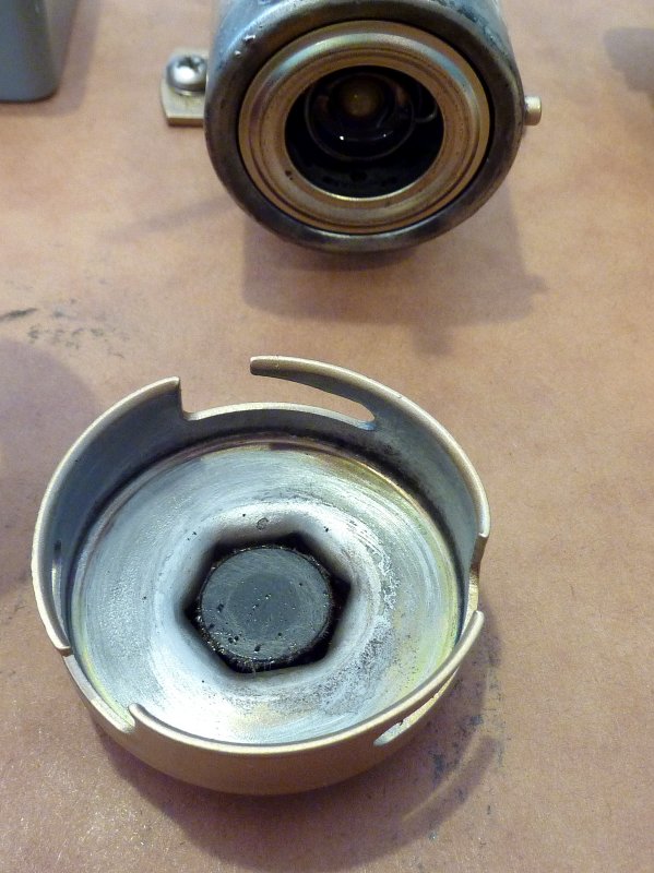

Clean The Base
Here's the base with the gasket removed. Clean all the "varnish" and sludge out and get the surface as smooth as can be. This picture is after I wiped it out but before I cleaned with the some wet sand paper..

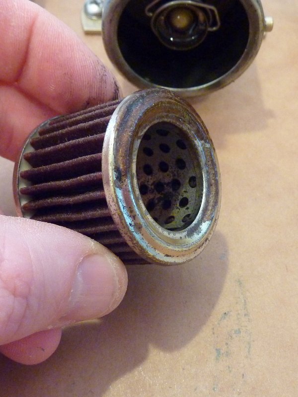

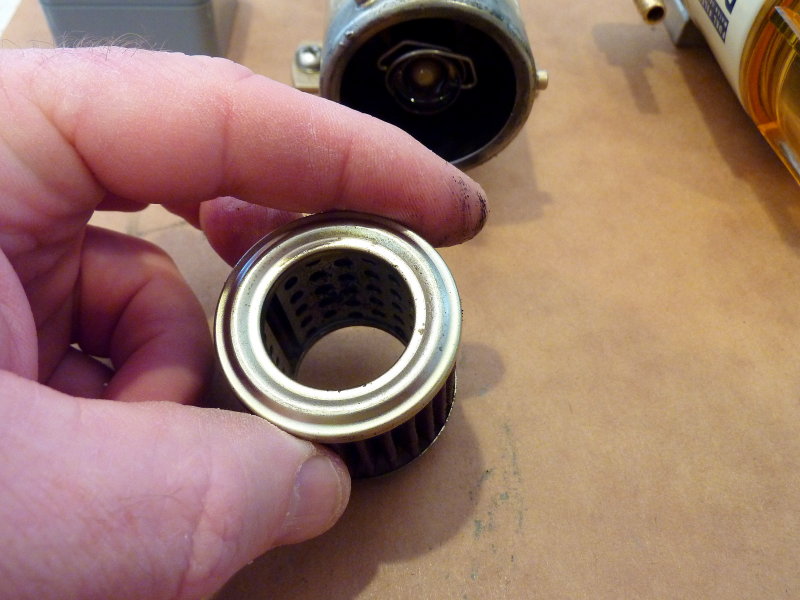

The Filter
With the base removed the filter will come out with some wiggling.
This was actually the end that faced the gasket and we can see evidence of water infiltration. The previous pictures show the filter inserted for illustrative purposes only and it was upside down from the way it actually came out. Despite being down stream from a Racor primary fuel filter the pump still had some water in it. This was likely due to a failed 0-ring on the boats fuel fill.
Facet no longer uses metal/paper filters in these pumps, this one was 27 years old, and they are now just a simple 74 micron screen.
Top Of Filter
The top of the filter shows no water damage and no rusting.

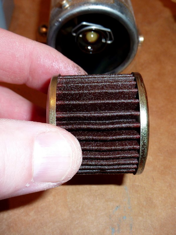

Filter Not Too Bad
For 27 Years of use the filter is not too bad. This means the Racor, that was down stream, did a decent job of protecting it. This is a very large particle capture rate at 74 micron so you would not expect it to be too bad as the primary filter should be getting most of it.
If it had been located on the fuel tank side of the primary filter it would likely look considerably worse.

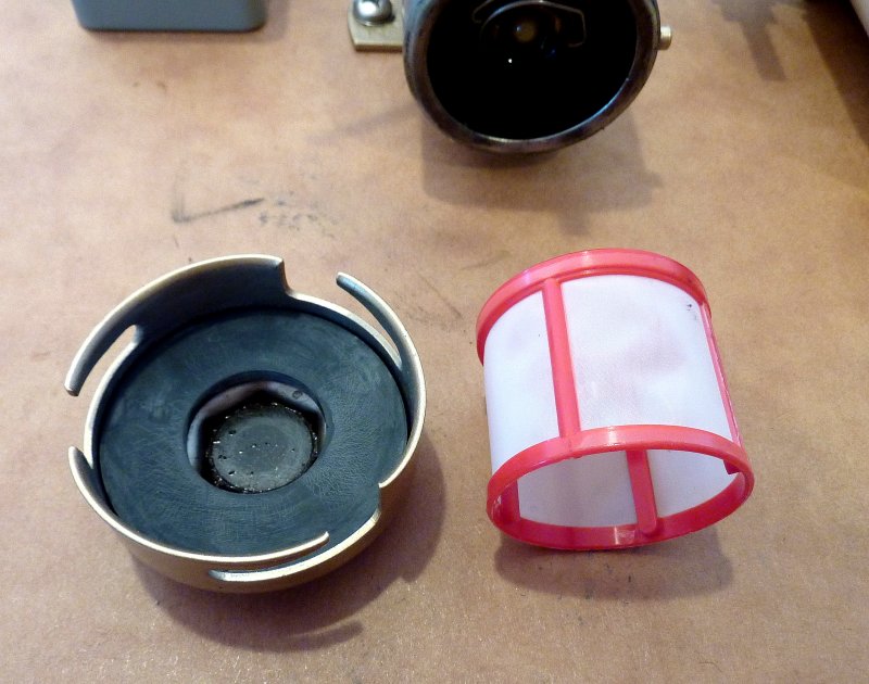

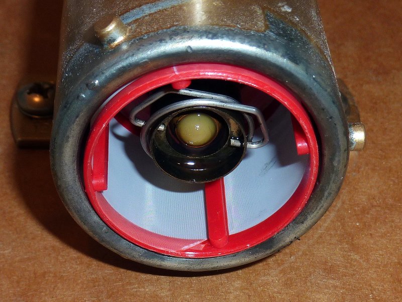

Insert The Filter
Slide the new filter into the housing as shown. The new filters are asymmetrical and the small hole end faces AWAY from the gasket.

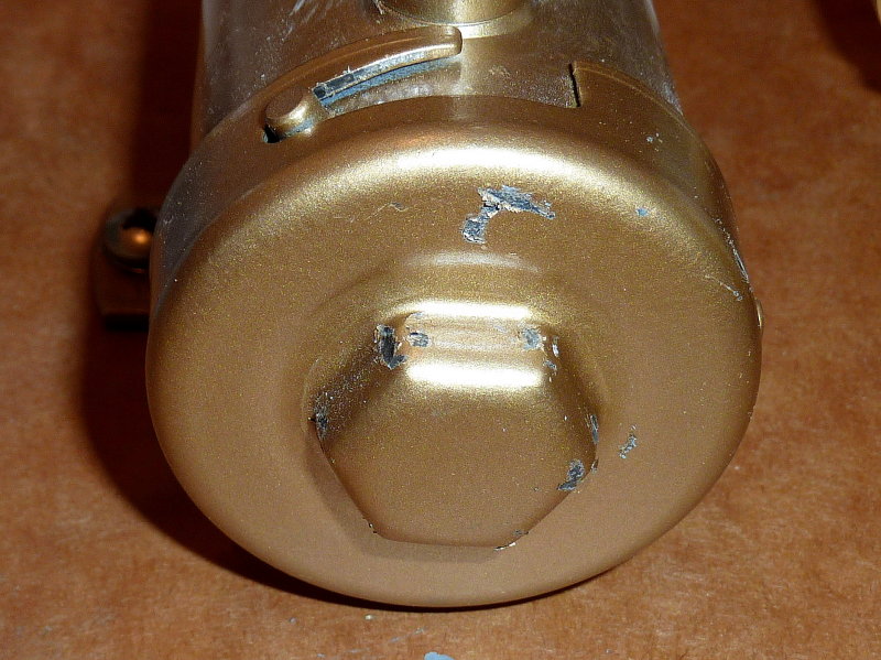

On our new to us 1988 Sabre with Westerbeke 33A engine the fuel pump has a ground wire on the bottom of the housing were you show the 7/8 hex. I had a devil of a time getting the cap off. I suspect it had never been removed as the red paint was not scarred or damaged. I found the filter pleats completely filled with black / gray junk with the consistency of toothpaste. We had started to find the engine getting fuel starved and started looking for reasons. I had changed the Racor and smaller secondary filter earlier but not the fuel pump as it was so difficult to remove. Is there an easier way to remove with this ground wire ?

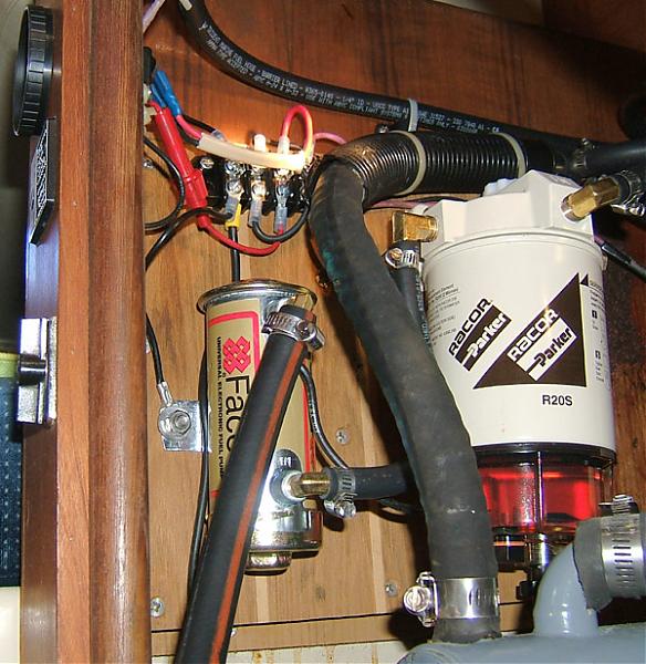

Here's a photo of the Facet pump installation for our M25XP. Notice the Neg ("ground") wire to a mounting tab.
Also, some might find this thread interesting concerning a voltage dropout problem I found and fixed.
