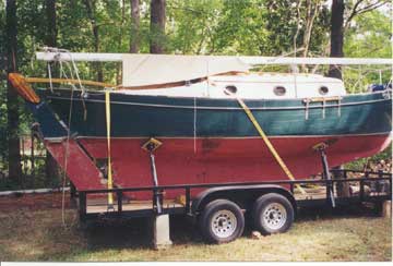

There is a Pacific Seacraft (Dana) sitting on a double axle trailer next to my SJ23 where we sail on the Columbia river. It is quite heavy and requires a 1 ton truck to tow. He used a Dodge Ram 3500. To raise the mast requires a truck with a boom to lift it off the trailer and install. To launch the boat they attach a 100 foot steel cable , doubled, to the truck so that the truck is 50 feet back up the ramp from the boat and trailer. If all goes right on the first attempt the trailer goes way out into the water and the boat floats off. Reverse to recover the boat.
This is an operation that requires 3 knowledgable souls and a good bit of skill. They only have used the boat once in the last 3 years which is sad. This is a boat that I would not hesitate to take anywhere if properly fitted out.

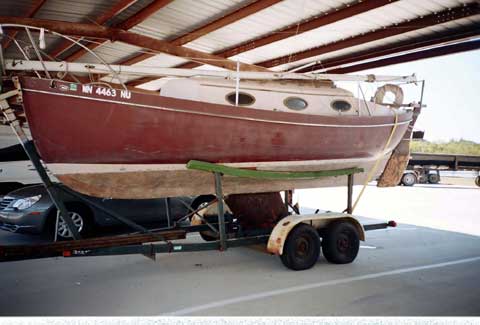

A Seaward 25 anchored near us...
...in the Everglades and I was really impressed with it. I thought that it looked much more seaworthy than our Mac. I just did a look on this site...
http://www.image-ination.com/sailcalc.html
...and was surprised to see that the capsize ratio was 2.17 for it (the 25) and 2.14 for the 26 mentioned above. Our Mac (26 S) comes in at 2.24. Not too far from the Seaward, but I would for sure rather be on it vs. the Mac if we were off shore in heavy weather. The Pacific Seacraft 25 comes in at a more respectable 1.9.
It looks very seaworth, but I'm not sure if I would really call it a trailer sailor...
... but it is trailerable and is one of the 20 boats in Vigor's 20 SMALL SAILBOATS TO TAKE YOU ANYWHERE along with A Cal 20 and the Catalina 27 and 17 others. A good book if you haven't read it,
