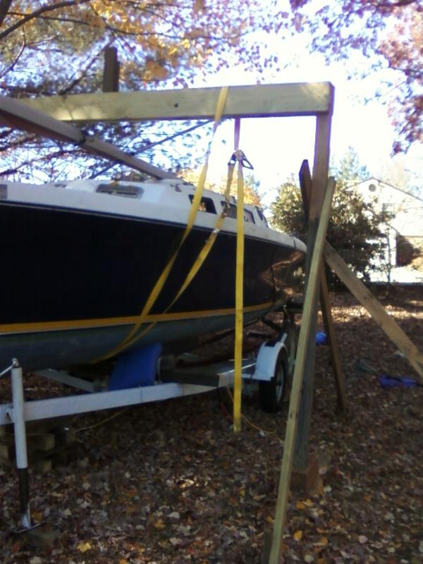

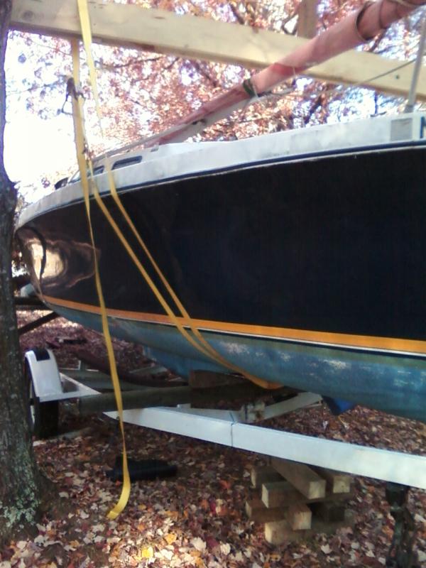

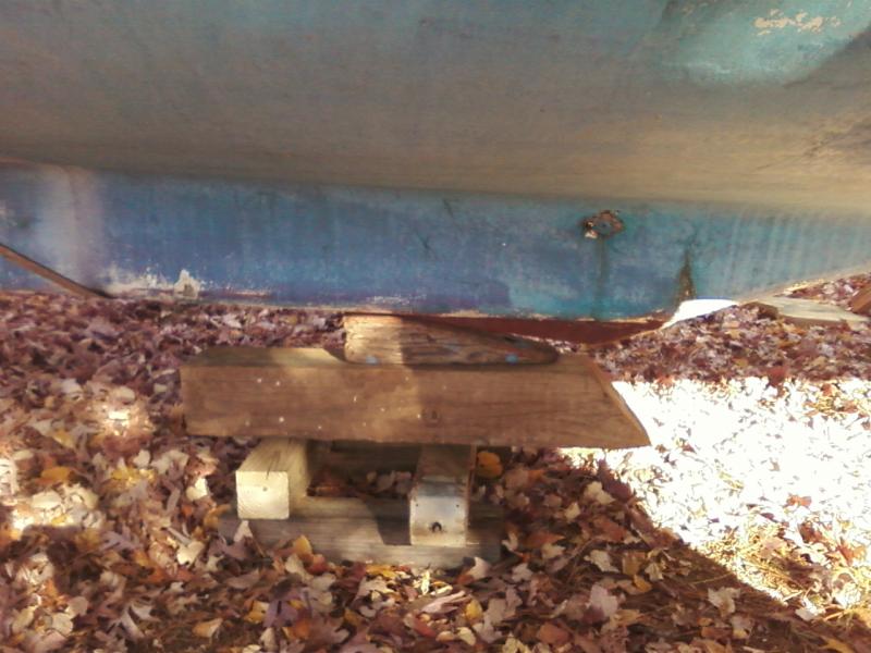

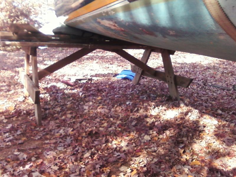

Looks like you blocked up the stern, then lifted the front enough via straps so you could slide the trailer out from underneath. On the stern end looks like you used some sort padding to conform to hull shape what did you use? Also like that you've supported the keel like you would when trailered. I need to drop the keel on mine and this helps a lot in planning it out. Don't have a nice tree like that to help so will need to make some A frames but I like that I only need to worry about the bow end that helps a lot. Will you block up the bow or just let it hang?
13,096
Hi Voltz

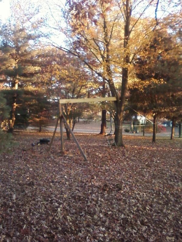

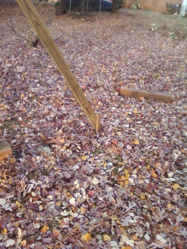

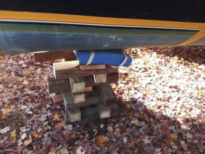

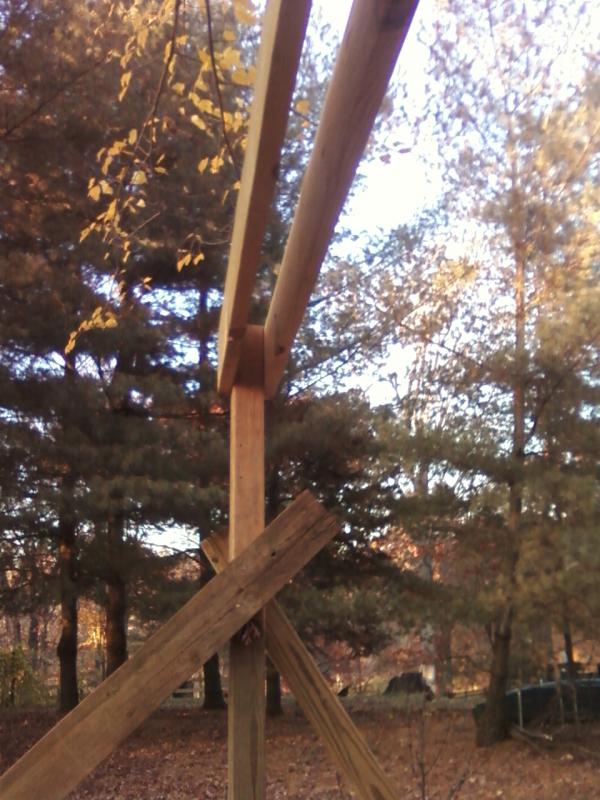

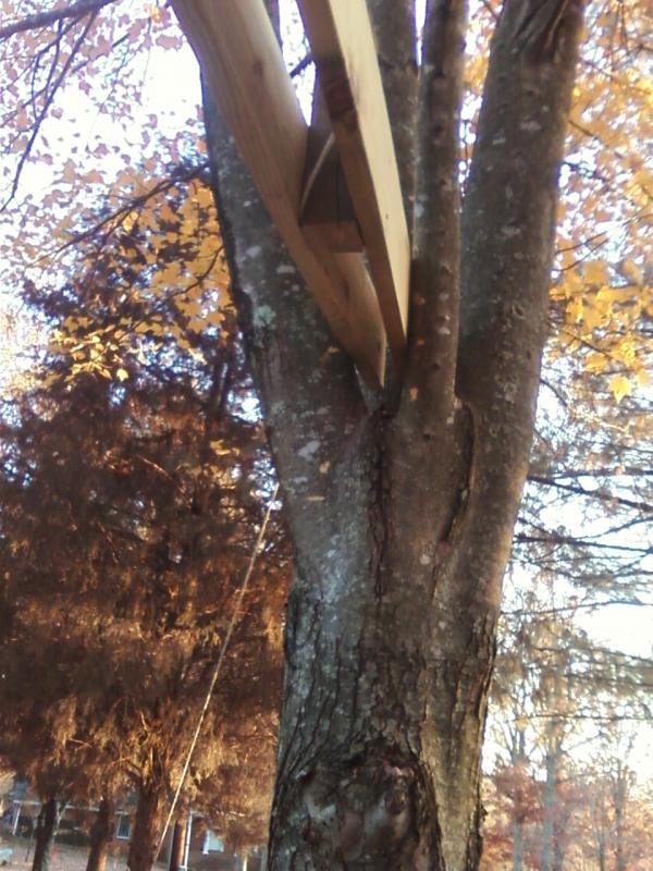

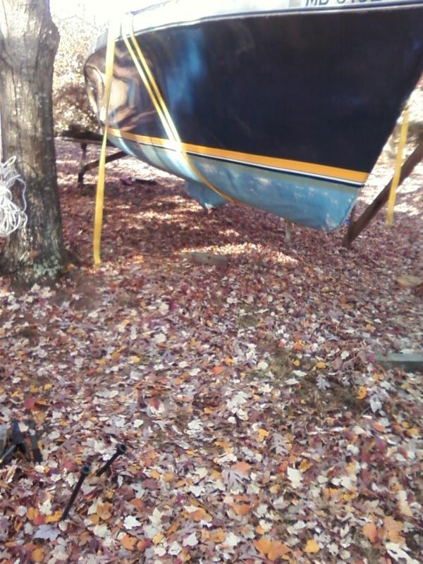

I lowered the tongue of the trailer as low as I could, then supported the stern on a picnic table (just because I had one I could use). I put a bunch of old life jackets that my kids had outgrown on the picnic table to conform to the hull at the stern, then I raised the tongue until the bow was a few inches higher than the stern and strapped the hull with tow straps to the cross beam. I then lowered the trailer and pulled the trailer out. I did not leave the boat hanging, I blocked the bow as well. Here is a pic (see below). I also included more pics of the support pole (you could easily build two of these. It is surprisingly solid. Just make sure to stake out the struts (see pic).

Thanks, that helps a lot. I think I may over estimate the surface area needed to support the hull. We get equipment shipped to us with the newer plastic styrofoam, looks like that may do just the trick. I wish we'd get bigger blocks of it as it would be a nice replacement for the older positive floatation stuff in the boat now. Not sure I'm up to all the cutting and pasting necessary to build replacement blocks.
