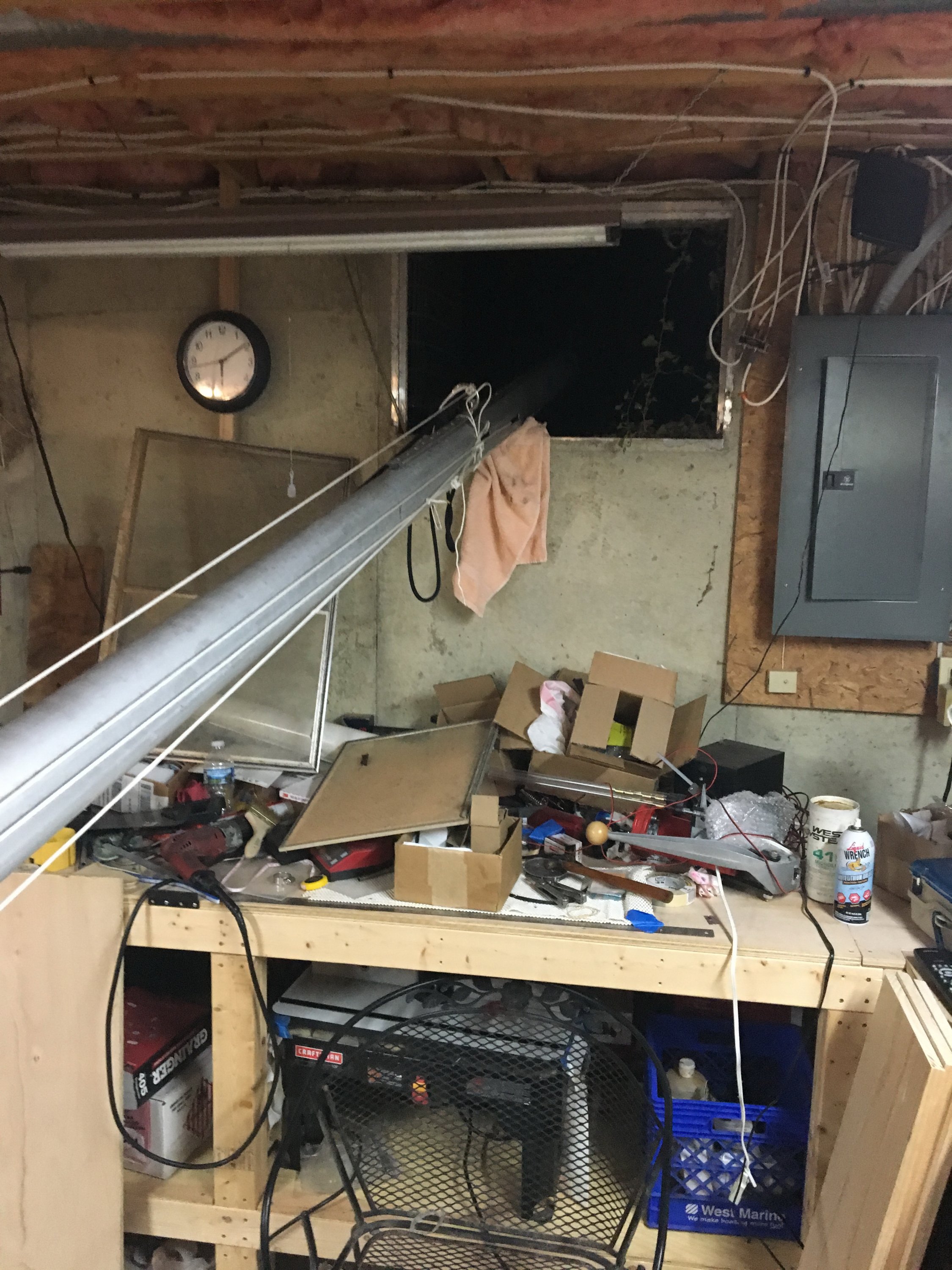

I hear what you're saying, I am trying to get my mast out of the basement so my wife can have her laundry room back...
but it was cold and wet this weekend as well here. But the good news is I am ready for warm temps so I hang the rig up, take measurements so I can order the new standing rigging package.

Not sure how one get's a mast into the basement - must not be a traditional basement!

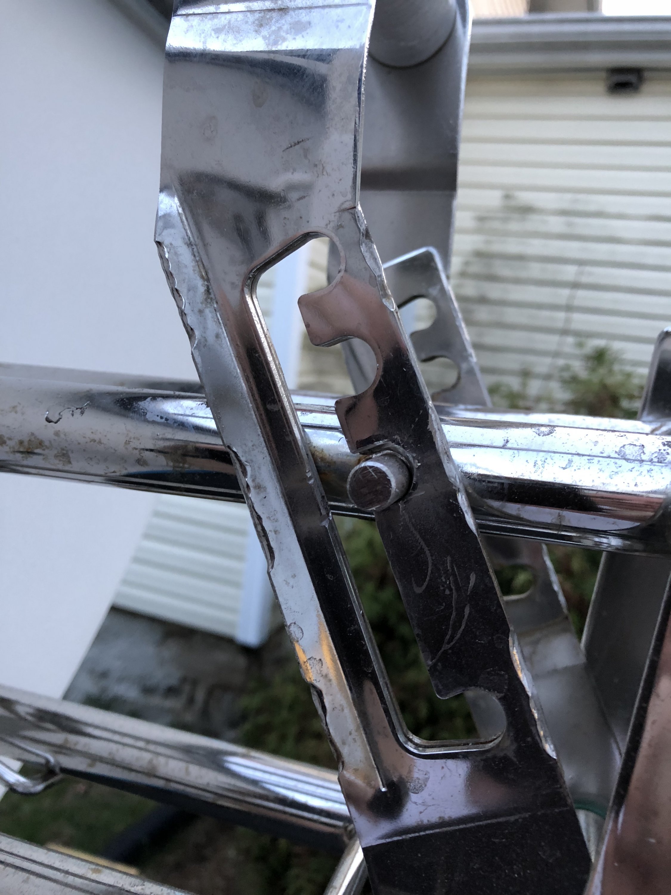

(N/A) Cut 2 new holes in outboard mount to have a better height for outboard. Drilling was a pain and I destroyed some pretty expensive drill bits.... Oh well......

Not sure why it would be hard on drill bits, I have good success using oil and low speeds start with small bits. Knowing the desired hole sizes I would used 3 steps up the largest bit

Drilling stainless steel using a low speed drill press and cutting fluid is pretty easy. Drilling stainless using a hand drill while the bracket is still attached to the boat is pretty hard. I found this out drilling a hole in the stem fitting on my old boat.

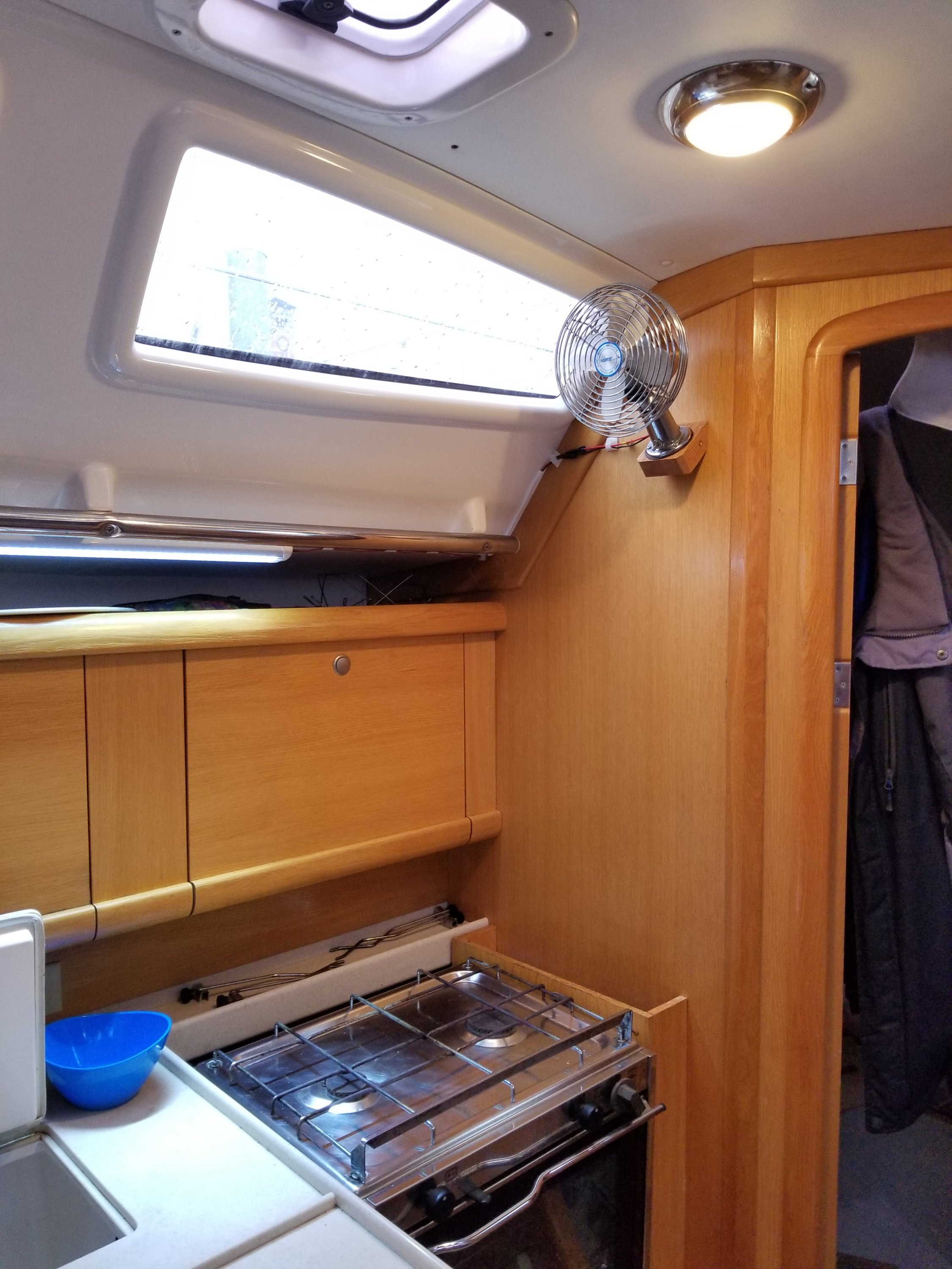

Nice bracket for the fan Gene.
Thanks. It was the first thing that came to mind. I should not have been in a hurry. It will be a while before it gets hot around here. Next, try to run the cable for the ram mike for the radio.
