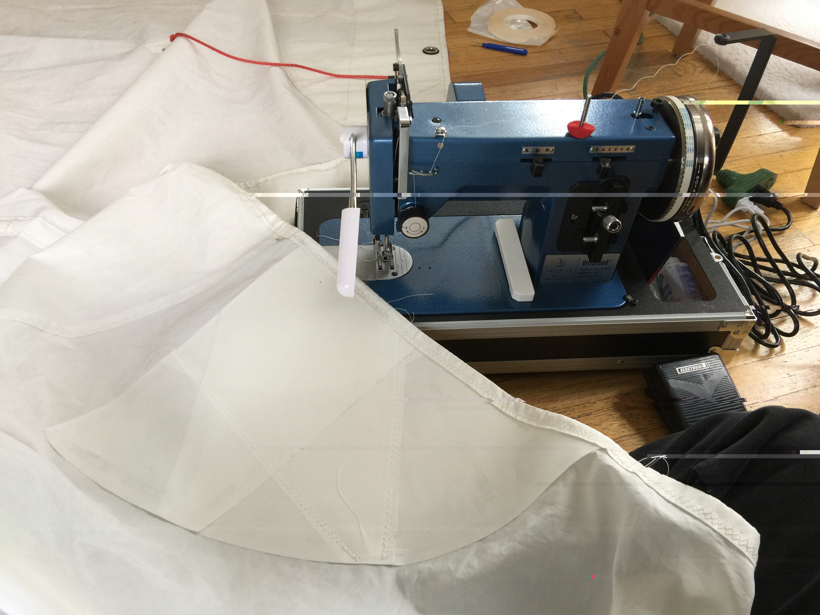

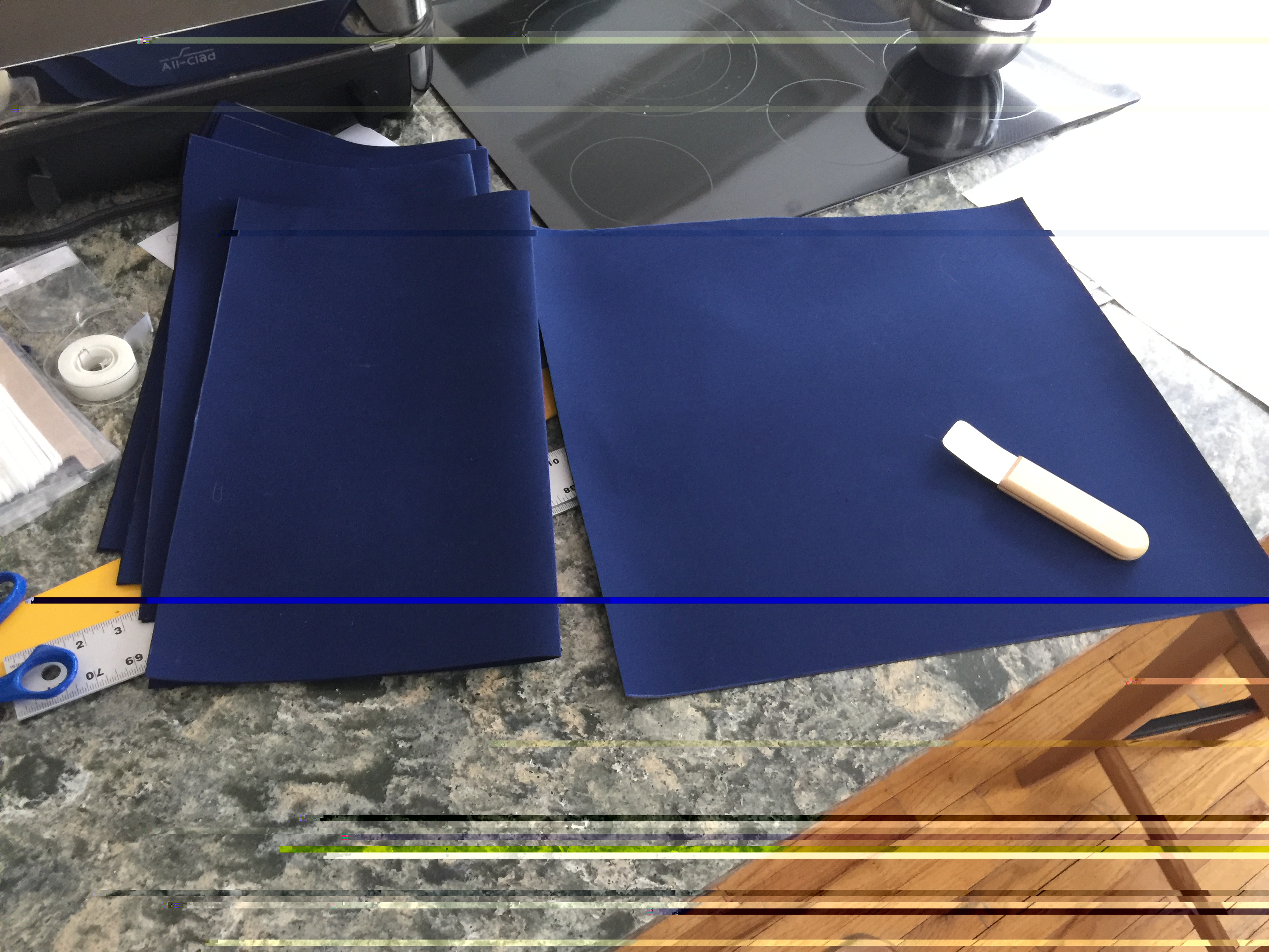

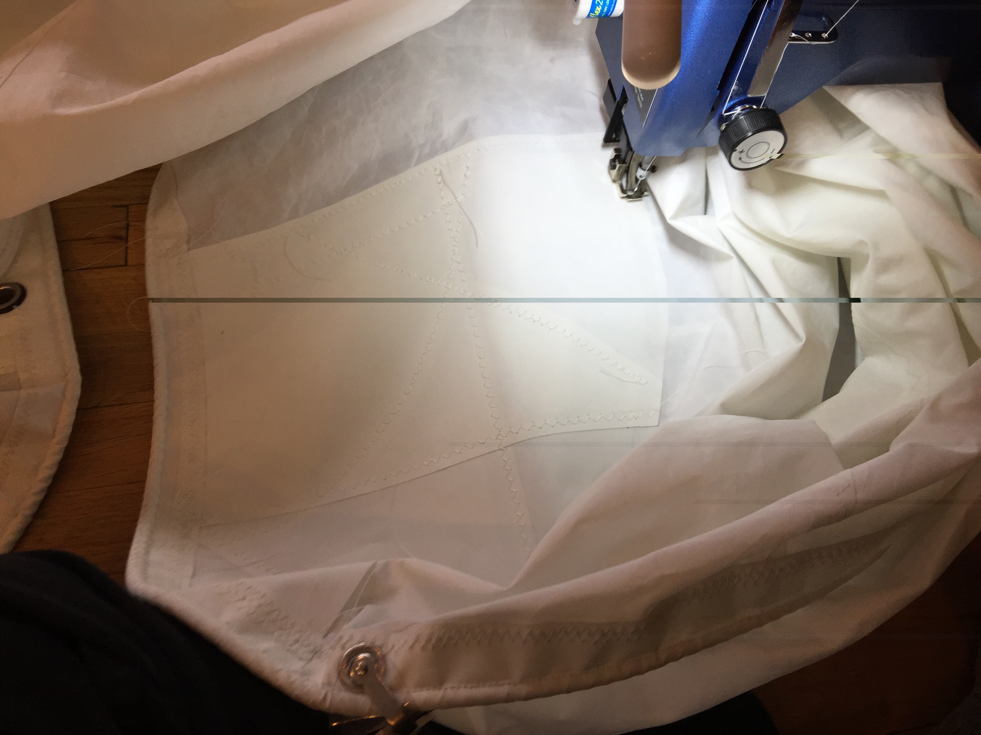

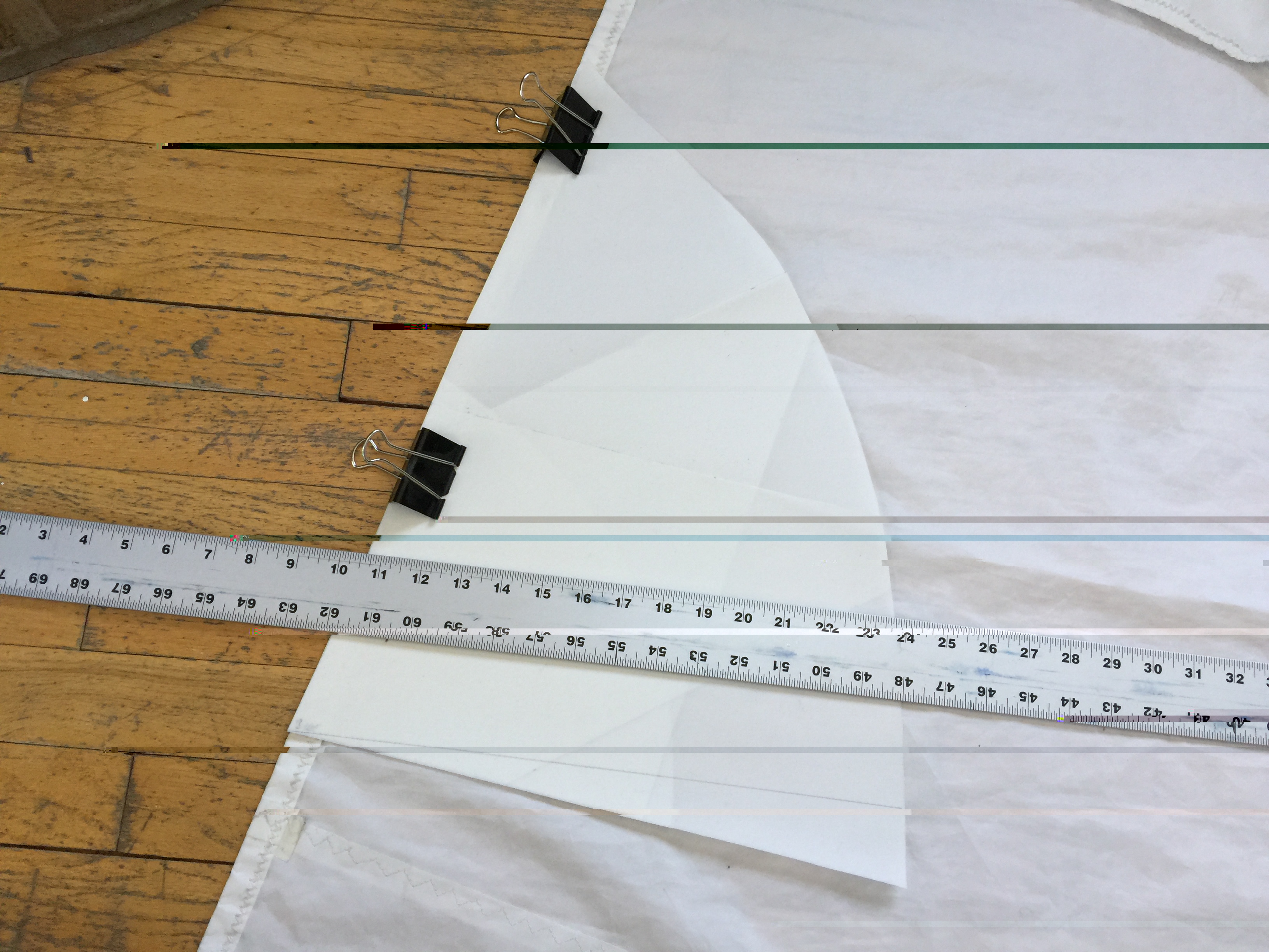

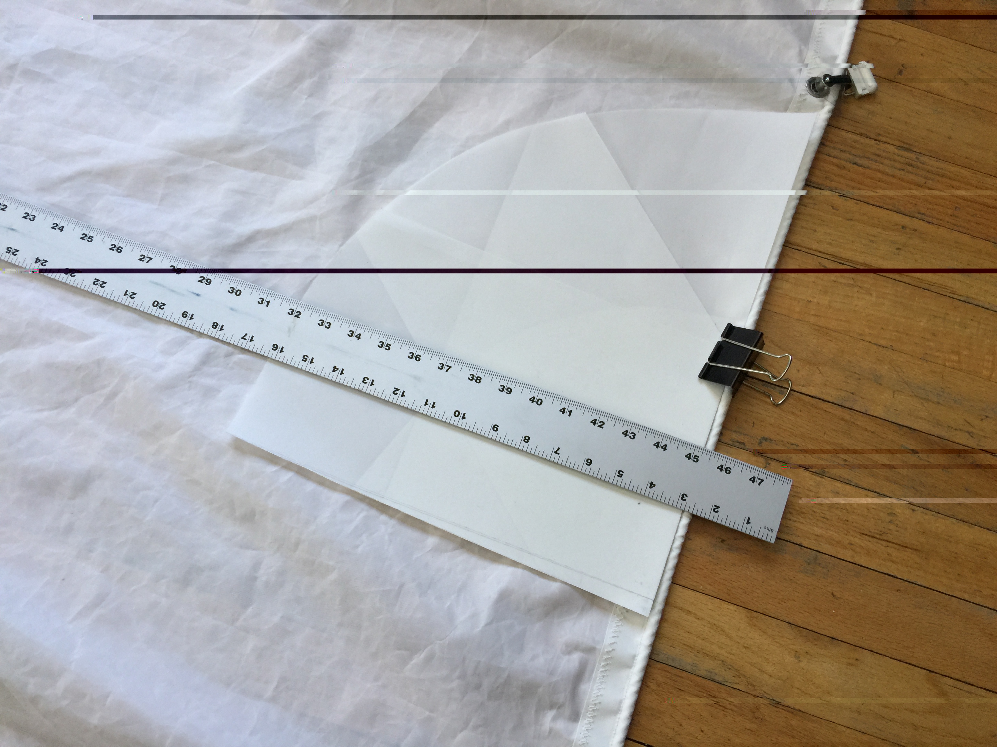

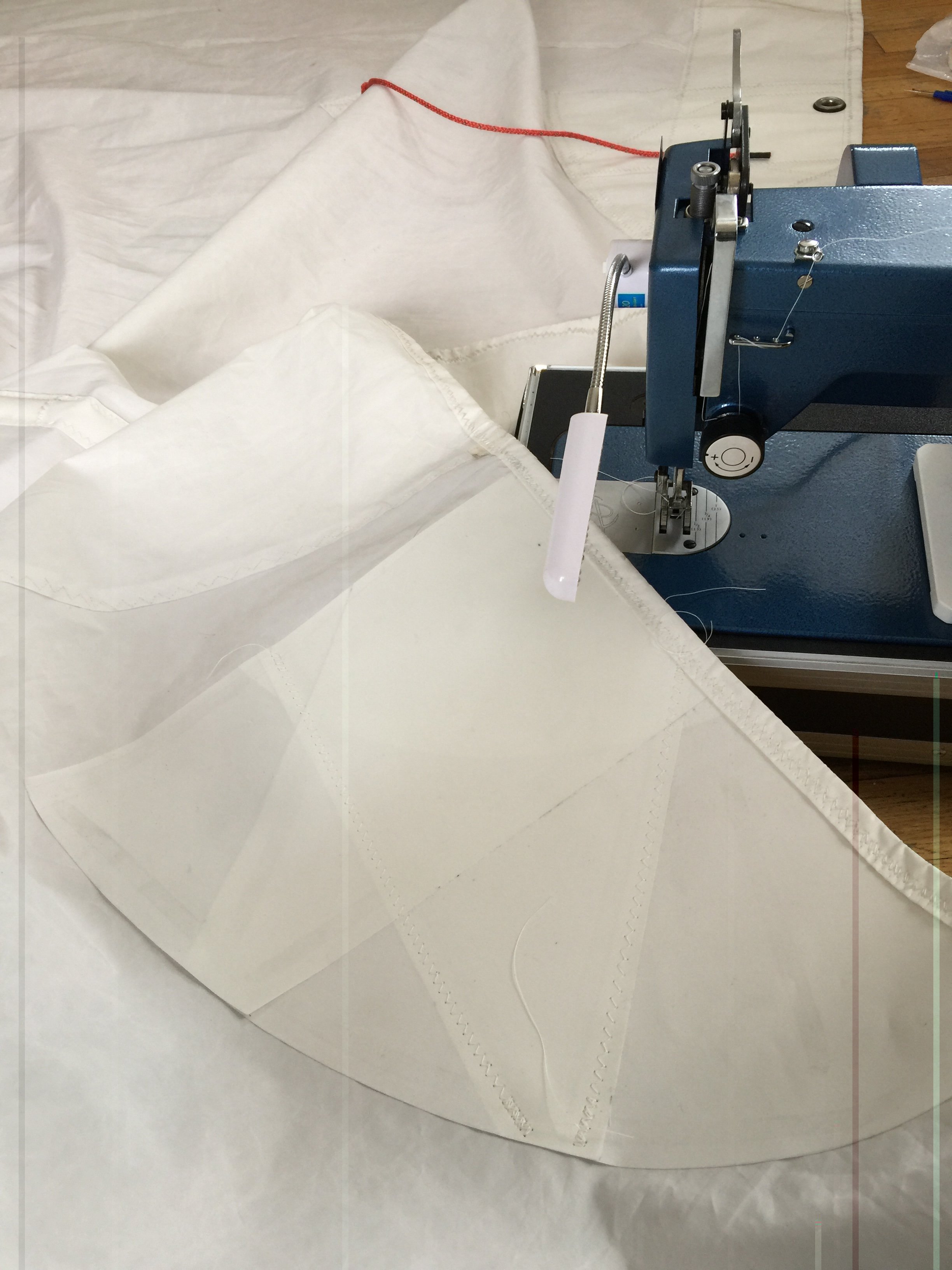

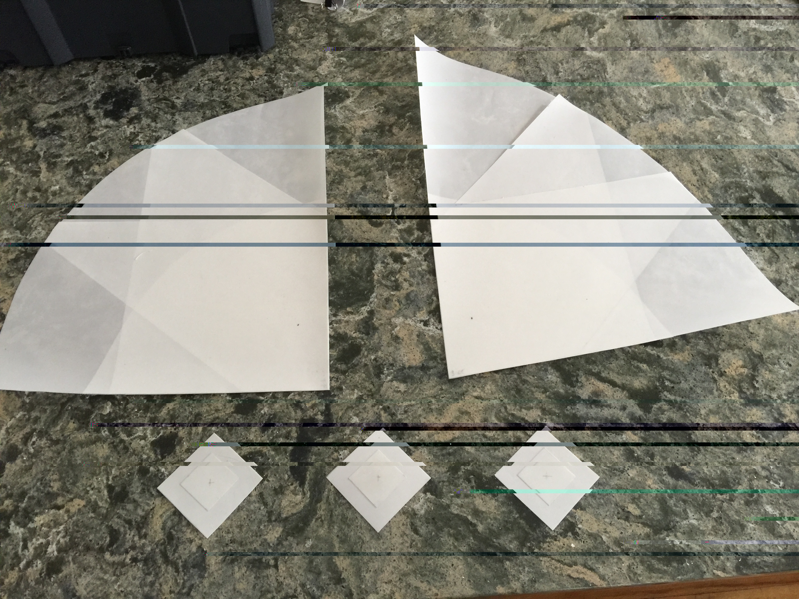

Cut out the pieces from 5.4oz Dacron for the leech and luff reefing patches and spray glued them together for easy sewing on main sail (hopefully tomorrow). Also 3 diamond shaped reefing line patches assembled...

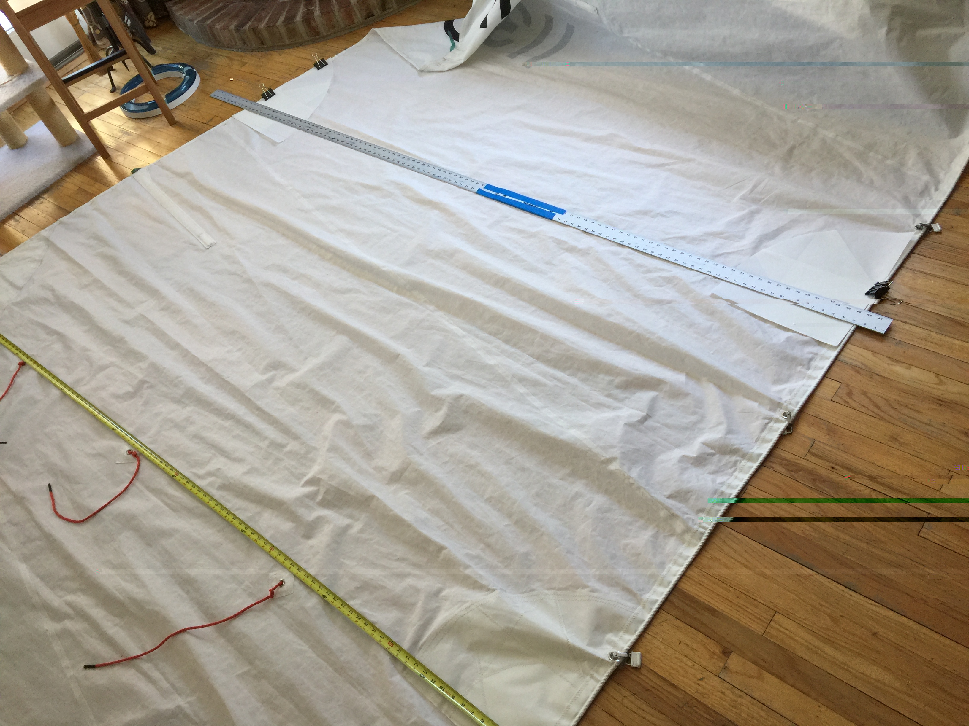

Now I just need to figure out where to place the second reef on the mainsail....?

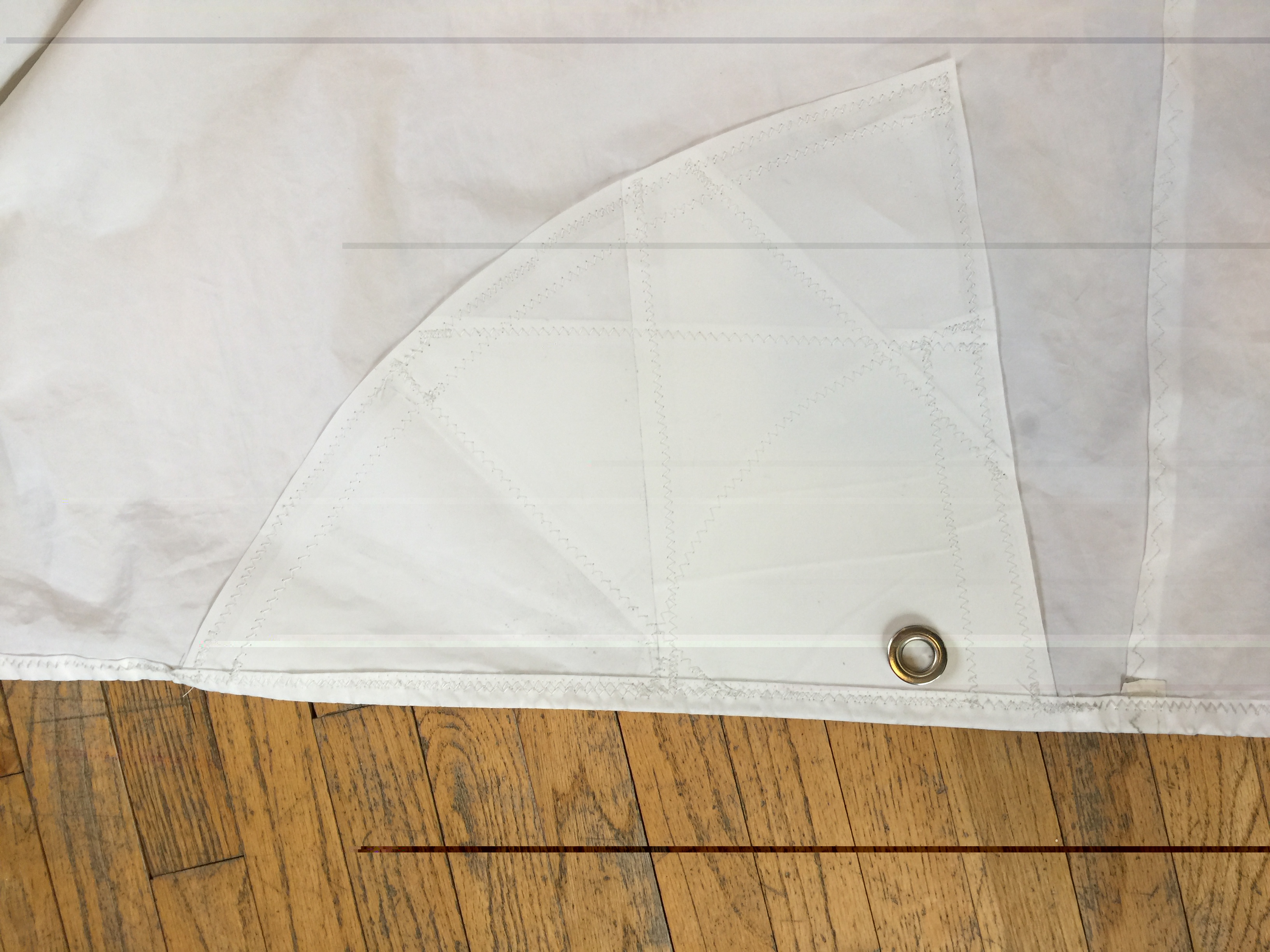

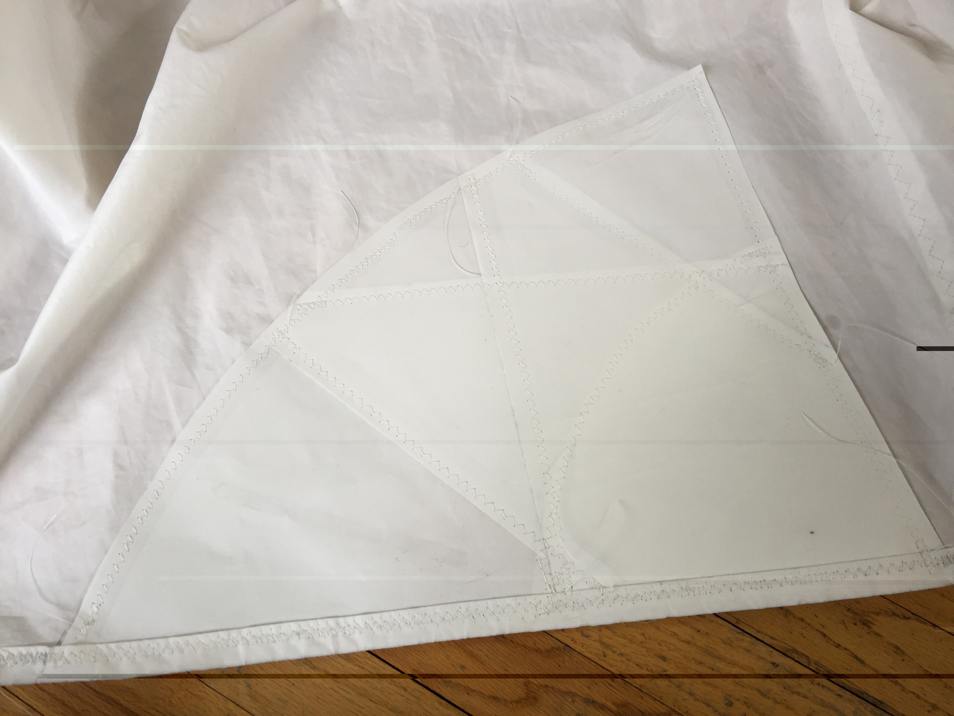

Did some online research and found a way to calculate the reduction in sail area depending on reef point location. Decided on a 45% reduction for second reef point which is ~ 7 feet up the luff for the tall rig main sail.... that way it does not interfere with a sail slug as I have to open up the seam for the seam tape to slide the patch underneath....
Need to trim the bottom of the patch so it is ~ level across the sail and with the foot of the sail....
Had to order #4 nickel spur grommets for the two main reef points. The in-sail reef points are #0 spur grommets. They are approximately 2" below the center line of the two main reef points....
For the three in-sail reef points I kept the outside distance from the luff and leech the same and equally split the distance for the inner one.
Hope this info helps....

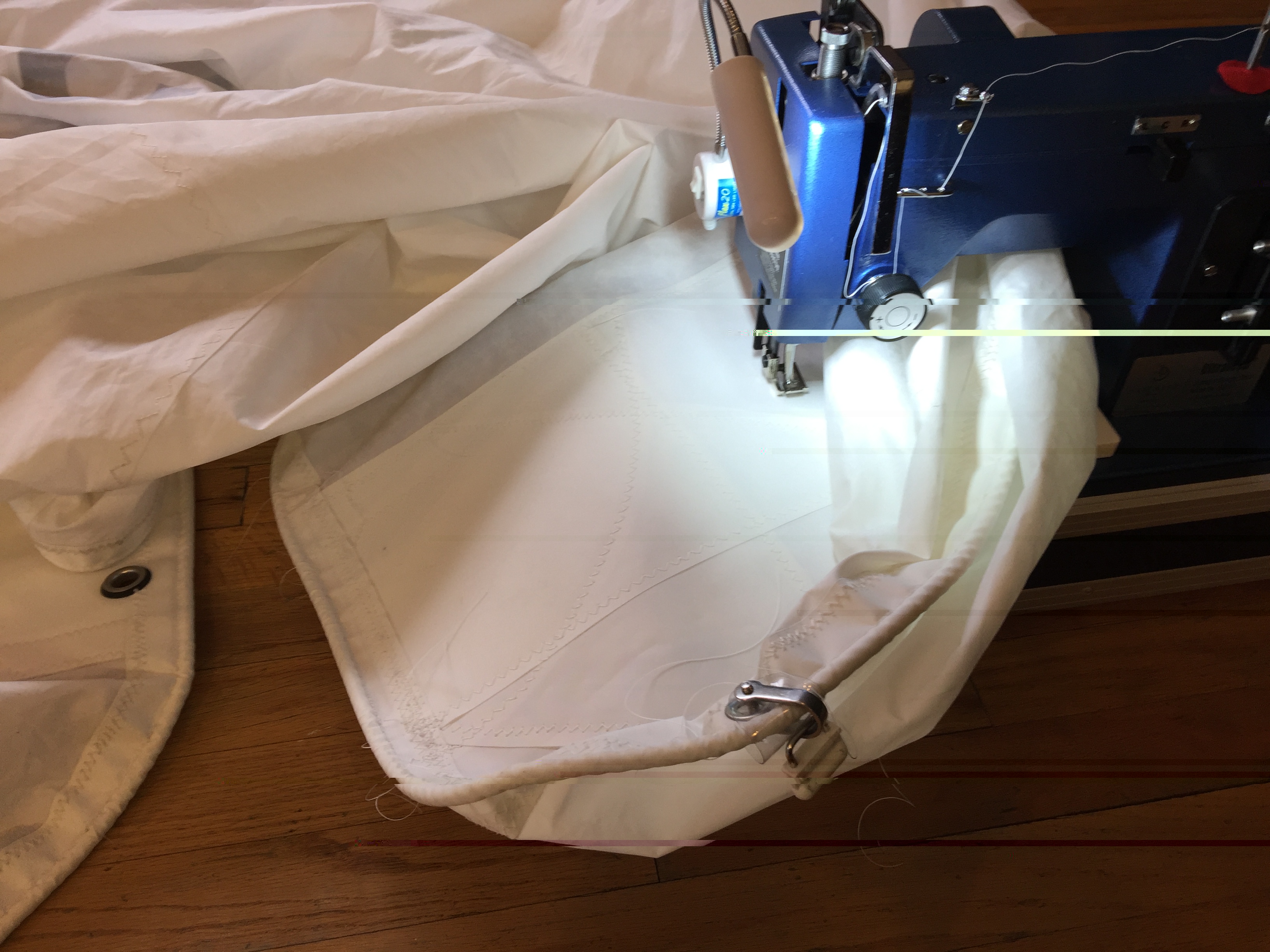

Slartibartfass,
I would like to express a bit of concern regarding the use of #4 grommet, it will not be strong enough.
The load will be equal or more to the existing clew ring. Sailmakers do not use spur grommets for anything that is loaded maybe for a dingy sail or something that under 110 sf.
I would also suggest that you a add couple of additional layers at the ring itself and use webbing to attach the ring see picture provided (Fig. 13). Best and strongest for at home DIY ring installs
Do you have any 2 sided seam tape. It would be good to pin out the sail tight tape down the reef point
and even staple it to keep it from moving and getting pleats.
One last thought open up the leach and tuck the reef in then resew it will be a lot stronger.
Dave

Dave thx for the info. My main sail must be the original sail that came with the boat and the existing reef point looks like a #4 grommet with a black backing between the grommet and the sail. No extra webbing strap sewn in. Will do some more research before I do any serious damage....

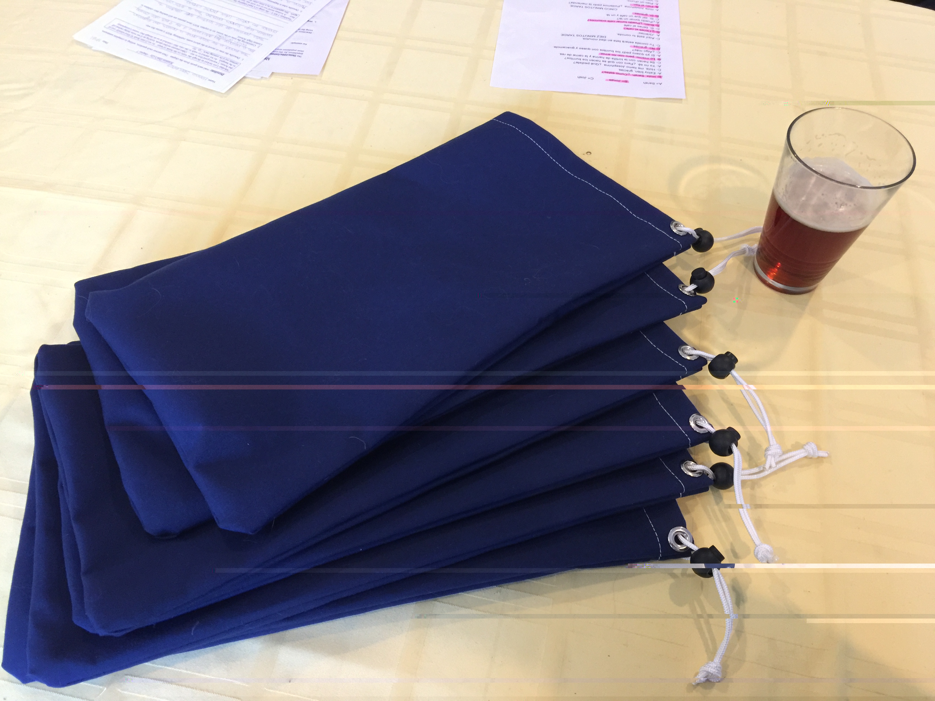

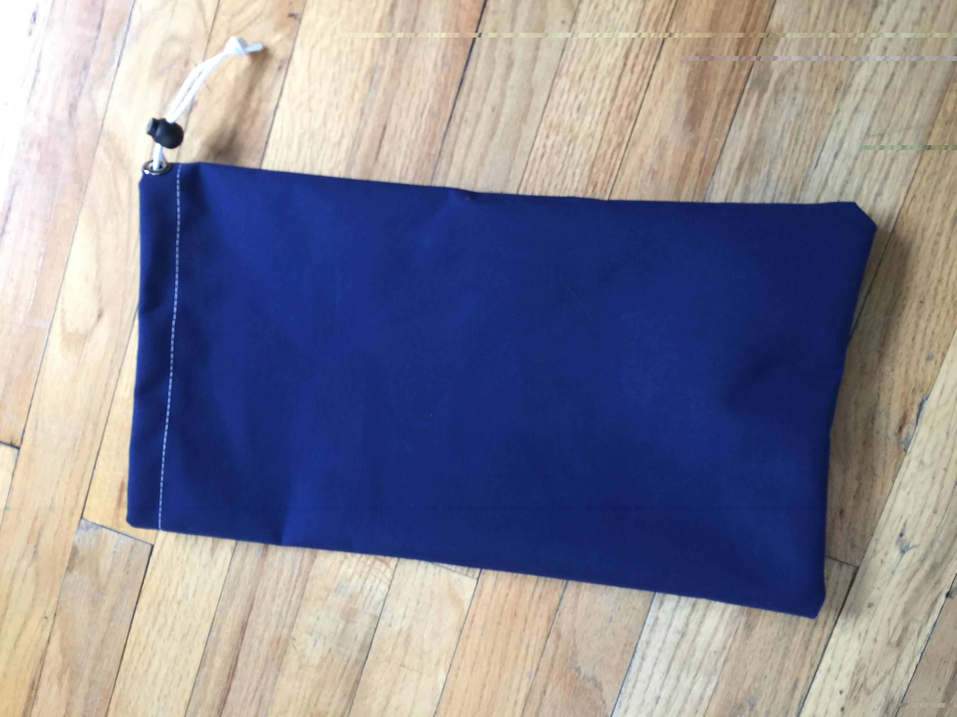

Decided to add the sail number to my sheet bags. iron on numbers....

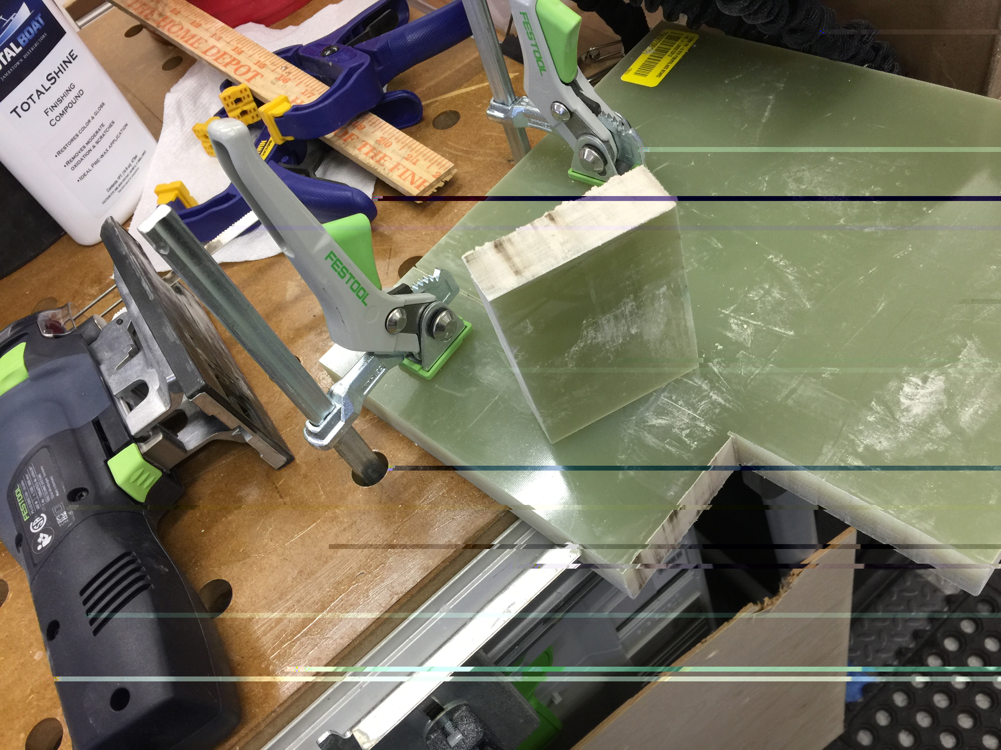

Cut 2 G10 3x4 inch 1" thick fiberglass board support blocks with my Festool Carvex and a metal cutting blade. Very slow cutting speed but got the job done.
Support blocks are needed for the thru hull hinge tube as the tube is sticking out 1-1/4 on both sides from the hull to give necessary clearance with the rubrail....
Will drill the 1" hole at correct angle after the tube is epoxied in....

Try using a carbide toothless jig saw blade it will cut vs. tear. You can see the blade is over heating.
