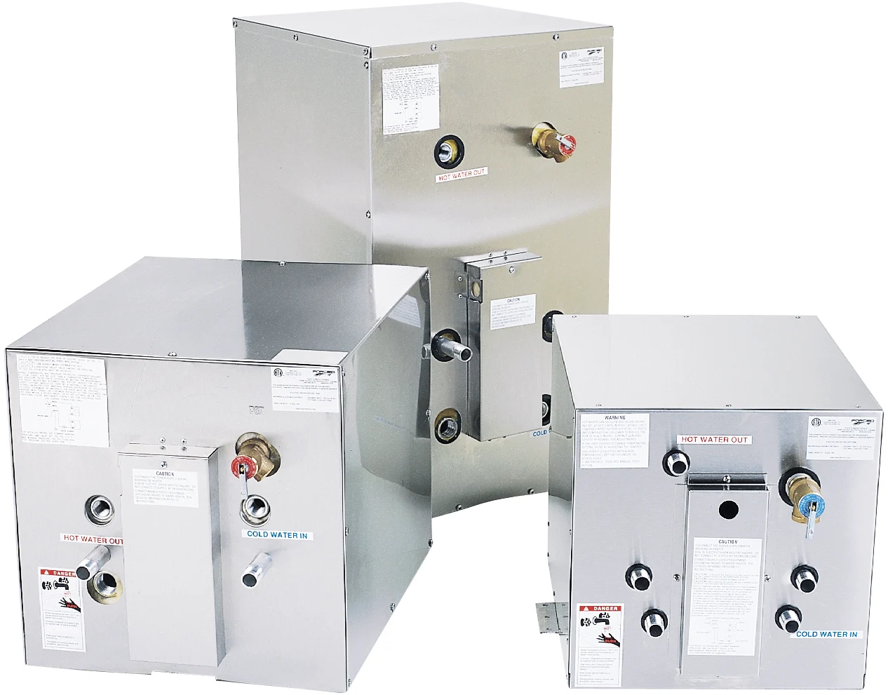

Most likely a 6 gal Kuuma water heater . You should have hoses from the engine also that hook up to it so it heats when engine is running. You can get them with heat exchanger with front or rear hookup, water hookup is on the front. On my boat heat exchanger from engine is rear hookup

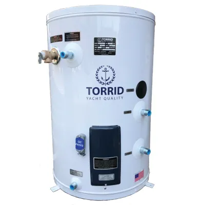

Torrid makes a 40GL unit MVS 40 2IX 2EL Explorer Series Marine Water Heater, Vertical 24V DC, 1500W & 3000W,
but it does require a 24V power system.

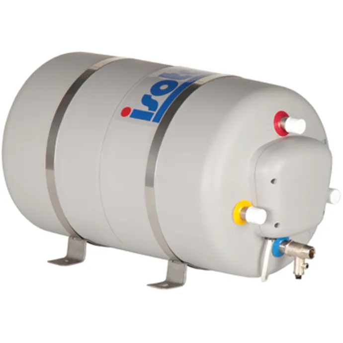

Isotherm as a great name. Available in a variety of sizes. Know to keep water hot long after the unit turns off due to good tank insulation
Isotemp Spa Water Heaters
Lots of options, prices, and sizes to fit the most discerning boat owner.

I replaced my 11 gallon OEM tank which I think was a seaward at 16 years old (still worked fine but rusty shell) and replaced with a 9 gallon Isotemp. Fantastic heater... plenty of water for 2 very hot showers and leftover..... Well insulated and great heat exchanger. I replaced all hoses at the same time as well.
