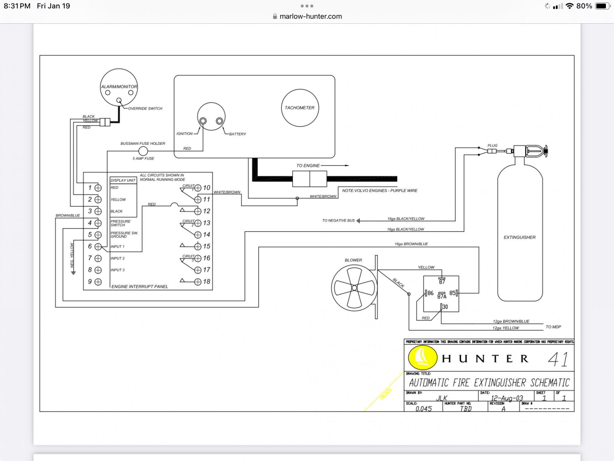

I’m not sure if this will help you but from my owners manual here is a schematic of the fire suppression system that is installed on my boat.
I guess the key would lie in where that white/brown wire leads (purple if a Volvo engine).
It doesn't look to me like there is any interruption at the ignition switch.
Doing some additional searching for information to help you. Found this in more of my manuals. Not certain but it sounds like if the suppression system discharges it disables the exhaust blower and stops the engine. The engine on my boat does not have a pull lever engine stop. It has a stop button at the panel so would it make sense that the suppression system is tied into the same circuit that is used to stop the engine?

If your engine has an electric stop button, it would be a simple matter for your fire suppression system to be connected to it thus preventing the engine from firing but letting the starter spin, much like what Scott T said while trying to start with the engine stop cable pulled all the way out. The question still remains though as to why it would do that while on the hard and not while in the water?
perhaps a short as OP questioned. Or perhaps the gas pressure in the suppression system is marginal and in the cooler fall weather it’s registering too low thereby triggering a no start condition.
