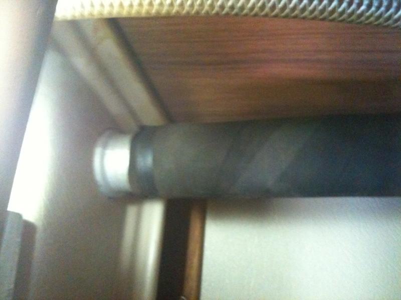

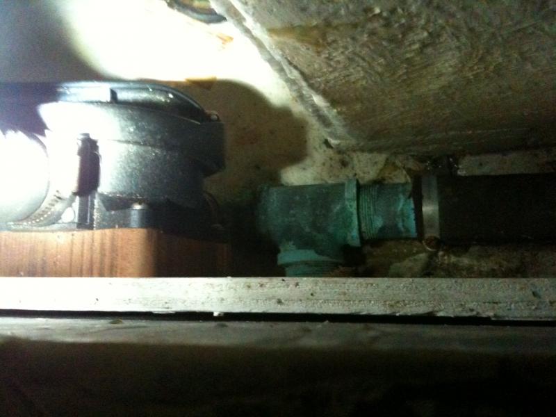

New (to us) 1982 Catalina 27. Waste tank appears to be original Ronco B117. Tank outlet is 1-1/2" metal pipe (with nice green sheen to it), to a metal 1-1/2" tee; one side goes to a pipe elbow reducer, and then to 1.5" ID Shield Exhaust tubing to a manual diaphram pump and finally to a thru hull.
The other leg of the tee connects to 1-7/8" ID Shield Exhaust tubing to a 1-7/8" barbed deck pump out fitting. I have measured several times, and the fitting and tubing are definitely 1-7/8", not 1-1/2".

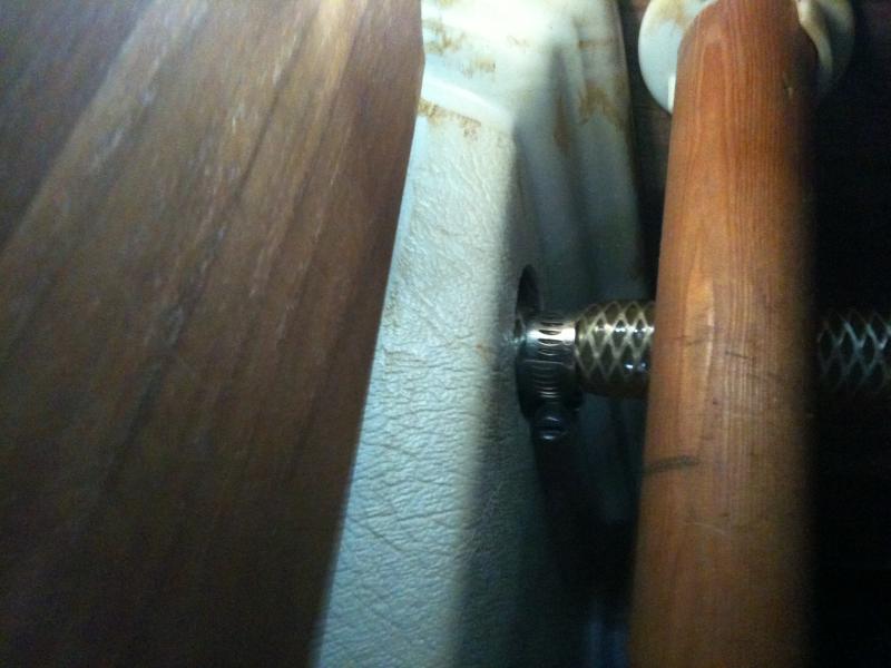

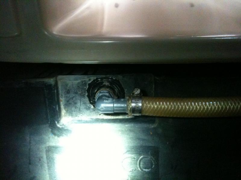

The vent fitting is a 3/4" MPT to 3/4" barb, with 3/4" ID braided Tygon (PVC) tubing connected to a 1/2" barbed deck vent fitting.

That make a lot of sense. So the deck fitting is for 1-1/2" pipe, rather than hose? I sure couldn't find any deck waste fittings for 1-7/8" hose.
That would be my guess, but from your picture it doesn't actually look like a pipe nipple on the end of that deck plate, but hard to tell. I too have never seen a deck waste fitting MADE for 1-7/8" hose - Heck, not sure that I have ever seen any fitting actually made for 1-7/8" hose....

I’d stick with the ¾ “ line, the 5/8” line will be more prone to clogging. The Trident 101 hoses are an excellent choice. However, it looks like the vent hose clamp at the tank fitting is not clamped to the fitting. On the right-hand side of the clamp the hose clearly crimped, and it looks like the same is true on the left-hand side. My guess is that a barbed fitting alone is just too short to easily connect the hose clamp.
Side vented tanks have a basic problem, especially on sailboats. If the tank is near full, any motion or heeling will most likely dump waste into the vent hose, potentially clogging it. You want to have the vent line moving upward as quickly and as continuously as possible so that if this happens the waste will quickly drain out. It appears that your current vent line heads downward for some length. You could use a nipple fitting with a female/female 90 or 45 elbow and add a male barbed fitting to get the vent hose moving upward quickly. The nipple extender will provide better access than a barbed fitting alone.
2. I’m a little confused by your statements and the pictures. Picture one seems the output side of the tank having a PVC barbed fitting with a 1½” hose attached, but you state that tank outlet fitting is a metal pipe. You state that you want to use a 1 ½” barbed elbow coming out of the outlet side of the tank, I’m assuming the hand pump above the tank. While this approach would be excellent, I see a potential problem using a male threaded/barbed elbow. The picture suggests that the wood paneled bulkhead and the floor are too close to the outlet to allow a barbed fitting to spin into the tank. If that’s the case, use the same configuration as the vent hose (nipple to female/female 90 or 45 elbow to a male thread/barbed fitting). The elbow is considerably more compact than the barbed elbow.

Sorry for the confusion. I should have labelled and oriented the pictures. The first picture is actually the pump out fitting under the deck, showing the 1 7/8" ID waste hose (I removed the clamp). The second picture is the vent fitting at the deck, showing the 3/4" ID Tygon clamped on the 1/2" fitting. Third is the vent fitting at the top of the tank. Fourth is looking down at the side of the tank, showing the outlet and hand pump.

I found some old plumbing schematics from Catalina for the 27 that showed 1 7/8" ID waste tubing going to the deck fitting, so I'm thinking the fitting was originally installed by Catalina in 1982. That may explain why it won't open!

Someone on the Yahoo Catalina 30 forum posted this idea for an adapter to use between the 1-7/8" deck fitting and new 1-1/2" waste tubing:
An easy way to go from the 1-7/8" deck tailpiece to a new 1-1/2" sanitation
hose, is to use a Fernco adapter and pipe fittings - all commonly available and cheap.
(From top to bottom.....)
(OEM) 1-7/8" tailpiece
1-1/2 x 1-1/4" Fernco adapter **
1-1/2 x 1-1/2 insert coupler ***
(new) 1-1/2" hose
** Fernco part # 1056-150/125. (The IDs fit the 1-7/8" tailpiece and an 1-1/2" fitting.)
*** 1-1/2 x 1-1/2 coupler - either the typical gray PVC barbed coupler for
1-1/2" black poly pipe (grind down the barbs so the hose slips on easier), or a Marine East coupler (similar to what Chet posted.) Or easier yet, an 1-1/4" copper sweat coupling will slip inside the 1-1/2" hose and the Fernco, and has a thin wall so flow is not affected.
It might be helpful to put a clamp around the new hose where it exits the hole in the liner in the pushpit/pulpit/lazarette/sail locker -- so that the new
hose is supported and doesn't pull on the deck fitting and couplers.
