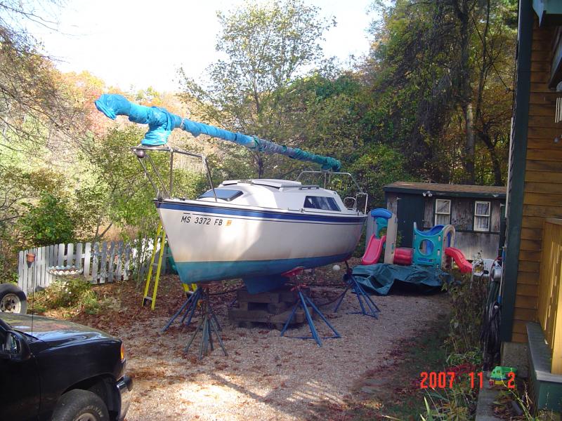

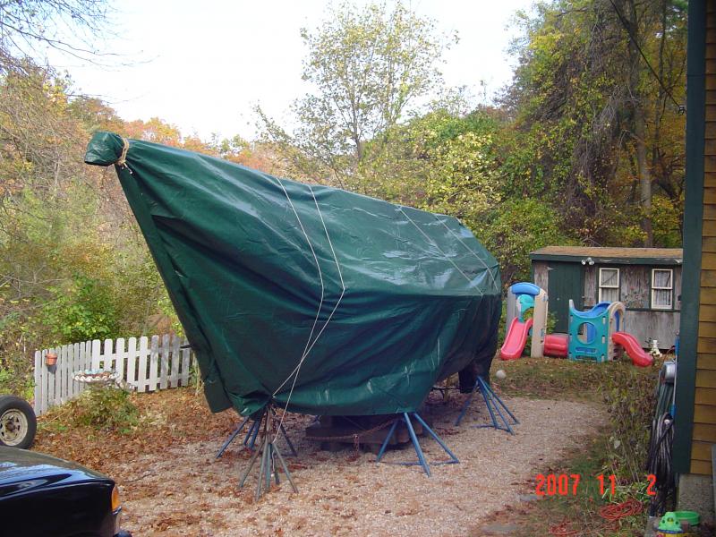

I use my mast for a ridge pole to tie my tarp to at the end of the season. I use long lengths of two foot wide tarp to wrap the mast after I have stripped the mast of the spreaders and standing rigging. This prevents chafe to my 18'X30' polytarp. I roll up my standing rigging and my lifelines and stanchions and store them inside for the winter.
Which is why Joe's boat is in such great shape. I abuse the heck out of mine - but it keeps on sailing.
