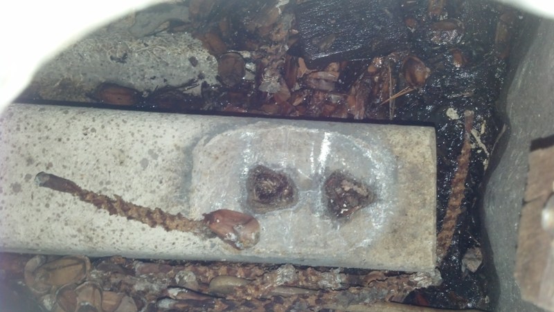

Last summer I looked the boat over, assembling everything as if I was going into the water. When I attempted to step the mast, I found the metal mast step was actually missing. It looks as though the two bolts holding the mast step part failed. I do see a small block of wood next to the step; could this be a part of the assembly? See attached photo.

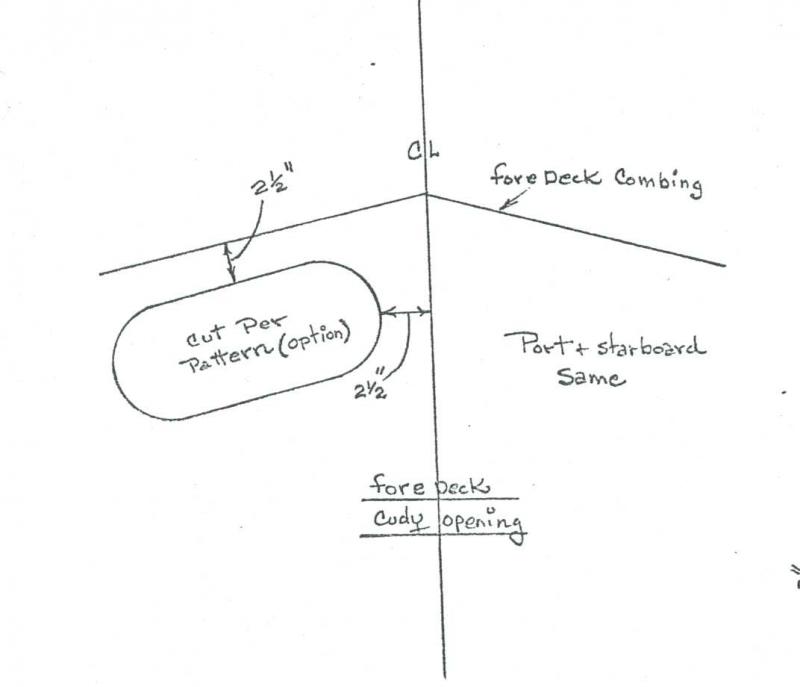

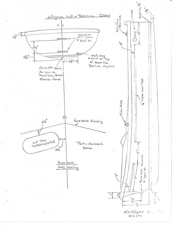

My plan is to cut a a new utility hole (8" or 12") and add a cover to it in order to access the area around the step. This model boat does not have access panels factory installed. Do I need any other parts besides the $15 mast step replacement part? Do you have any other suggestions? Thanks in advance for all your help.

I'd take this opportunity to cut out the factory-style access ports to allow using the under deck area for stowage and to access the mast step location.
I don't know exactly how O'DAY fastened the mast step to that box-beam that it was mounted to, I never had reason to remove the mast step on my old Widgeon. I do know that on my Day Sailer II the mast step was held in place by 2 sheet-metal screws into a plywood block under the cuddy deck. I'd try drilling out those screws or trying to punch them through the top of that box-beam. They might move.... or maybe not. You could cut off the top of the beam around the location of the step and insert an epoxy saturated block of hard wood, then drill for 2 new screws. You definitely want to keep the step located as close as possible to the original spot to keep the mast positioned correctly.
I don't think that small block of wood is related to the mast step, it may have fallen off somewhere else below deck or just be a scrap left behind at the factory.
