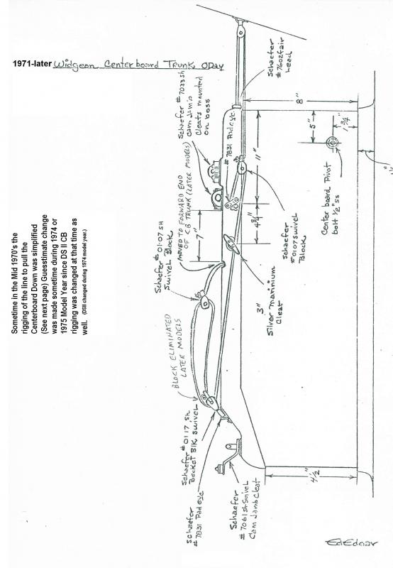

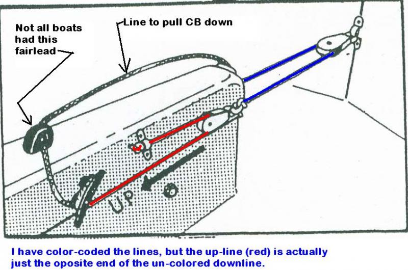

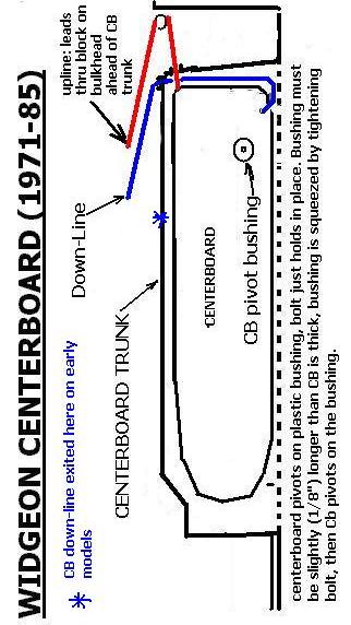

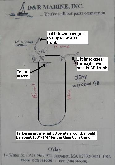

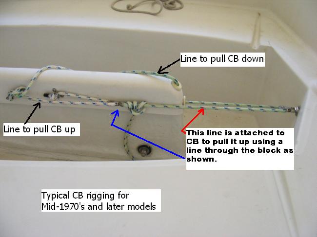

Having read some of the forum items concerning widgeons, I'm concerned about my boat. I just purchased a widgeon. I've only had experience with dagger boards. I haven't had the boat in the water yet due to low lake levels at Tahoe. In the forum responses, I've seen comments concerning a centerboard operating handle. There is no such thing on my boat, just some lines and pulleys through a hole in the top of the well. The boat is on a trailer so I can't operate it yet. I am installing some rope hoists in the garage to lift the boat off the trailer and let me get under it. Any suggestions to this matter are appreciated.

The lever-operated centerboard is on the 1963-70 models (and 1990 and newer), if your boat has the line-operated Cb that means she is a 1971-89 model. The 1971-83 models have a forward deck and molded-in side seats, the 1984 and later have no forward deck, but the molded-in seats extend forward of the mast forming a sort-of "sunken" foredeck.
I'll add a diagram and a few pics showing the CB rigging for your boat, the exact setup changed slightly over the years, but it it will give you an idea. These diagrams are from my Expanded Widgeon Manual.

Many, many thanks Sunbird. The diagrams came through clear and printable. I need to get out to storage and see how they match up. I may not need to lift the boat off the trailer after all. Mine does have the molded in side seats. Comments I've read in the forum pages indicate the boat will not point higher than about 45 degrees. That true? Anyway, I had a Hobie One. Had to sell as I don't scramble as well as I used to. Looking forward to something more sedate such as the Widgeon. The only other issue is stepping the mast. I have managed it one time when I bought it to see that I could handle it alone. I got it standing straight up and in the step but it was precarious.
