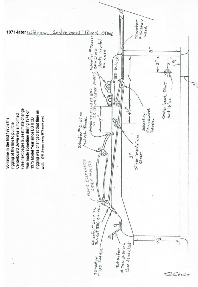

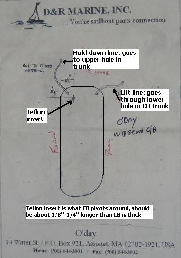

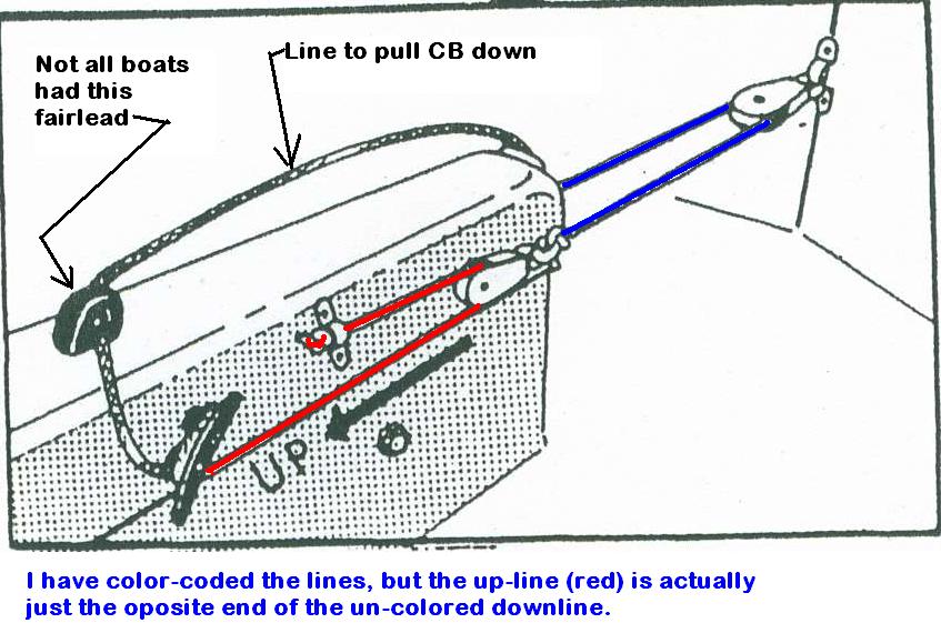

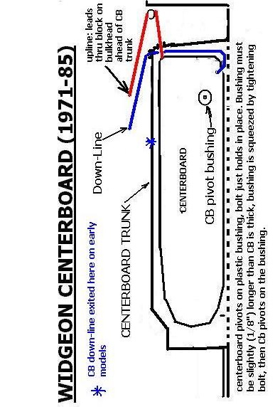

Widgeon CB diagrams from my Expanded Widgeon Manual. I have talked with several Widgeon Owners that discovered that the control lines were misled by a previous owner, on one bot pulling the line to lower the CB was trying to lower an raise at same time!

These diagrams are very helpful thank you. Going off the first one posted.... the blue line (down line) in the diagram is there but it doesn’t move much nor does it do much.
The red line (upline) isn’t there. There’s a hole for it just no rope. Probably a pretty stupid question but I’m assuming this is the line to pull the centerboard up correct?
So if I just undo the bolt holding it in and take the centerboard out can I just replace the lines?
Edit: never mind I understand what both lines are for after looking at the diagram again
