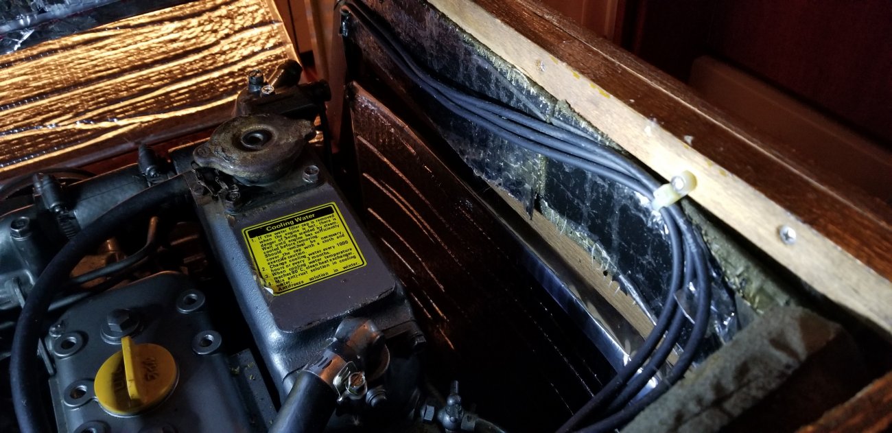

Did a search on sound proofing but only found lots of discussion on type of materials. Really wondering where the panels can be placed.

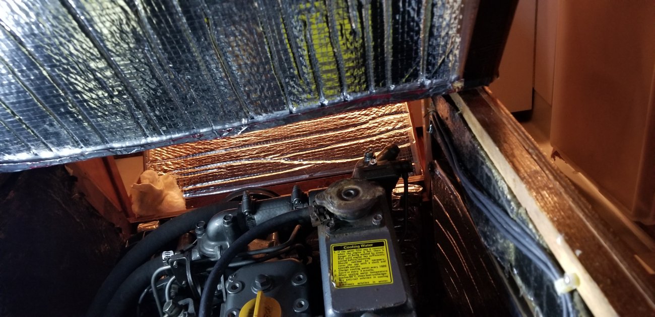

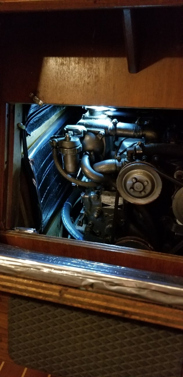

Front, no problem, engine access hatch under companion way ladder.
Starboard side, also easy, line the quarter berth access panel.
Port side, more complicated as area is completely open to locker. Add material to cockpit locker seat and side or close off the open area?
Cockpit floor, likely will be the most important but currently has a bunch of hoses and wires covering it. Maybe could use some spacer blocks to save rerouting all that.
Aft, leave open for combustion air and cooling ventilation or try to seal? The area has the propshaft and engine cables do it would be hard to really seal and not sure would make much difference.
I am concerned about providing adequate ventilation without defeating the sound proofing. Would love to hear from all those who have done this on an O'day.
