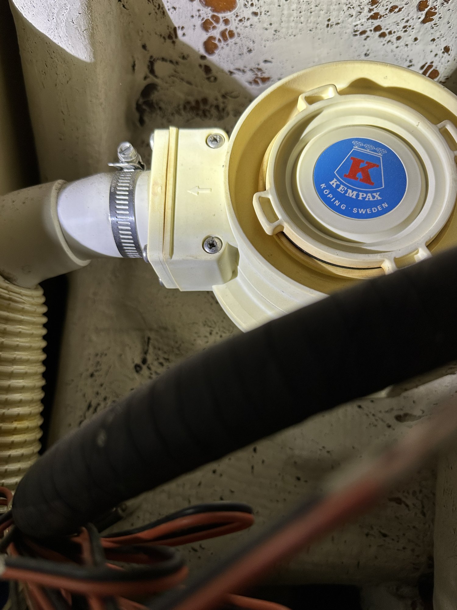

Searching for a Kempax repair solution - only the rubber boot is still available on www.PumpVendor.com, though you can still order the whole pump (Johnson 70-50005 Viking Hand Pump). Viking Johnson 70-50005 info here.

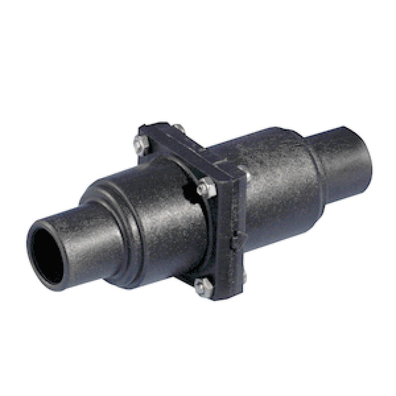

My troubleshooting identified poor exit (flap) valve seal (so inadequate vacuum to prime). Disassembled, cleaned, lubricated, reassembled - still doesn't seal well enough to pump, but draws suction well if the exit port is occluded.
The Viking Johnson catalog shows a new "universal" manual bilge pump with similar performance metrics, but with a different through deck bolt pattern/opening from the older 70-50005, AND with one significant improvement - the exit valve is a tricuspid design, not a flap.
Whale Pumps makes a 1-1/2 inch back flow preventer with a tricuspid valve

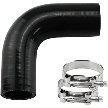

that fits the 1-1/2 inch ID Shields 140 hose cuff and attached with a 90 degree silicone elbow
from Amazon to the pump outflow port, the vintage Kempax pumps like a champ!
The elbow serves 2 purposes - one, it's darn hard to find 1-1/2 inch ID hose/tubing to connect the Whale back flow preventer to the pump outflow port and two, the starboard propane locker creates a tight turn coming out of the outflow port, kinking the Shields hose. (I accessed my pump by removing the plywood panel at the end of the starboard quarter berth)
I'll cut off the 1 inch diameter adapter sections of the back flow preventer and shorten one straight arm of the elbow to 1.25 inches (the length of the outflow port) and it should fit back in like a charm!
