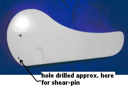

My DS II has the same rudder as your Javelin (assuming yours is original?) and it does tend to kick-up slightly as I sail. I haven't found a solution yet, but am thinking about drilling a hole through the rudder near the forward, lower edge of the upper section, and inserting a thin wooden dowel that would hold hte rudder blade down but easily break if I sailed into shallow water and the rudder hit bottom (sort of a shear-pin design). Mine only kicks up a few degrees by itself, but enough to affect the feel of the steering.
