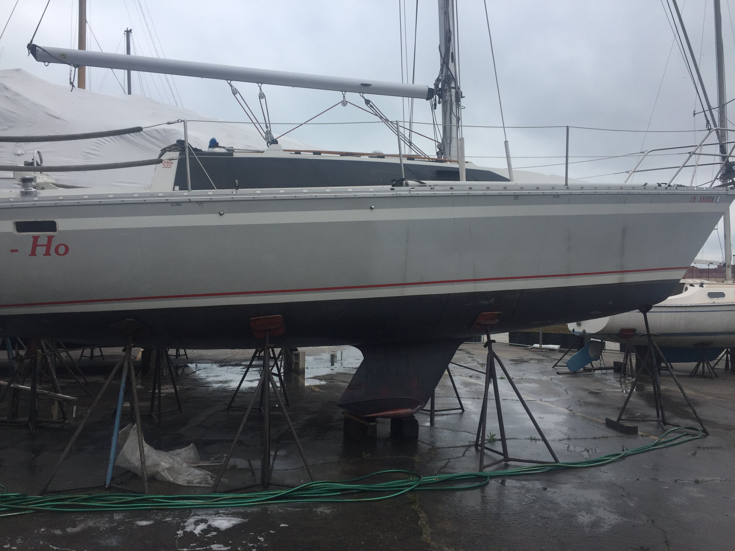

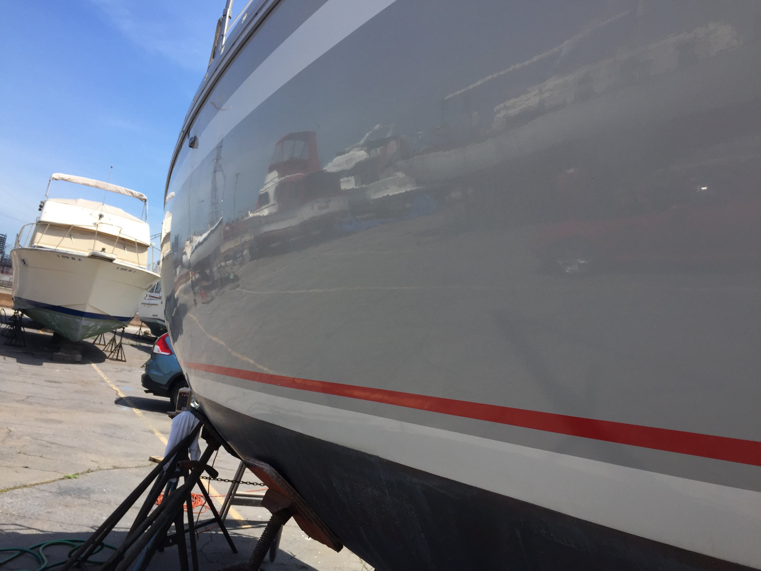

I did not go to the extremes in MS's excellent article about achieving the perfect shine (I am not that anal about my hull), but I did buff it out with a cutting compound on a wool pad. I do not think we will get an intermediate polish on it, but will get her waxed this week so we can launch next weekend.
In the first photo, I was about halfway done on the starboard side...I assume you can tell which part was done! Next shot was with the side polished, but still needs to be waxed.

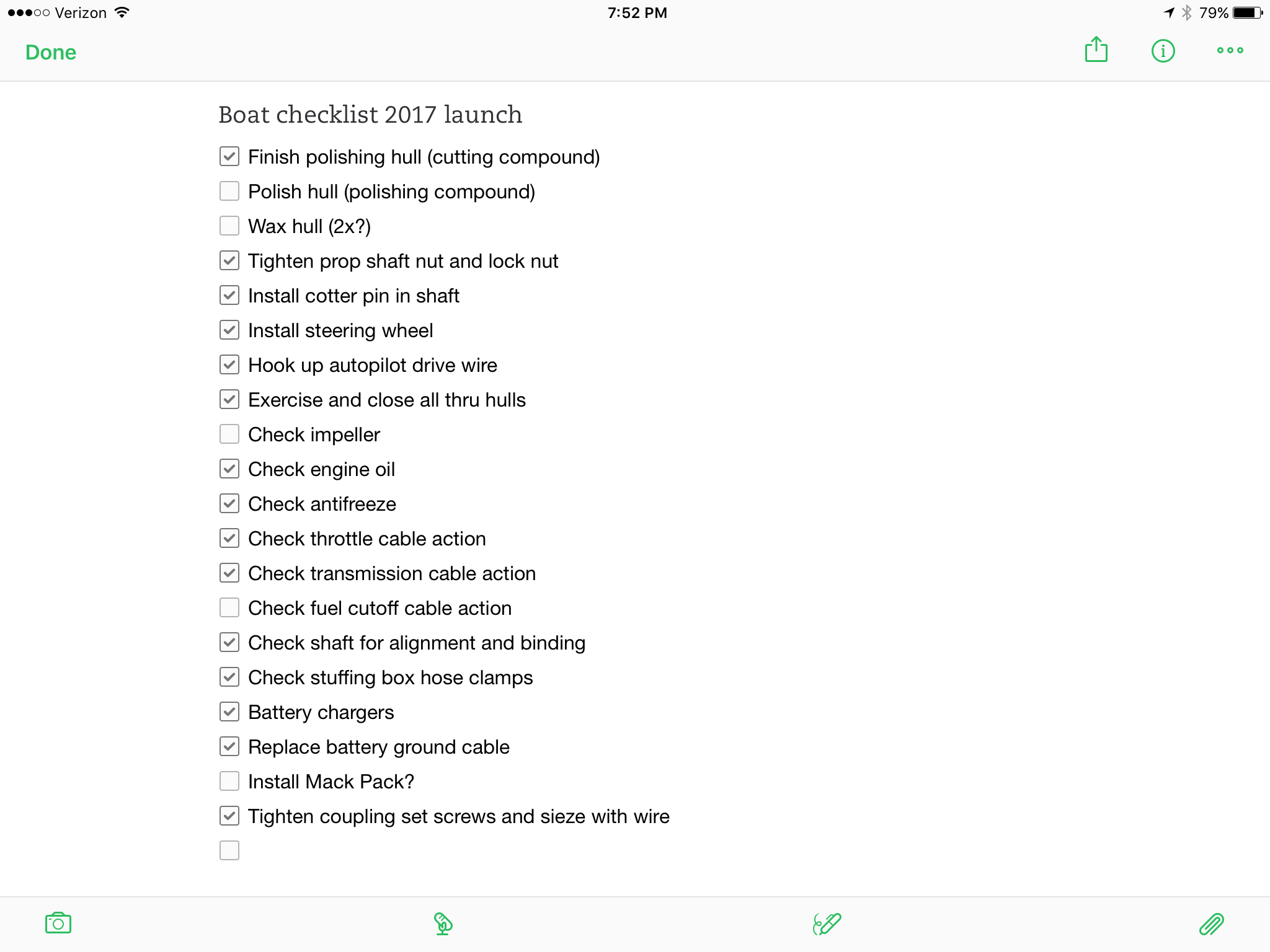

The checklist is almost complete.
