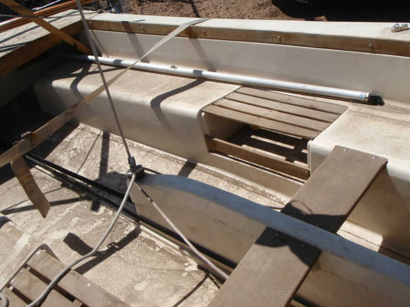

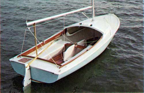

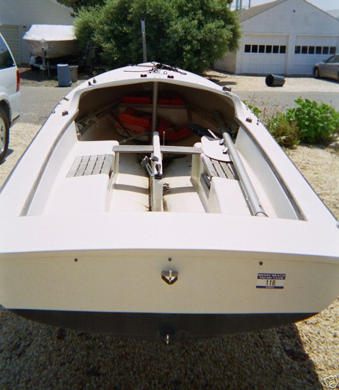

I've included a few pic of Precision/Spindrift Day Sailers, to give an idea of the original set up on those boats. As well as a few pics of O'DAY boats. I see that the side decks on the Spindrift boats are semi-supported by backrests from the seats, more like the original (1958-60) O'DAY DS I, than hte later O'DAY DS I (1961?-1970's) which had very little deck support other than hte wooden coamings. It looks like Spindrift used a fairly narrow strip of teak to trim the edge of the deck so there most likely were never the higher coamings like most O'DAY DS I boats have. Now I'm a bit concerned as to why your side decks flex as much as it sounds like they do.
