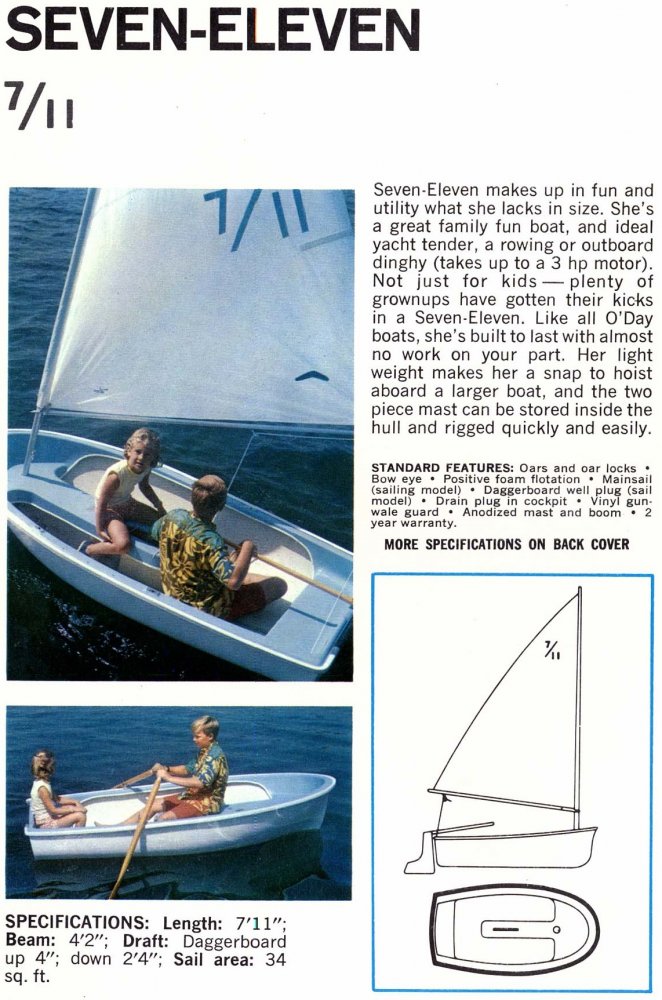

my 10yo daughter has recently taken sailing lessons and loves it. Someone gave us a 7/11 dingy sail boat that is missing many items. I am a powerboat guy and know nothing about Sailboats. I am hoping that someone has a complete 7/11 and can get me some pics? I can make the rudder and center board without a problem . I have the boom and half of the mast w no rigging. Can someone please help me as I am striking out on the internet

You might be able to scale some idea on dimensions from this drawing based on the known length to get your rudder dimensions. If she just finished a class then I bet the school might have some old parts that they could give to her too, I know our club would do that to keep the youth excited. It is basically just an 8' (ok 7' 11") dingy so they are all about the same as long as you aren't expecting to go racing.
http://sailboatdata.com/viewrecord.asp?class_id=7573

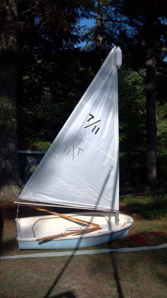

Do you have the sail and is it in good condition? If it's good then it should be easy enough to replace the missing parts. If you don't have the sail you will either have to have one made for it, make a polysail, or convert the rig to something readily available. Converting the rig will force changes to the rudder and board shapes.

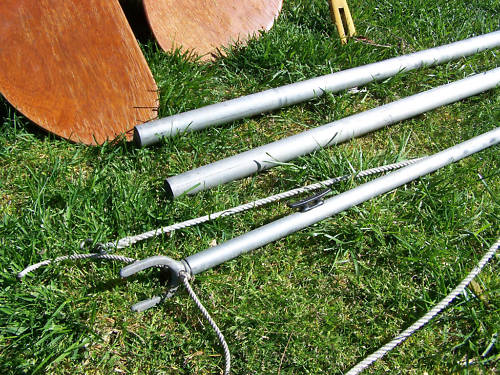

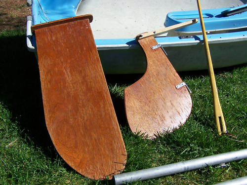

You can get all the dimensions from the pics Sunbird provided. The boat has a draft of 2'4" with the board down and 4" with the board up. So the board length is the depth of the trunk +2'. The width is a little less than the trunk width. The thickness needs to be narrow enough to slide in easily. Be sure to allow some room for the wood to swell or you will end up with a stuck board. At a minimum round the edges. A foil shape with be much better for performance. The rudder dims can be scaled from the pictures and the known board dims. Pintles can be bought online. You can pay a lot or you can pay far less. I like the Racelite brand.
The sail dimensions are: Luff 9.5', Foot 6.83', and leech 10.42'. With these you can figure out the mast length required.
The rigging is easy. Just see the pics. Since your daughter will be sailing it, tie an empty, capped, jug at the top of the mast. Like the boat fender in the pic. This is to stop the boat from turning turtle when capsized.
