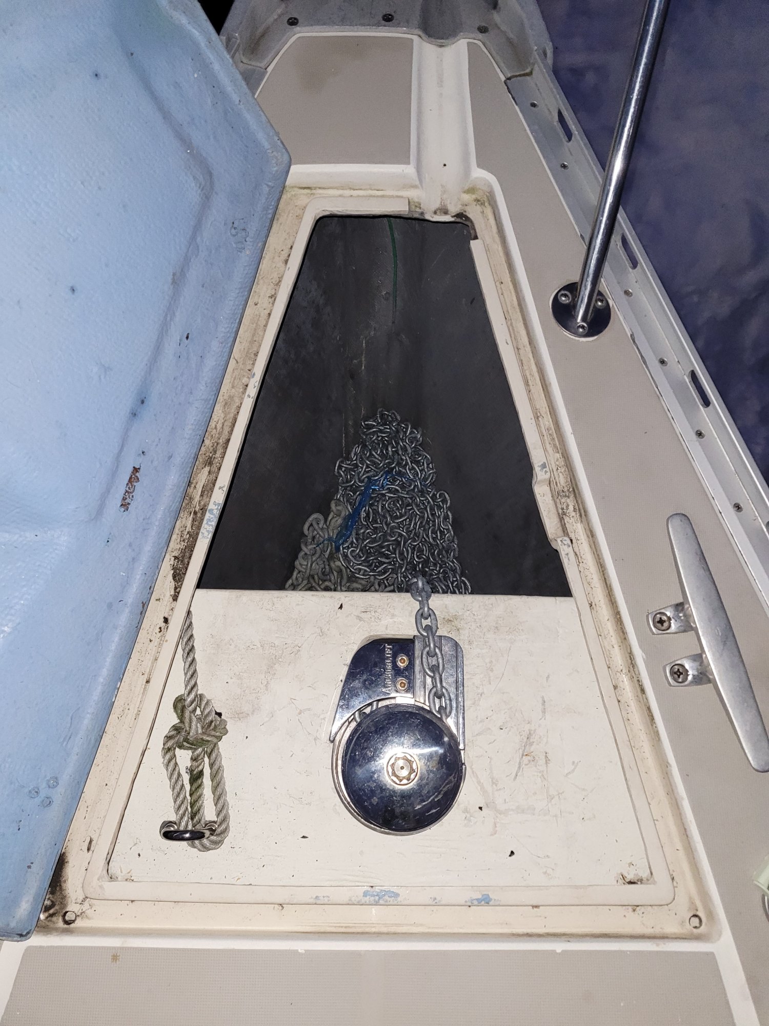

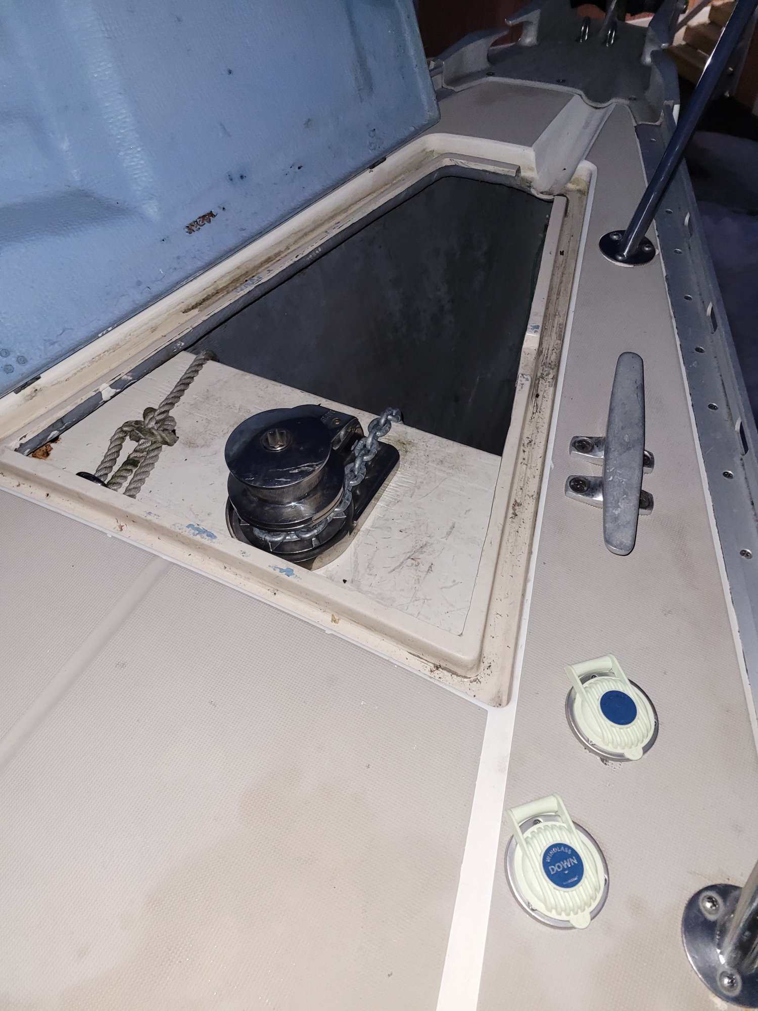

Anyone have pictures of their windlass installed in the 40's locker?
