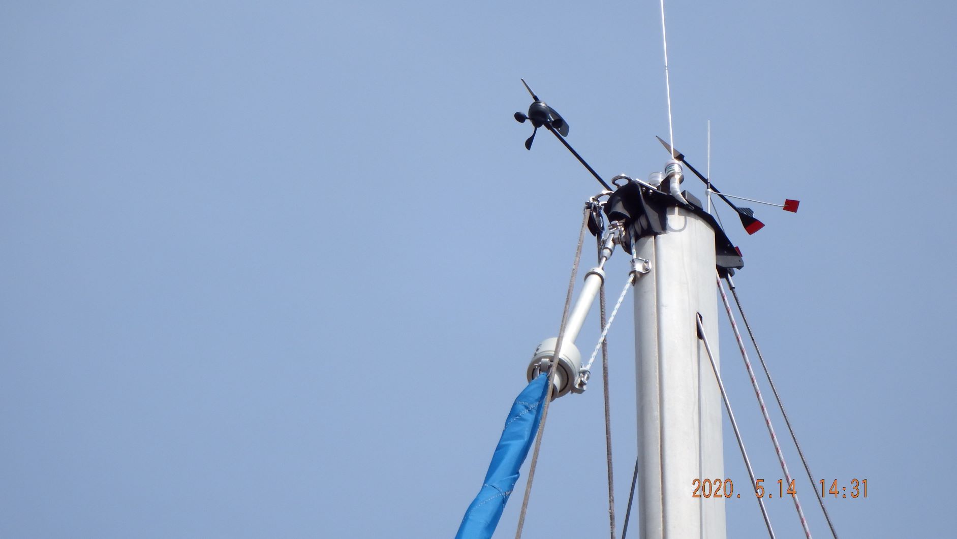

My 40 has the typical spinnaker halyard setup. Totally external. The spinnaker needs to be clear of the jib.
