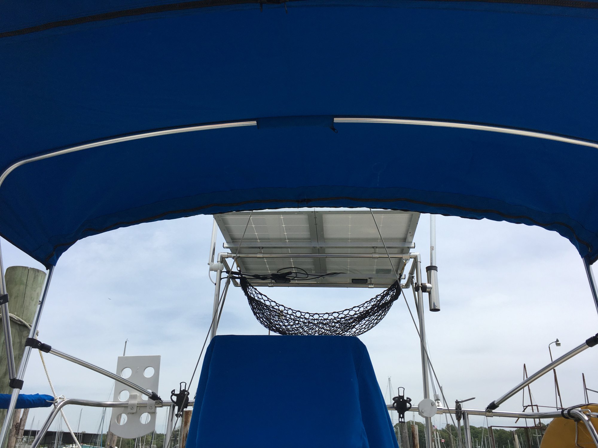

On my 30, I'm using two Group 24, 850's. I try to not use the motor so recharging is done mostly via a 200 Watt solar set up, using a double battery controller and monitored by a Ethernet connected EPEVER Meter MT-1 Remote with LCD Display.
Apart from starting my Universal M20 diesel engine as needed, my energy usage includes my auto pilot, VHF, chart plotter, depth sounder and stereo during sailing. I have changed every light bulb or lamp to LED, so my night time usage is minimal. So as long as the sun shines the power source is sufficient while alternating the use of each battery every other day, without getting them too low.
I made my own frame to hold the two 100 watt Renogy compact panels, that are mounted in conjunction with the stern railing. I used all 316 stainless steel tubing and parts. As the panels are encased in aluminum, they are mounted on aluminum square tubing which is attached to the SS frame using nylon washers to isolate the two different metals. It is structurally over engineered and built. Most cabling is internal on the frame, running through the aft combing to the controller. Each battery has an isolation switch and is fused. Inclusive of all, I believe it cost me less than $850.
I have plans to expand my capacity of batteries, to be upgraded to Group 27 or 31with the timing of when my current batteries bite the dust, but that may be a while yet. (Famous last words)

Thanks to all your contributions- finally decided to go with 2 Lifeline D4. Built a new battery box to be located beneath rear stateroom bed. Will augment w/375 W solar panel mounted on rear davits.
