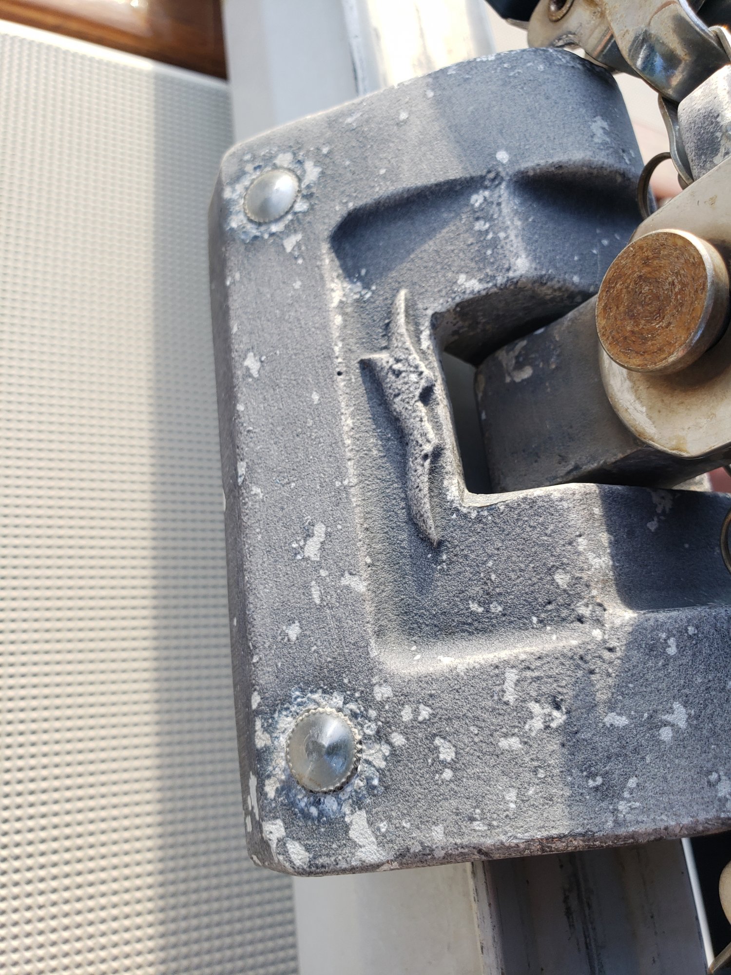

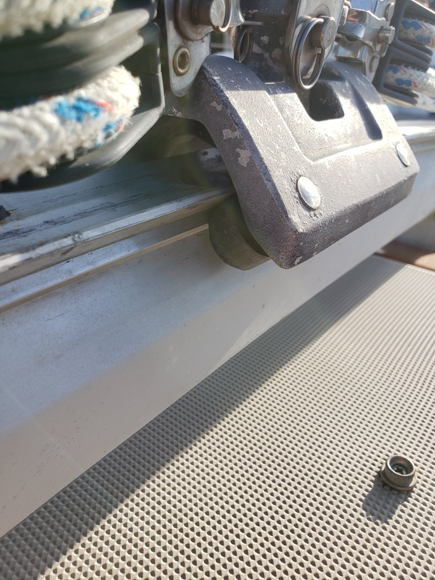

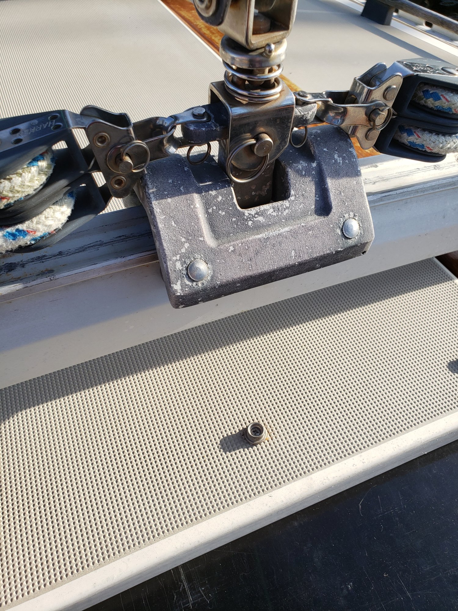

Correct me if I'm wrong, but that's a Merriman brand traveller car. That company is out of business over 25 years ago. I did a search online, but found nothing that will help replace it. Whats wrong with it. If the wheels are shot, maybe you can have them made out of some composite product.

Guido owns Garhaurer now? Re: your traveler... you might find some merriman parts at Minney's Yacht Surplus in Costa Mesa, Ca … they have a website.... But geezus … All you need is a couple feet of T Track and a new car... the existing blocks can be re attached to the new car.... Garhaurer will hook you up, but think in terms of replacing the track and car... rather than the whole system.

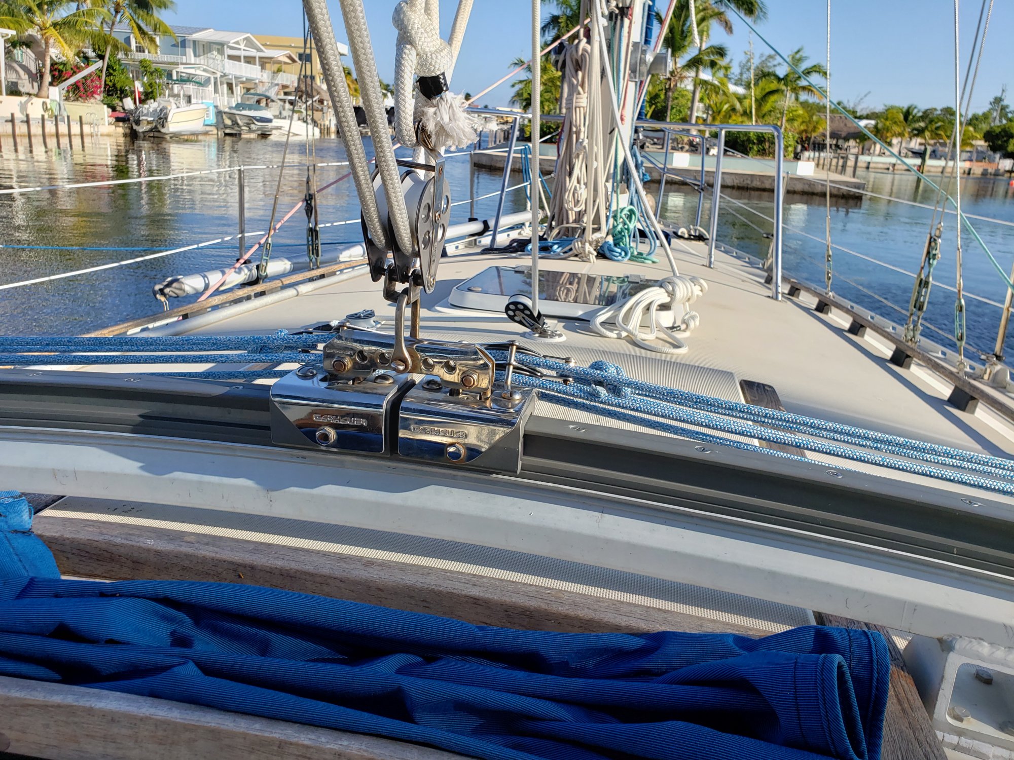

I replaced mine with a straight Garhauer track and car. Happy I did.

The traveler,turning blocks,toerail,and some other hardware for the 39 was made by the French Co. Goiot.I don't know if they still make traveler parts.

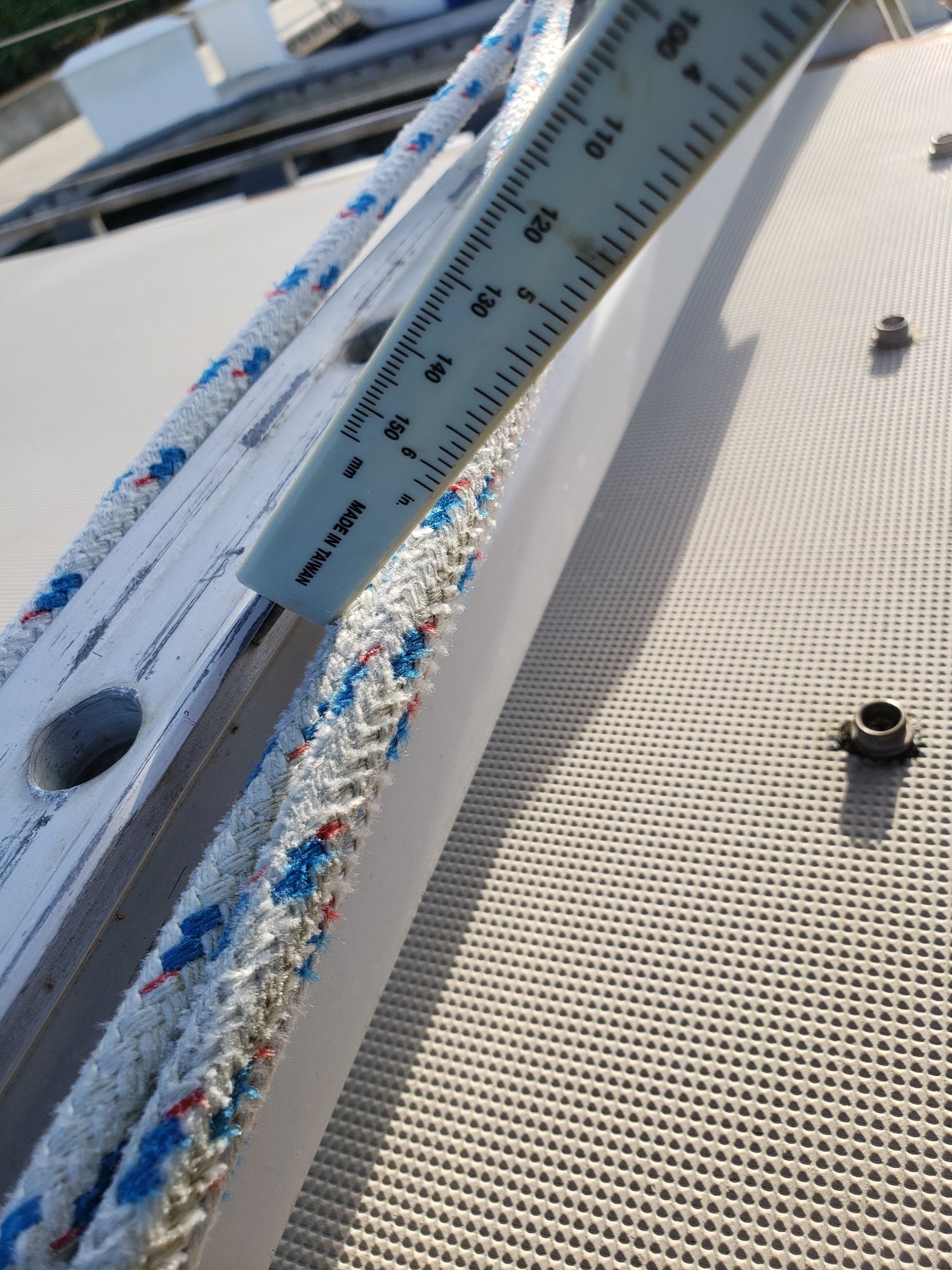

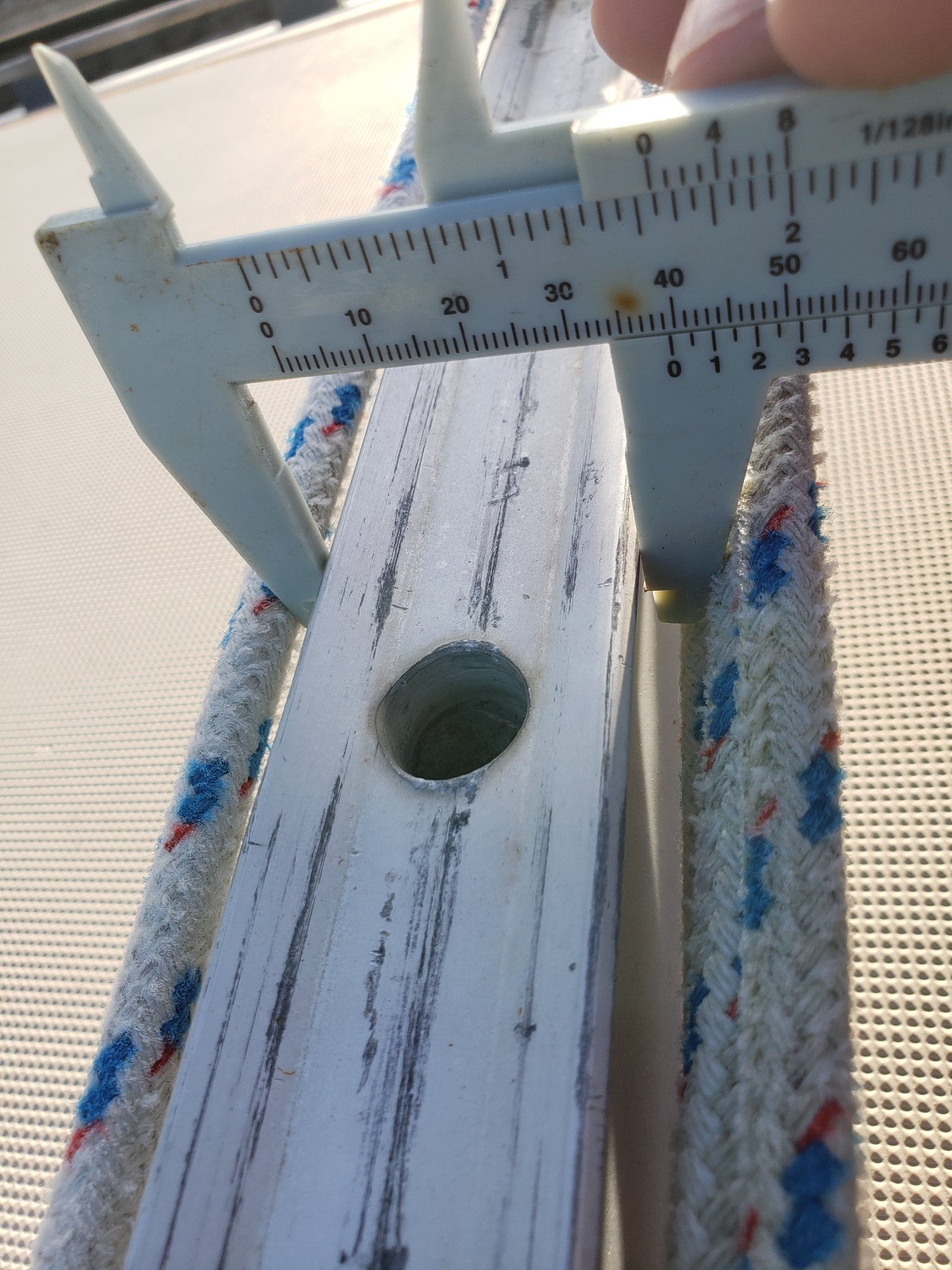

i bought a brand new traveller off this site store. I did measure what I had, and it is too light duty for you, sorry
