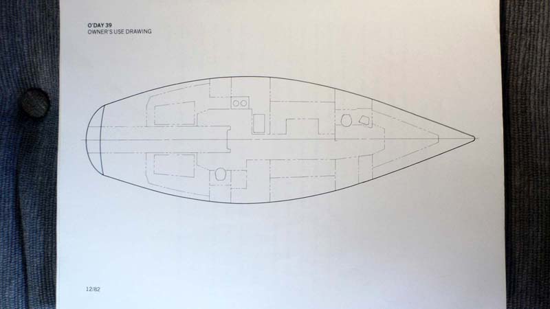

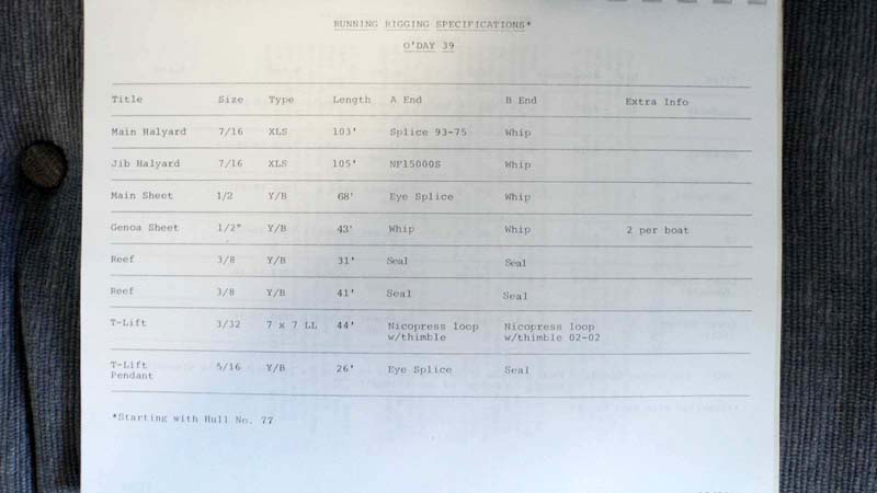

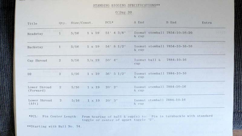

Hello All,
We had a survey done on an O'Day 39 yesterday we are looking at buying. I've attached a couple pages from the owner's manual which I thought could be useful to anyone who didn't happen to have one with their boat.
Most of the rest of the pages I photographed came out a bit too blurry to post, but if we buy the boat I will be sure to the complete manual available.
