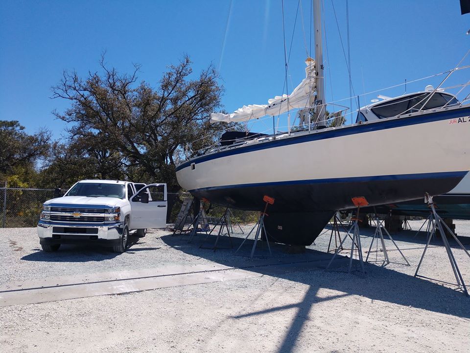

On the drawings it shows shoal draft with a drop keel fin. Did this change? I haven't seen any. I have #32 any way to tell if I have the steel or lead keel?

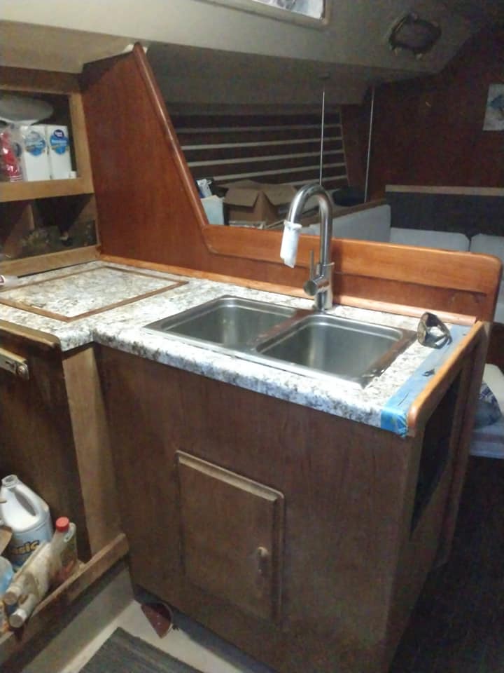

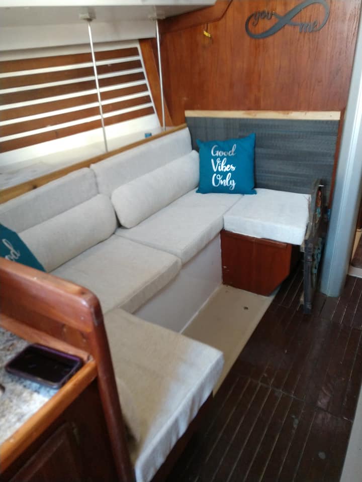

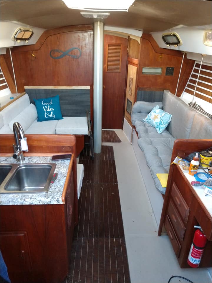

Hi everyone. Not sure how many are still monitoring this thread. I think JAyers sold his boat and moved to Florida where he got another boat. I've been working on mine for a year now. Most of the hard stuff is done; new thru hulls (o hell that one behind the engine by the muffler......)new toilet and hoses, new galley top, bottom paint, chain plates, and the list goes on. Next is the wiring. The previous owners did me no favors here. Going to do the AC circuit first since its the smallest and easiest to do. Made my own cabin cushions and repainted the interior. Have lazy jacks but haven't installed yet. Weather here this winter hasn't been good. I noticed on the shoal draft drawings on saildata there is a drop keel. Didn't see that on my boat. Was that only certain years?
