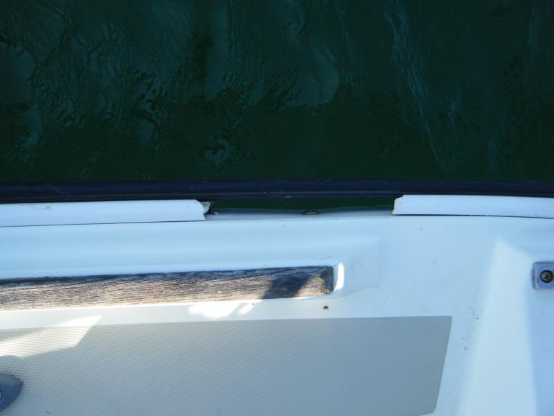

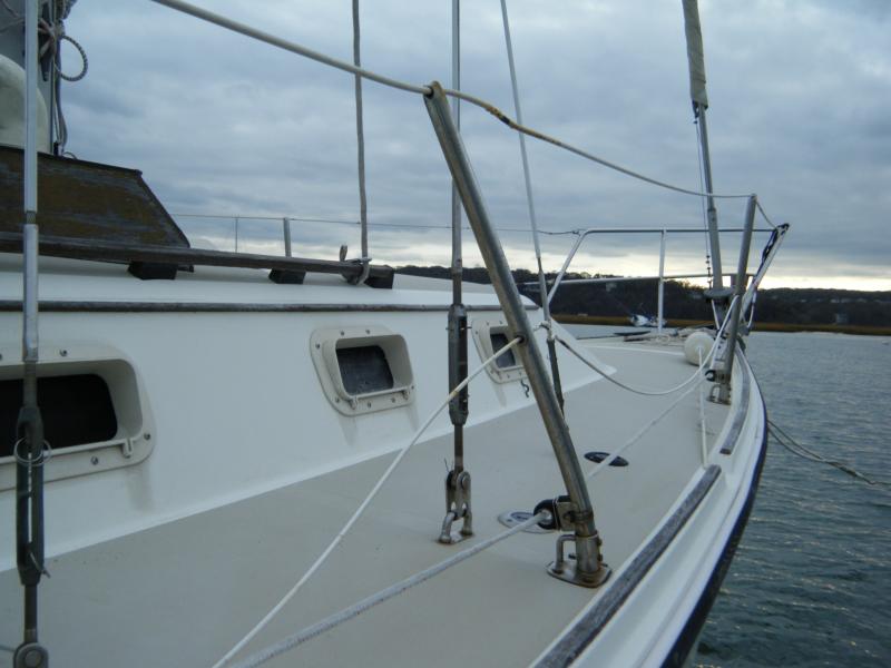

My boat was damaged during hurricane Sandy. She was on her mooring, prepared as best as I could. She didn't move but lots of other boats did. The next day I found some some other boat must have broken loose or dragged into me and my poor boat suffered from it. I can't complain as many people had it a lot worse, but I had broken lifelines, bent / broken stanchions, broken rub rail and and some hull damage. Fortunately I had insurance, and Allstate quickly sent a check. It took some time, but I finally had all the damage repaired.

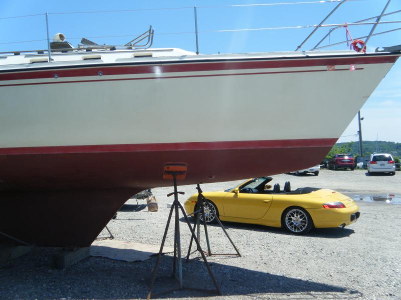

Some before / after pics

Looks great Barry! Did you do the rub rail yourself or was it done by someone? We finished ours a couple of weeks ago. It went smoother than I thought it would. Was the red feature stripe original color?

I paid to have the rubrail installed. I can't believe how many screws were used! Each one was bedded with sealant too. The guy who did it did a great job. You should see the transom, he matched the gelcoat color perfectly.
The boat really sails great with new, properly tuned rig, fresh bottom, and good sails.
