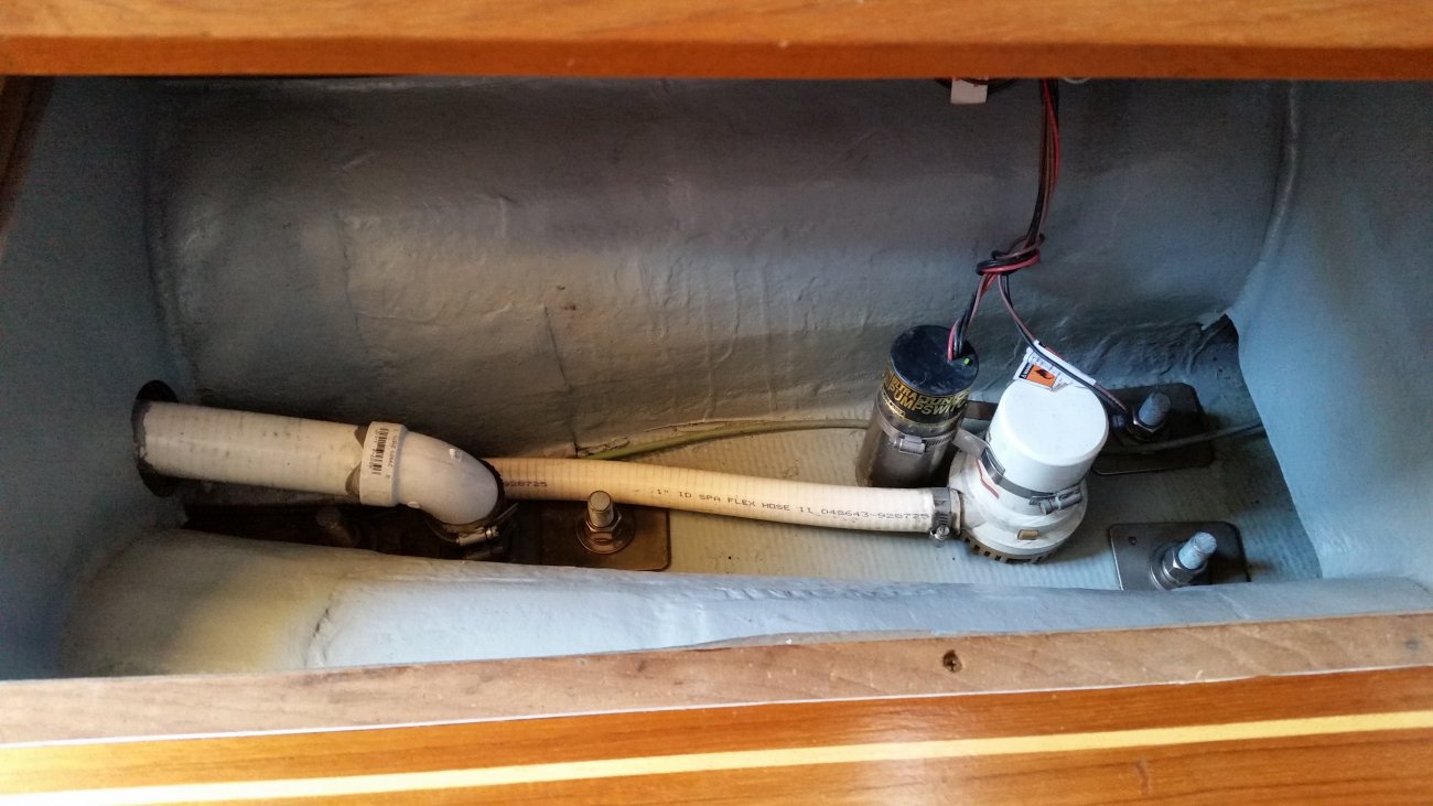

I tighten them as much as I can with a 21" breaker bar while I'm laying on the cabin soule...
My best guess is ~110ft/lbs. The torque that I use is sufficient to crush the split-lock washer into a ring. This isn't like torquing the bolts on the head of an engine. I just don't want them to crush the FRP, and I don't want them to fall off. I also want to be able to remove inspect and polish them again next year.
