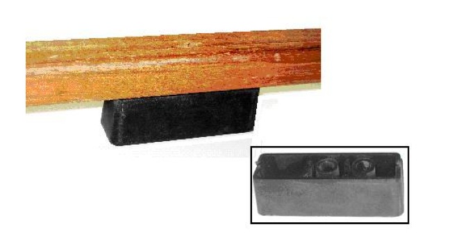

Hey Stu, thanks for the response. The O'day 35 and I'm sure 34 used a teak rail with some sort of composite standoff (see photo). The interior handrail is the same. I want to remove the teak completely and redo it. Also, there are some sort of pads (rubber? neoprene?) under the standoffs to prevent leaks which seem sort of hokey so I want to rebed themwith butyl.

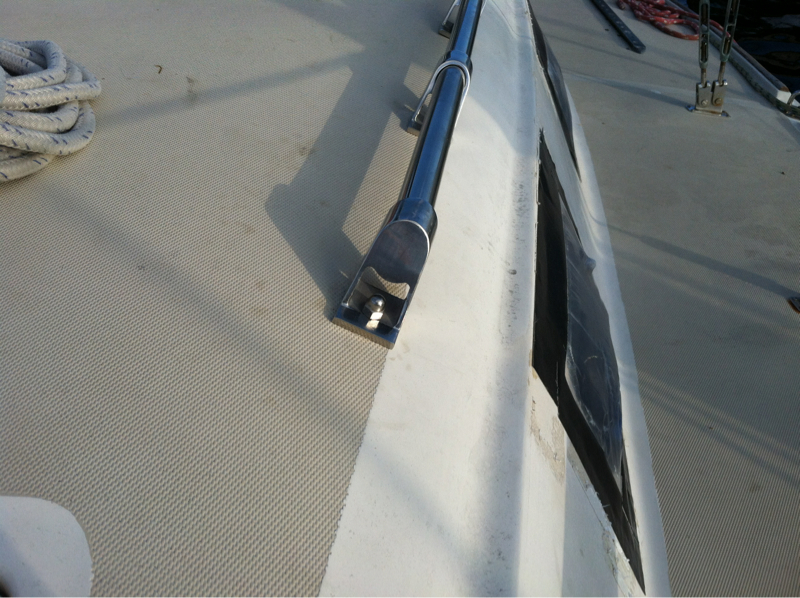

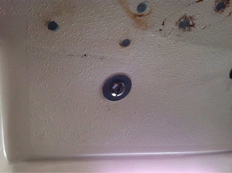

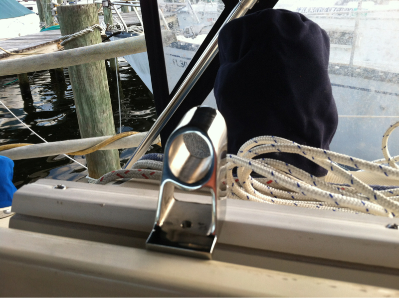

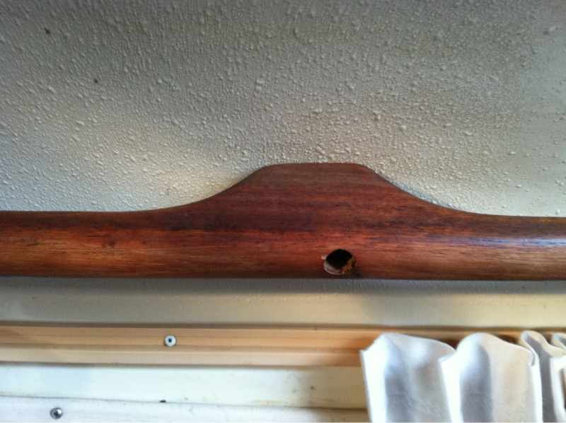

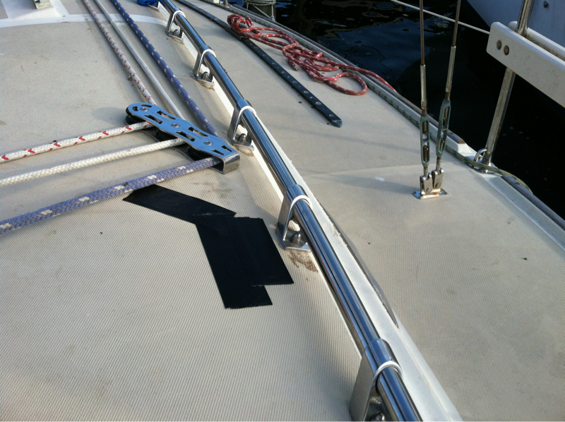

I replaced my teak on top with stainless. I lucked into a bracket that had a single hole. It was1/4 28 but I re-tapped to 1/4-20. I left the teak inside but got tired of dealing with refinishing outside. The process I used was filling the holes with epoxy then redrilling the holes. As far as getting the bungs out I used a forstner bit into the rail just below the surface then ran a wood screw in to back the bing out. Using the 1/2" forstner broke the surface so the glue did make the rail split.
On reassembly I used 1/4-20 pan head screws that went through the teak into SS rail bracket then was topped off with an acorn nut. To stop leaking I used a countersink on the deck side opening. Silicone was placed in the hole, then the bolt was pushed through and I put an o-ring with a 1/4" id opening. This was pushed to the countersink on the deck. Then the bracket was put on and screwed down. Half the thickness of the o-ring was above the deck. The countersink taper pushes the o-ring into the bolt and seals the bracket to the deck. The acorn acts as a lock nut. Mine don't leak and are extremely solid
