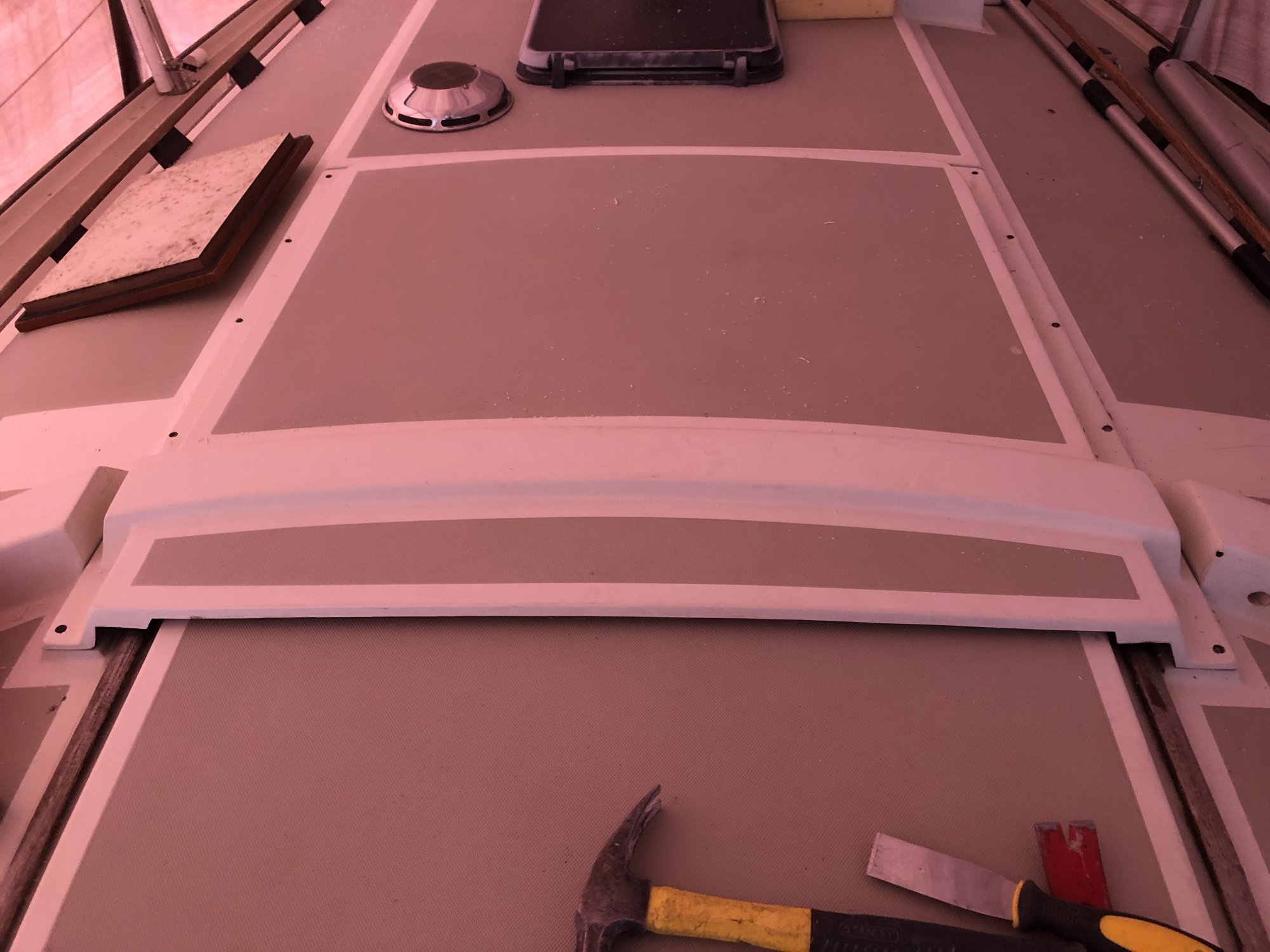

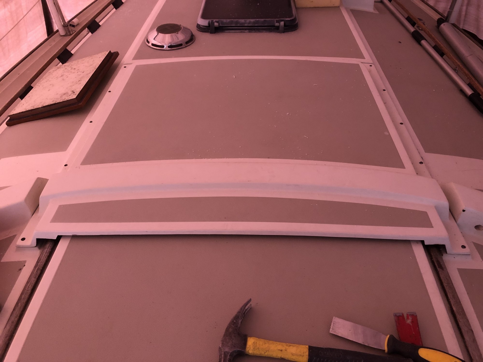

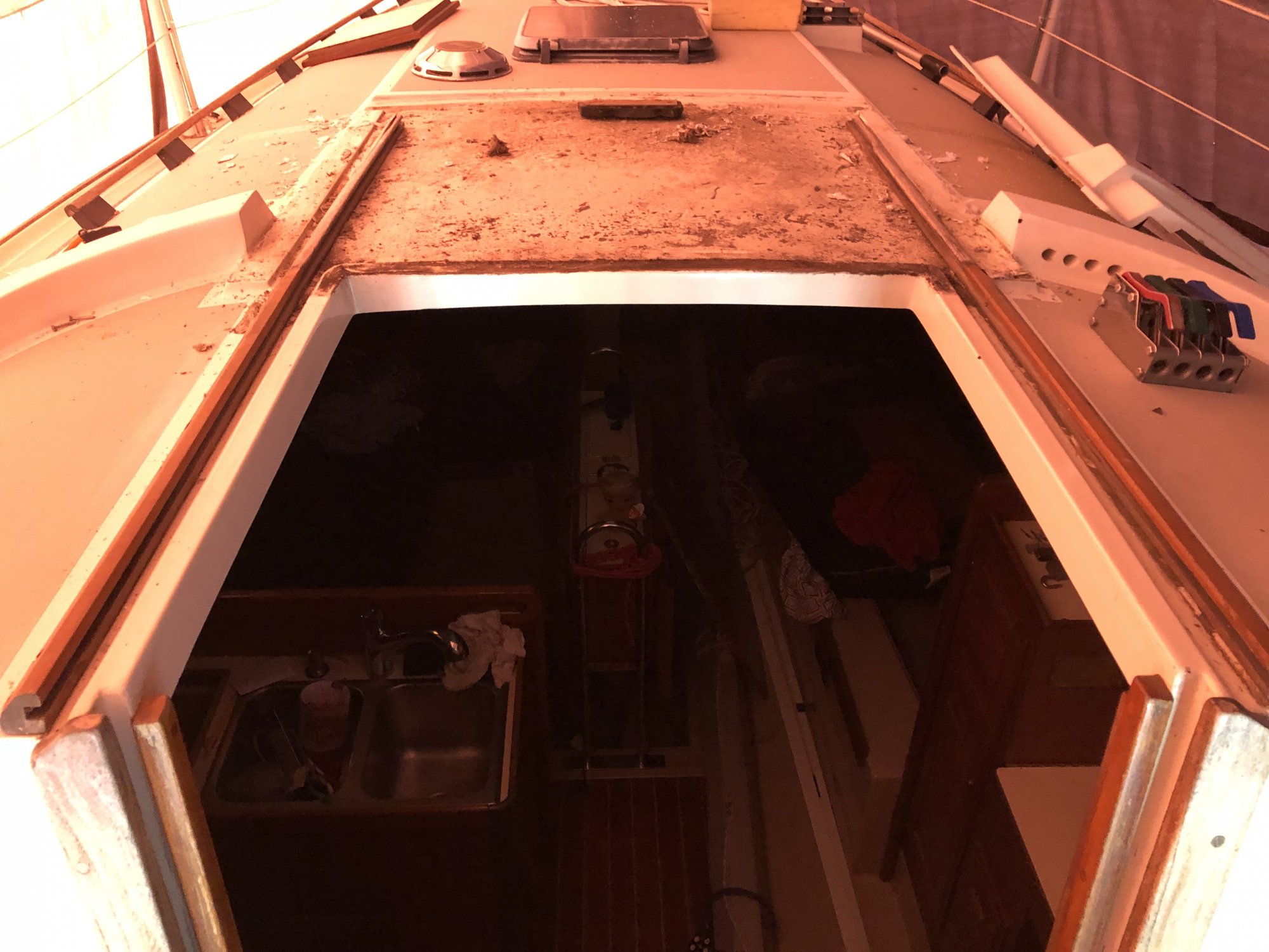

i pulled mine on my O’Day 322…a little different securement it looks like…mine had a teak strip that was screwed down and held the over in place. So I had to remove that board instead of just the screws you removed.
But then, it was a matter of carefully pulling it up. I pried on mine and cracked the glass, so you are wise to be gentle and as others have said…patience is key.

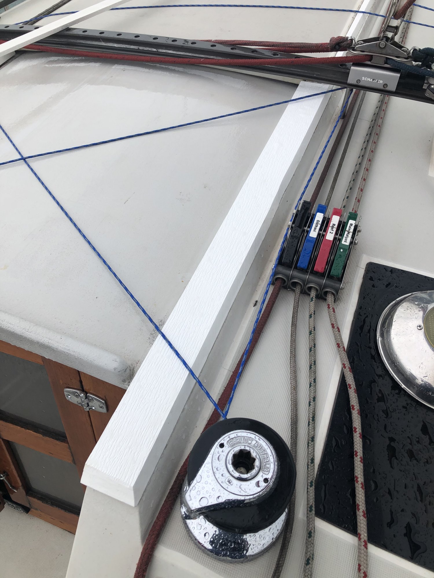

I hate varnishing teak, so I replaced the teak rails with white fake wood…
The string is there because I hadn’t screwed the cover down yet, and we were expecting storms that night…I didn’t want to get to the boat the next day and find my sliding hatch and the cover at the bottom of the lake :huh:

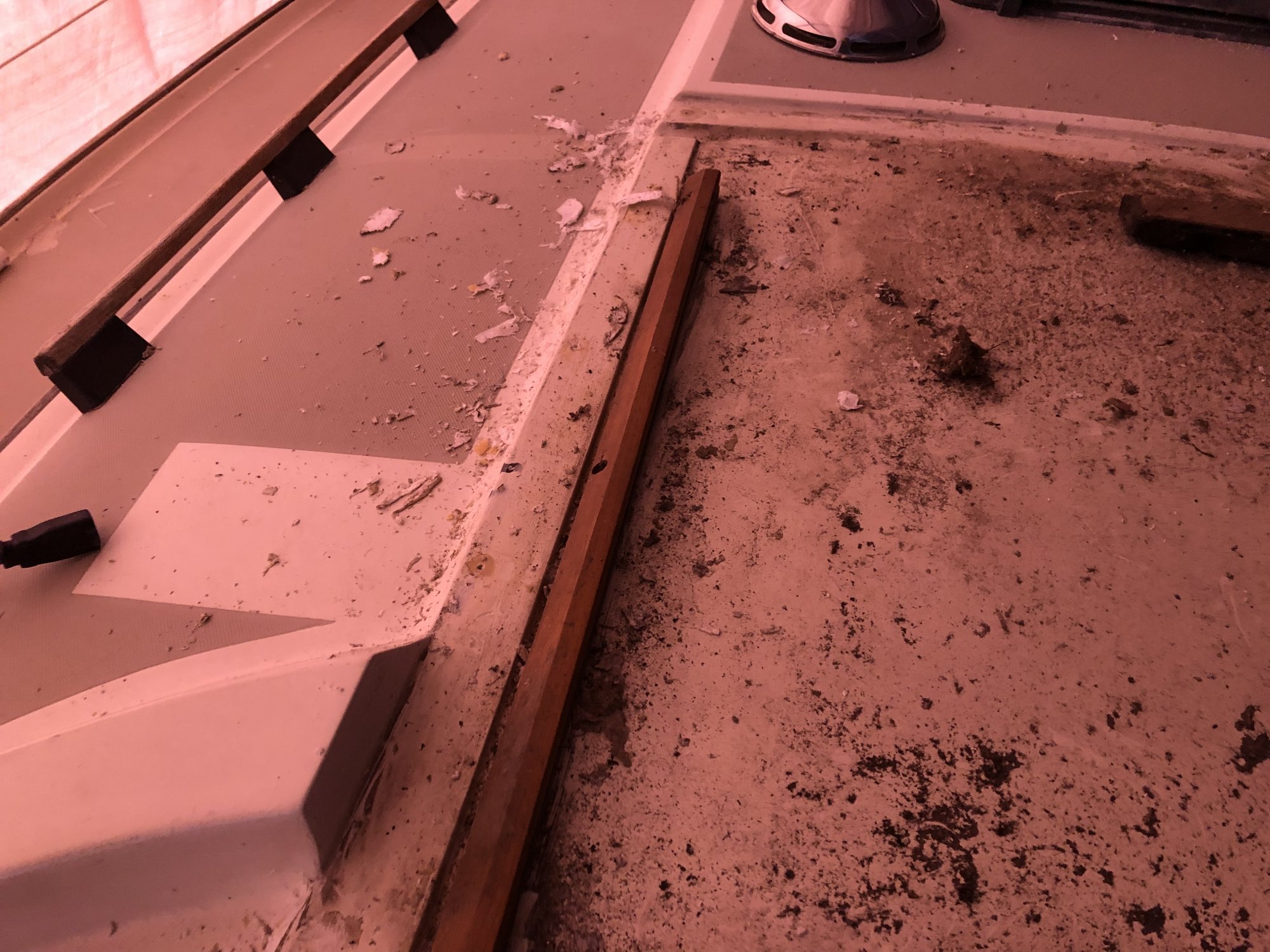

Hi Guys

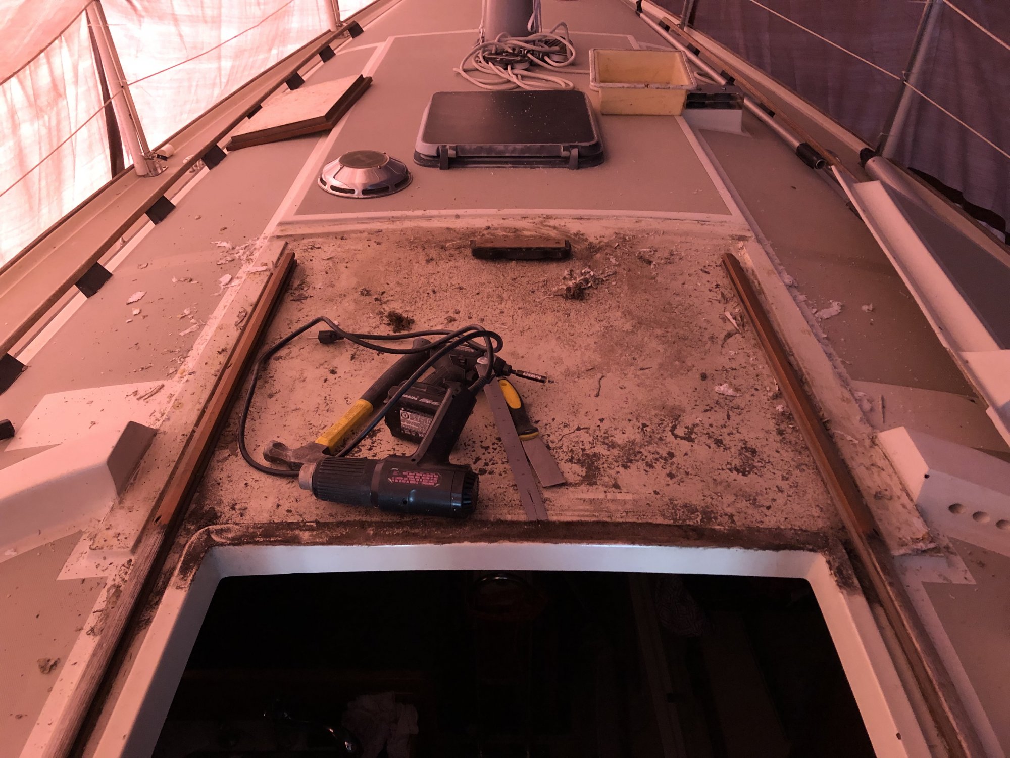

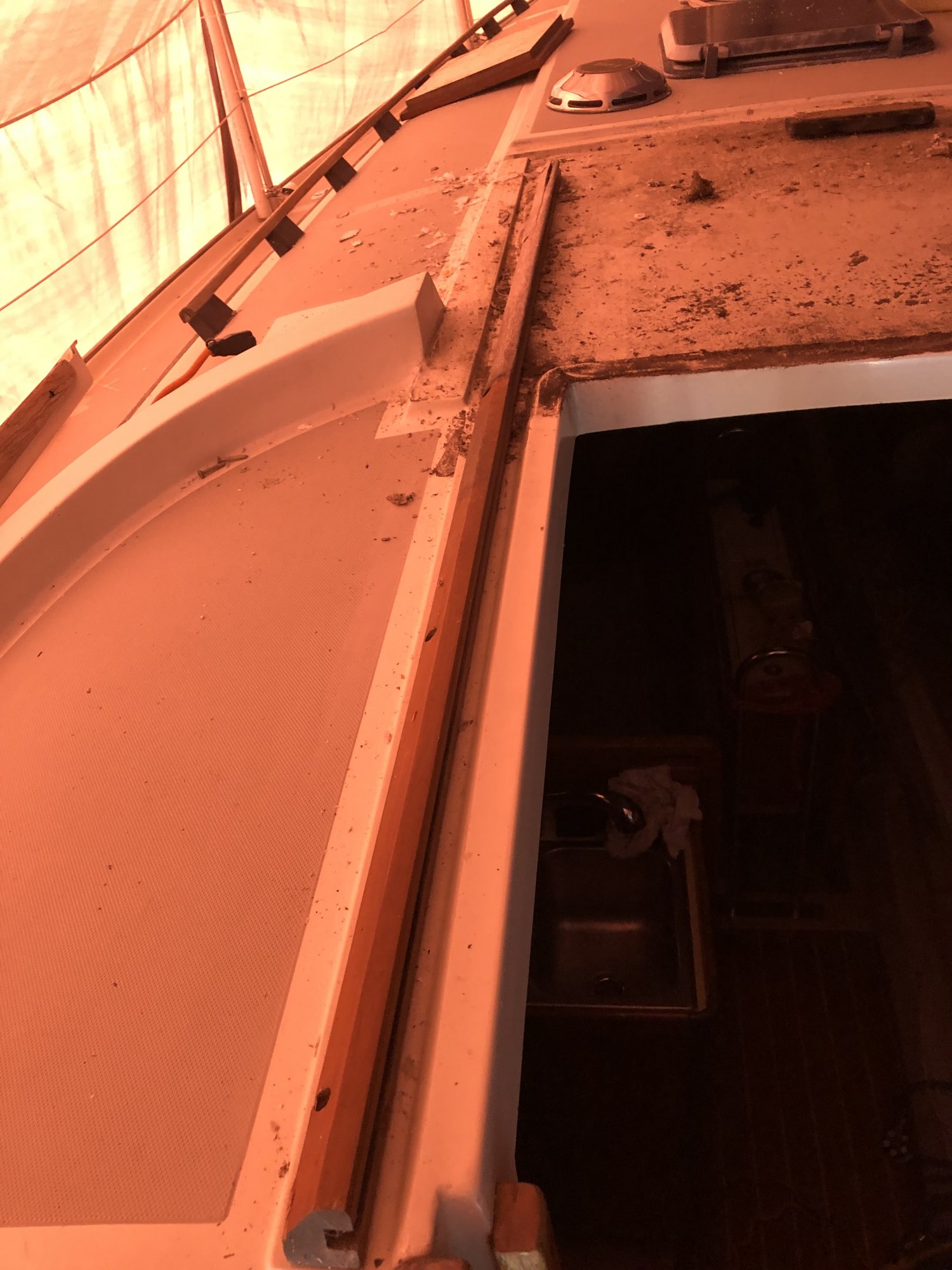

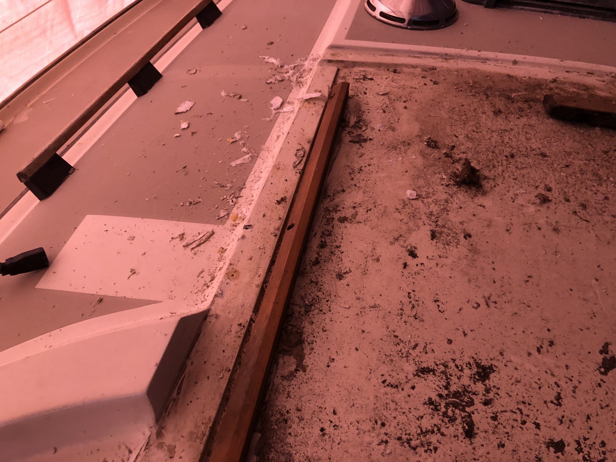

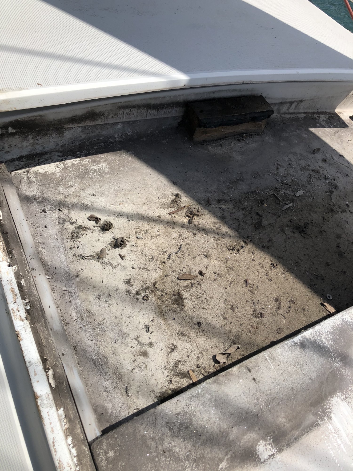

I was able to remove the companion way hood yesterday took about a hour and a half and 3 beers . I used a heat gun a sharpened putty knife a hammer and a 12 inch slide rule from a combo square
I heated it up and slowly pried it all free
When it was removed I noticed how nice the wood rails were under the hood so instead of making new rails and can just flip them around
