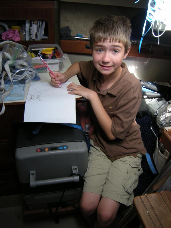

Jibes, here's a great photo of my kid, not such a great photo of the setup, but enough to give you the idea. It's the best image I have. Here's the fridge info...
http://www.dometic.com/USA/MS-11346...-143418-CF-050AC-Portable-RefrigeratorFreezer
As I recall, we bought the CF-50 unit. I made a tray that the unit sits in that has cabinet hardware gliders that allow the unit to slide out when you want to access and push back under the nav station when not in use. I also attached a caster wheel to the underside of the tray to support everything when the unit is pulled out. I'll grab some photos of my setup next week when I'm up at the boat. I strap secures the unit when sailing.
