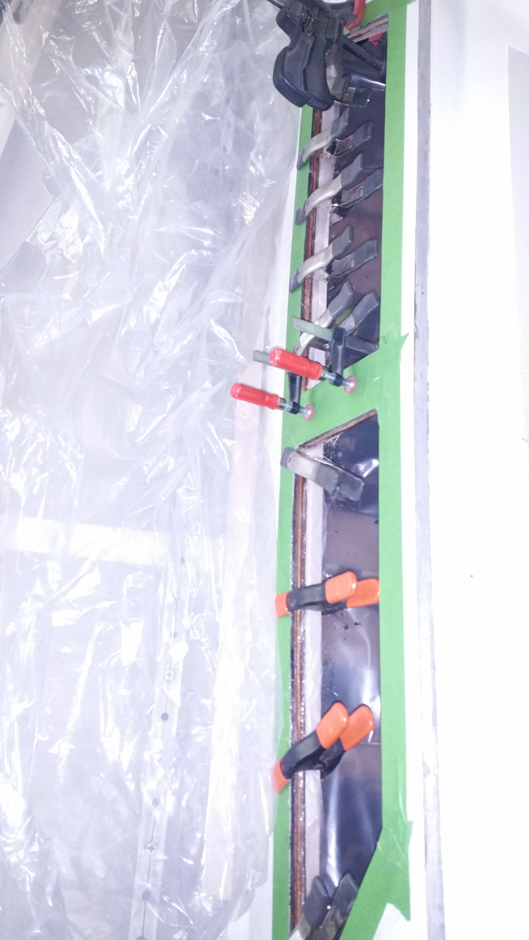

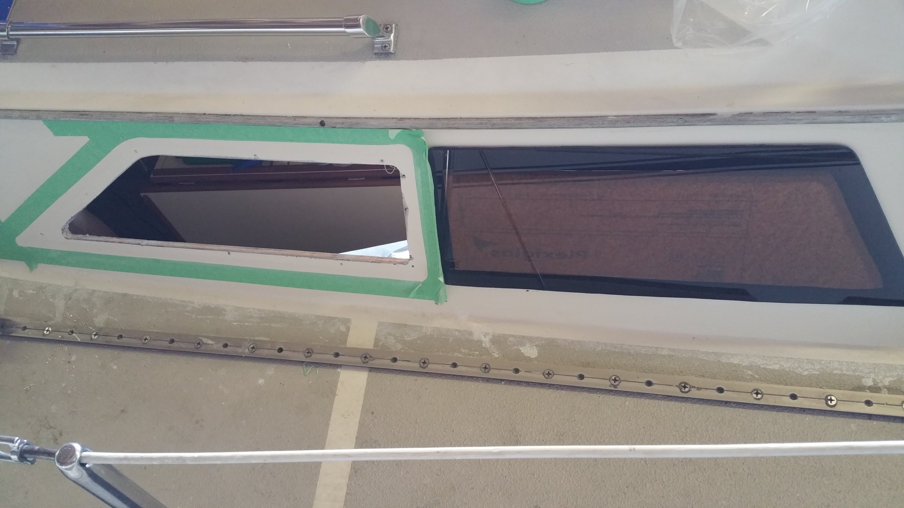

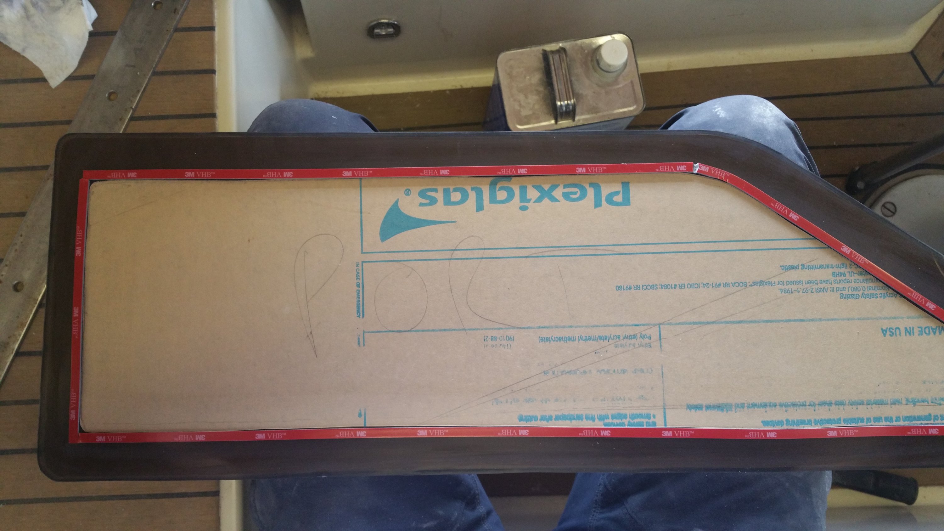

Today I was able to get the windows glued in. As is my M.O. I photo document 1/3 of the process and forgot to take photos of the rest. The photos attached are one window installed with the forward opening ready for the new window. (The mess on the deck is from wet sanding the opening). I split the formerly one piece window into two smaller windows with a small space in between. Despite all assurances to the contrary, I was nervous about the tape holding the window in place against the curve in the cabintop until the sealant cures. Making two individual pieces takes a lot of the curve out of the equation. The second photo is one of the windows with the masking film cut back to the opening size, and the VHB tape applied. I could only find 1/4" VHB tape in black, so that is what I used. I also made the windows slightly larger than the previous windows to allow for more sealant since I didn't want to use any screws, and was again, nervous. After I applied the VHB tape, I ran several beads of Dow 795 around the perimeter, then troweled them relatively smooth with a putty knife. I was once more nervous that the sealant might squeeze between the VHB tape and the gelcoat, preventing the tape from sticking so I wanted to be sure I didn't have too much. I also didn't want to try to inject it with the caulk gun after the window was taped in place since the underside especially would have been difficult. I am happy to report that all of my worrying paid off in spades, and the windows are installed, adhered well with the tape, and the sealant oozed out the perimeter slightly where I was able to clean in off with some alcohol prior to removing the masking tape. I got full coverage under all of the windows, and I am very pleased with how it is turning out. Now I just have to finish making the interior trim.
