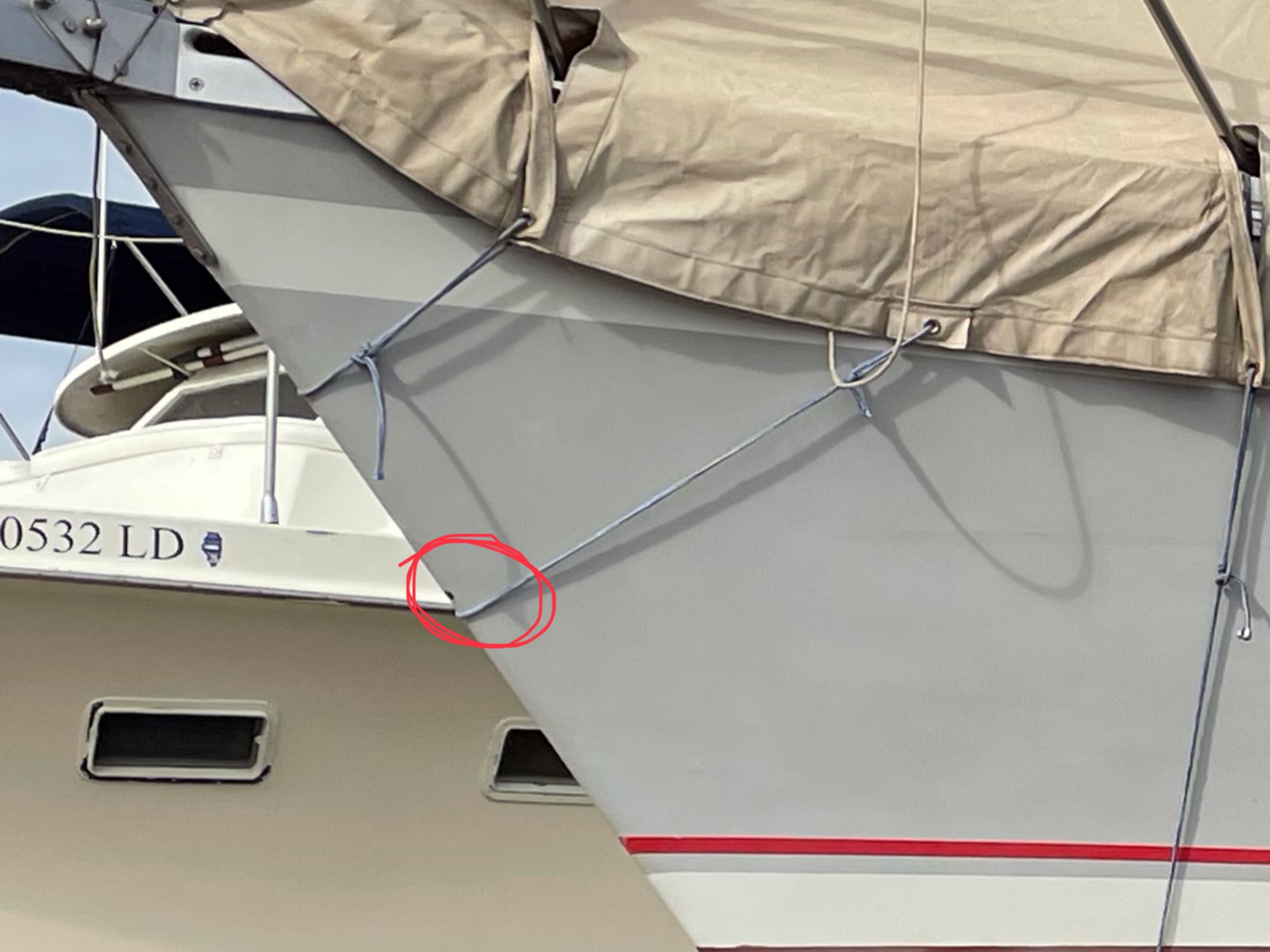

On my O’Day 322, the anchor locker drains out a vinyl hose, to a barb fitting near the bow, above the waterline, without any valve.
you can barely make it out in this photo (I circled it)…
Greg
I think mine is the same. I was looking for an actual fitting nest the bow at first, but I did see a hole just like yours. Thanks!!
