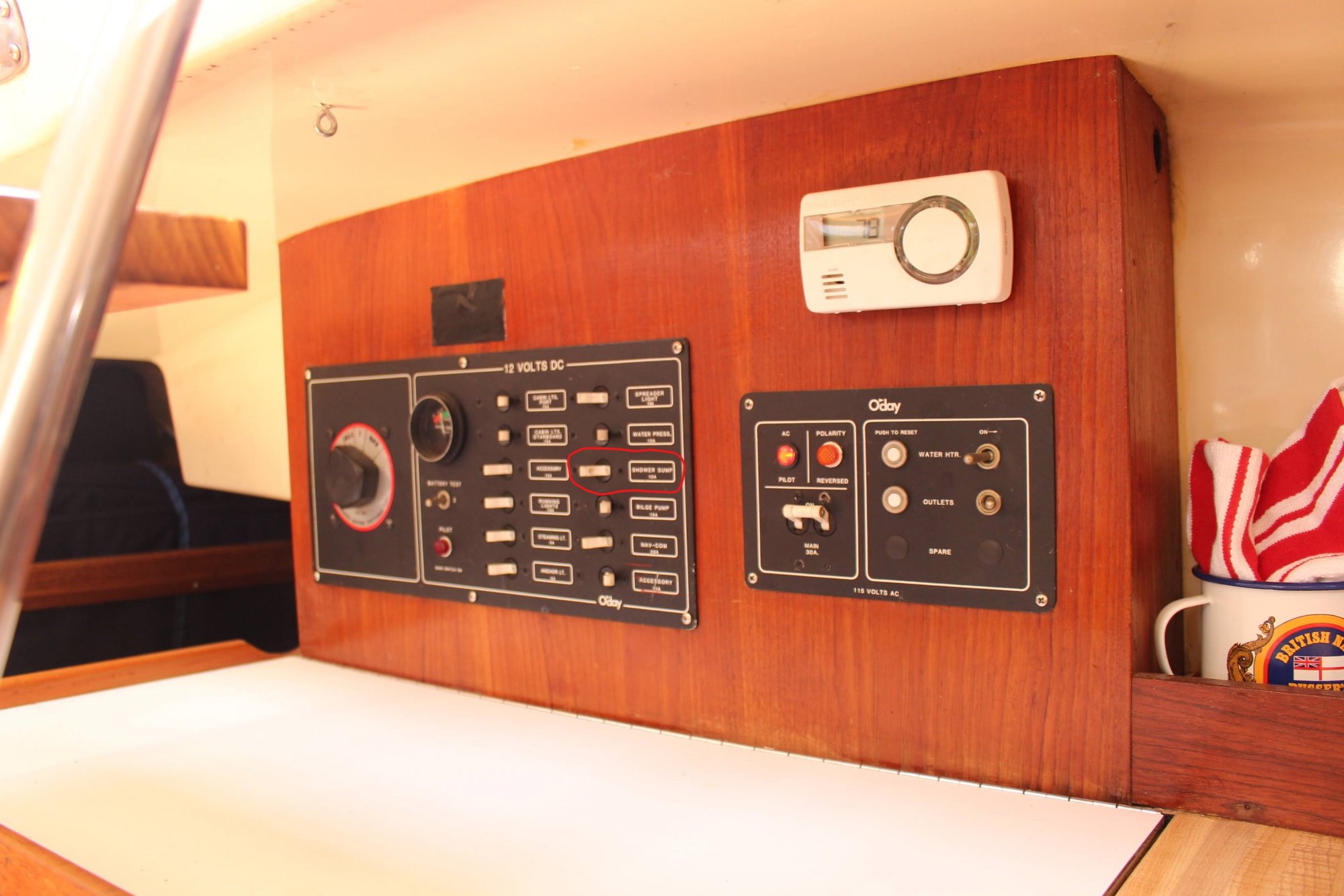

I looked up a photo of my O'Day 34 fuse panel. There is one labelled shower sump third down on the right. I also remember there being a second set of wires in the front bilge unused. My bilge was separated in 2 areas and joined only by a hole towards the bottom that allowed water to flow from the forward section (directly under the mast step) to the rear where the main pump was connected and operating. You could install a second pump in the front section and use the second set of wires to operate it if you feel the need to. That would require running a second discharge pipe, that will not be easy but is certainly possible. I recall I did have an intermittent problem with the bilge pump vapor locking necessitating clear the line by removing the discharge side and blowing air through. I tried several fixes including a larger volume pump, smooth bore hose, with and without a joker valve and rerouting the discharge hose to assure upward path to discharge with no low point. It would still occasionally happen and frustrated me.

Funny, your "Shower Sump" switch is where my "Autopilot" switch is located. Karma has a separate dedicated bilge pump panel with Manual-Off-Auto as well as indicators.
