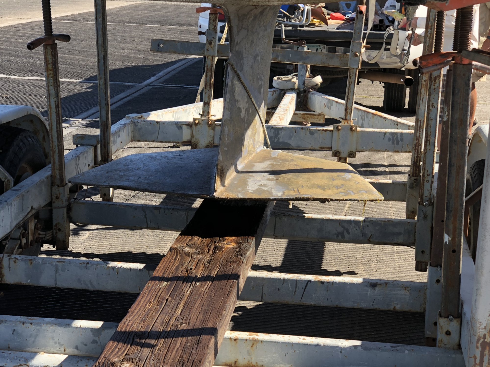

The hauler's trailer is only about 2' wide, so we'll be setting the keel on top of the trailer frame under some cross beams to support the keel. He said he's done this before and there shouldn't be an issue, the only downside is that to unload the boat at the house it will need more blocking under the keel so it will sit a little higher. No big deal. Pictures to follow next week.

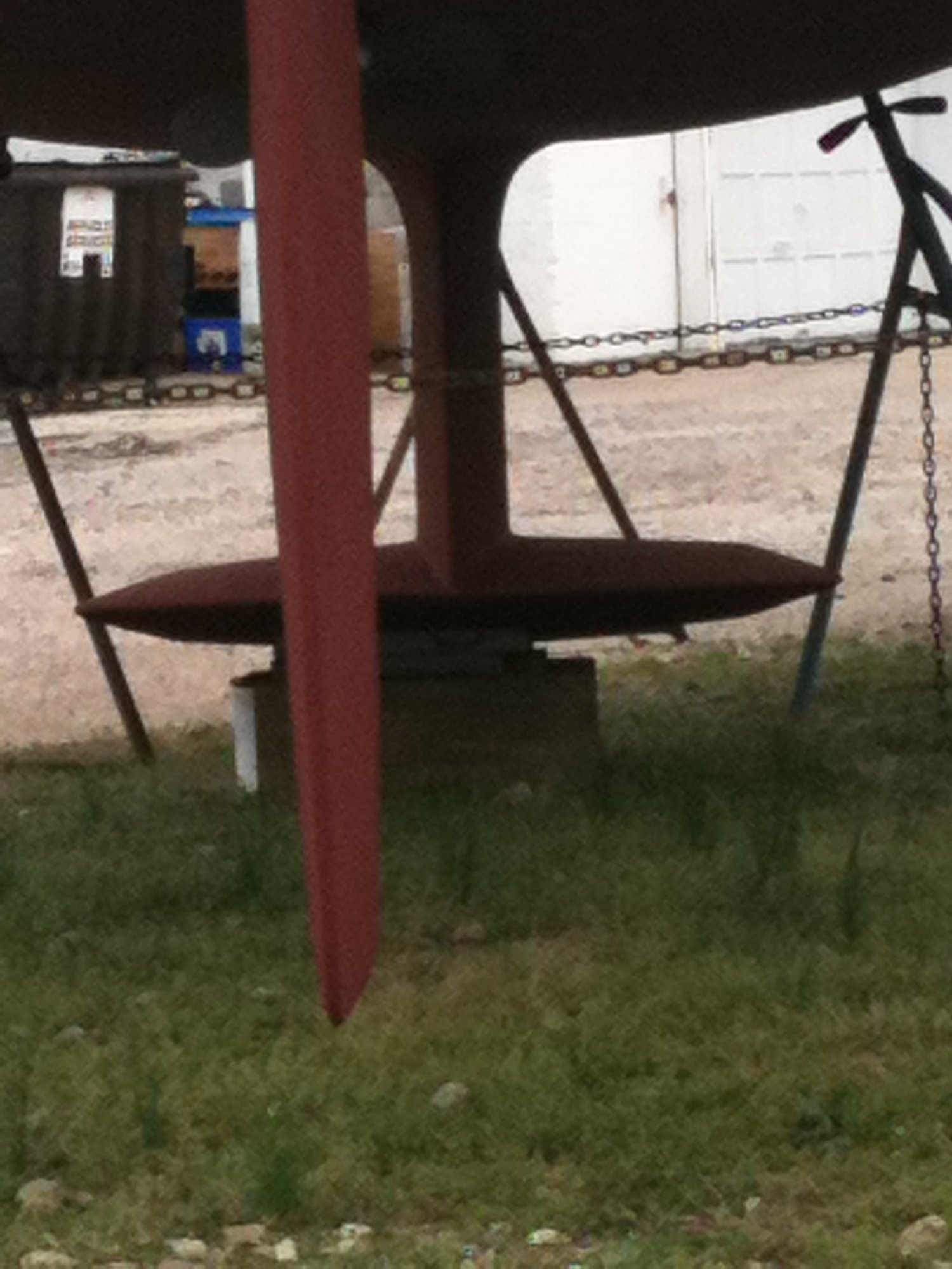

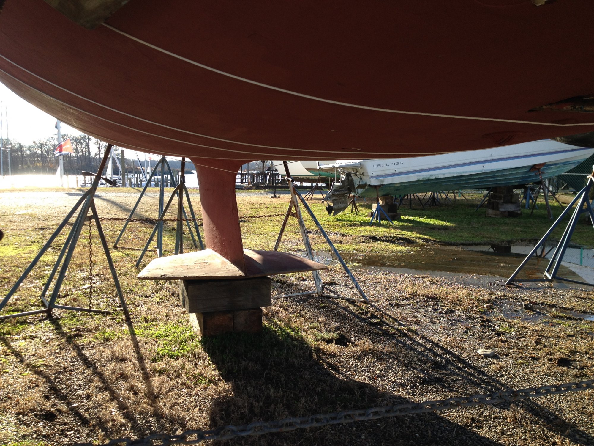

Speaking of groundings in mud, (Delaware / Chesapeake) I can't tell you how many times I have just done a pivot 180 degree, with full rudder and a moderate bit of power, and then go back out the same way you came in! You would never be able to do that on a knife-edge keel, but with that big pie plate down there at the bottom, it just seems to pivot around no problem.
I will measure this winter, because I am interested in how much square footage is presented in the horizontal surface, but I would estimate it is 3' wide easily. It is big. It is remarkable how effective this keel is upwind in anything over 2.5 knots.

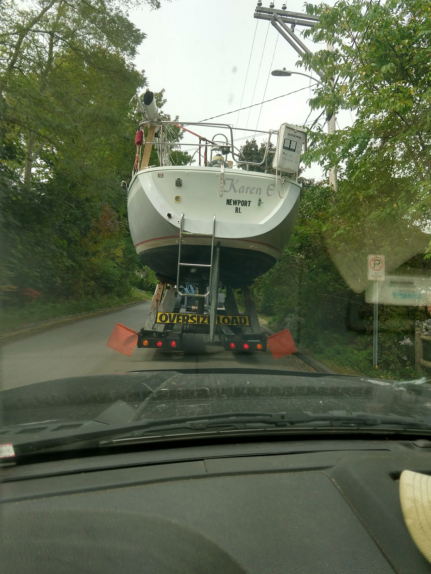

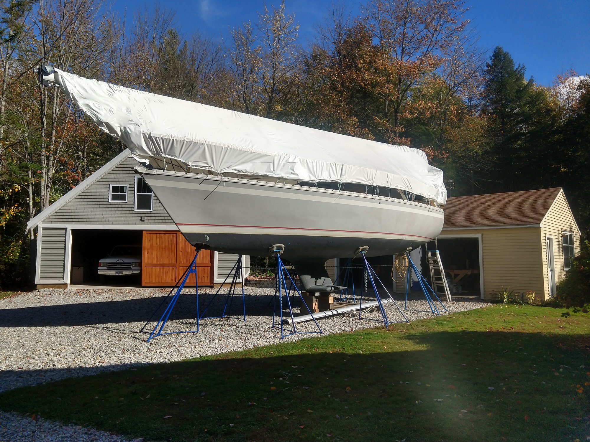

The boat made it home, about 28 hours of non-stop sailing and some motoring from Buzzards Bay, MA to Casco Bay, ME. From there I un-stepped the mast and then had a travel lift load it on a hydraulic trailer to bring to my house. For future searchers, the keel measures exactly 49.5" at the widest part (at least mine is), so it's just over 4' wide. Quite a footprint, but there were no issues putting it on top of the trailer frames, with blocking coming up from a removable crossmember for support. I'll be starting another post at some point with some info of my projects I'll be completing throughout the winter, will be wonderful having it at the house and not having to pay storage or drive to the marina to work on the boat for a few hours at a time.

I had no idea the keel was 4 feet wide...I will ave to look at mine when I haul out for the winter.

Yes. A 322’s wing is a true wing. It looks like an alien spacecraft.
