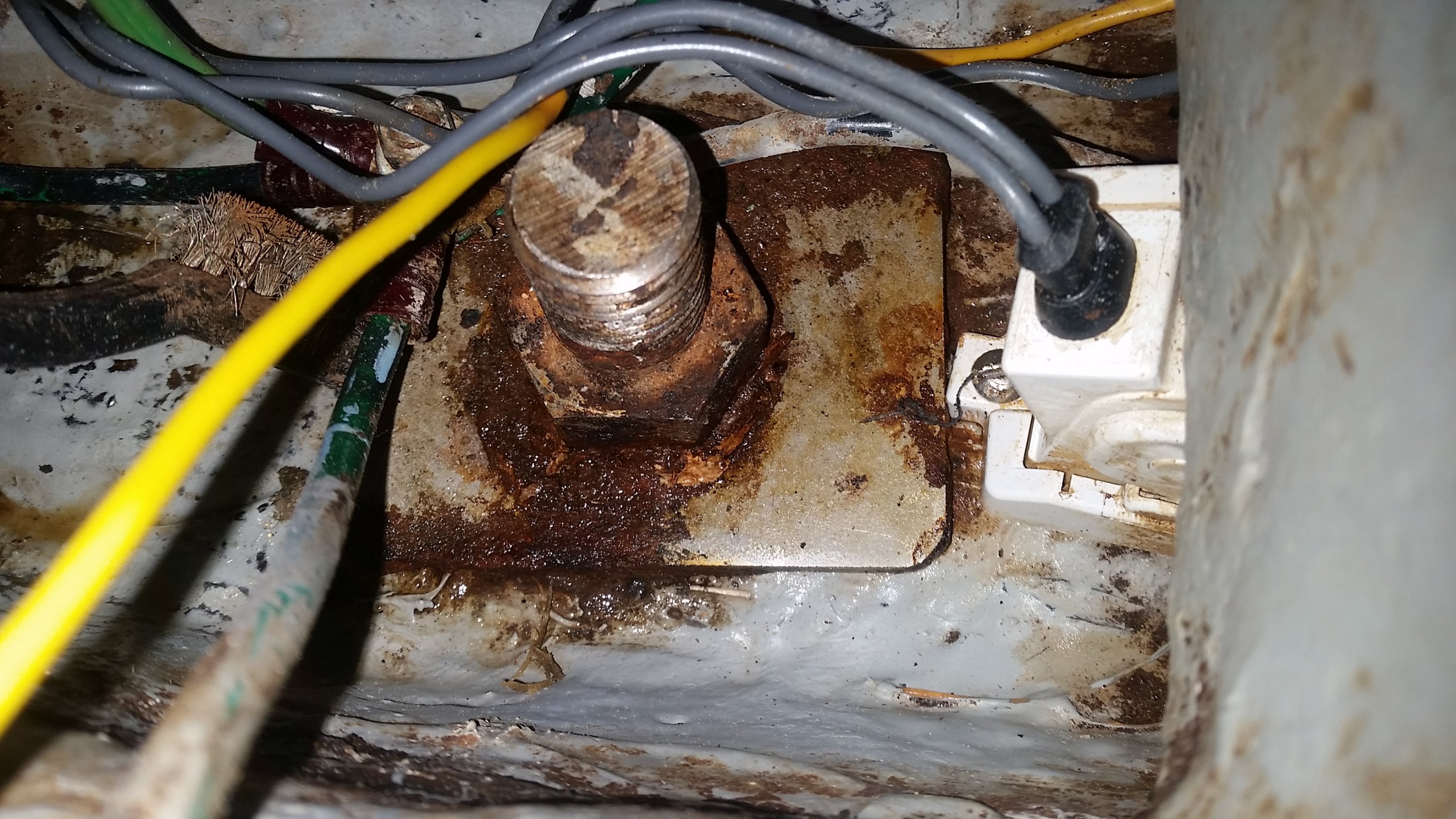

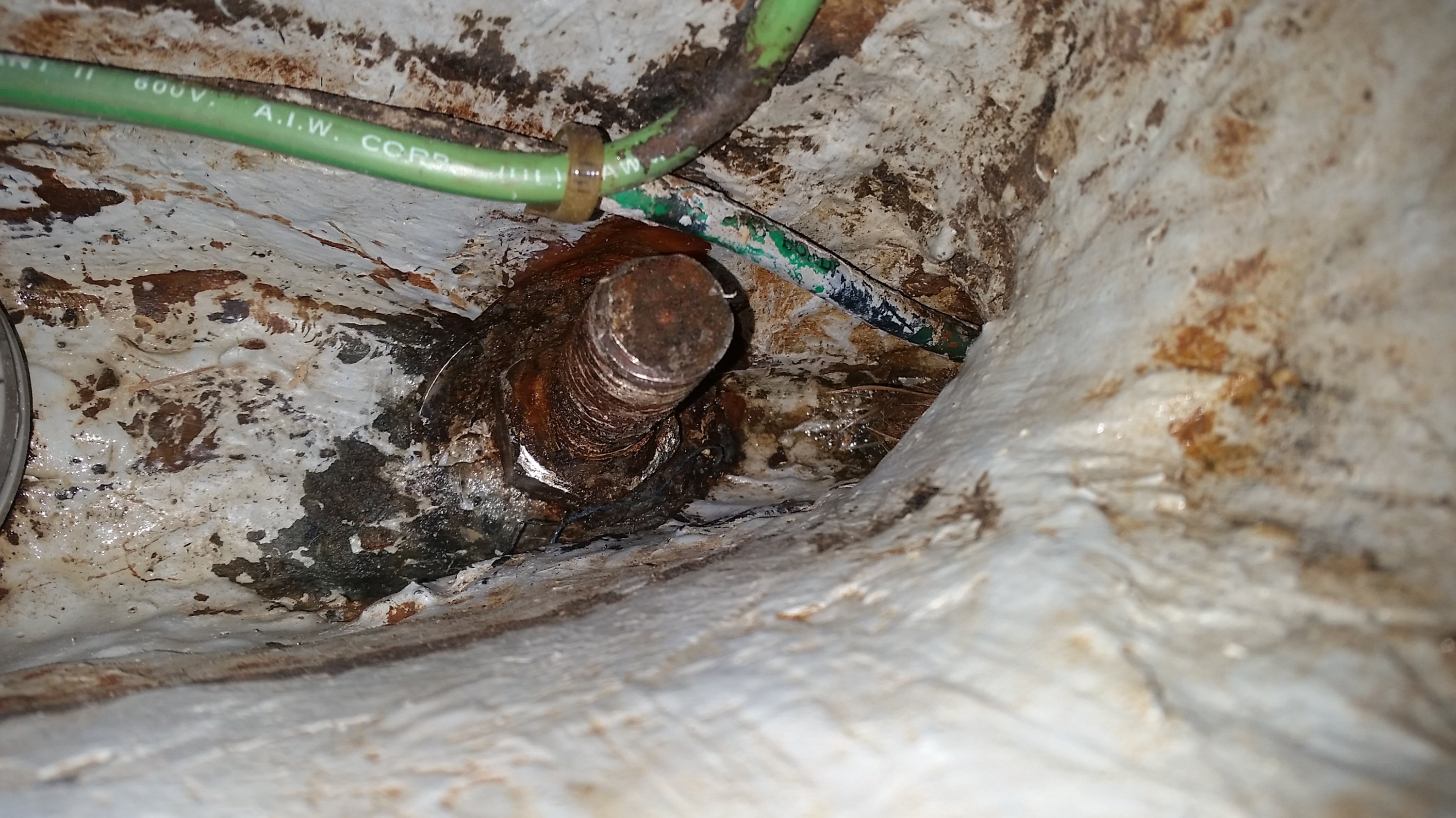

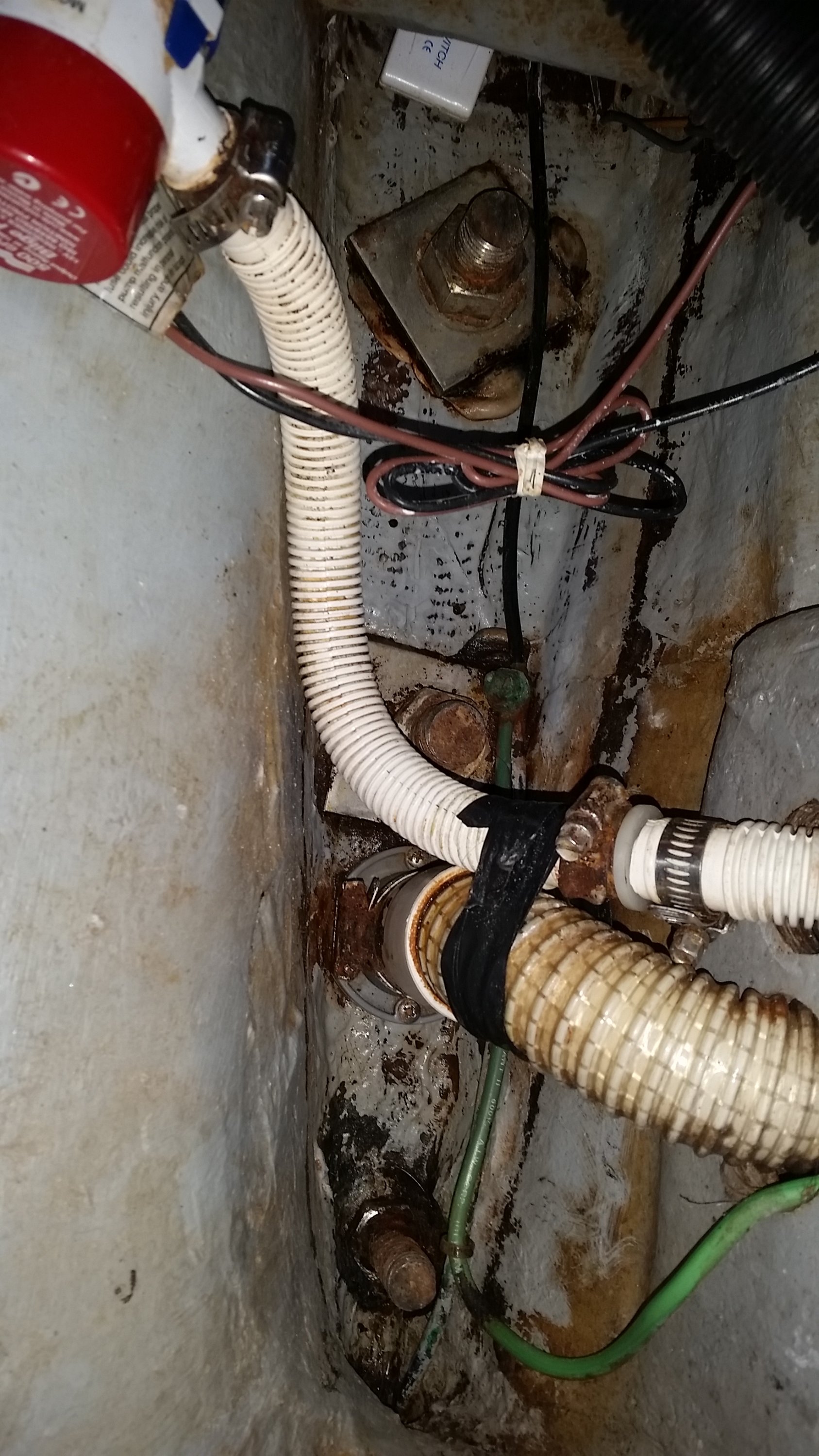

Hi, first time post of question on here, im looking at and got an offer on a 87 322 so far as i have inspected its in pretty good shape but the only info i can see is from 10 years ago, it has 4 keel bolts but the aft one that only has washers on looks like the washer has completly corroded,
The other 3 have 3"×3"plates under them i wondered if they were standard or if they were replaced, i have heard stories of the later models having really thin fibreglass where the keel joins under the bilge area looking at the title i think the hull is number 17 anyone have any experience with this or can offer any advice? Im getting it surveyed in a few days time

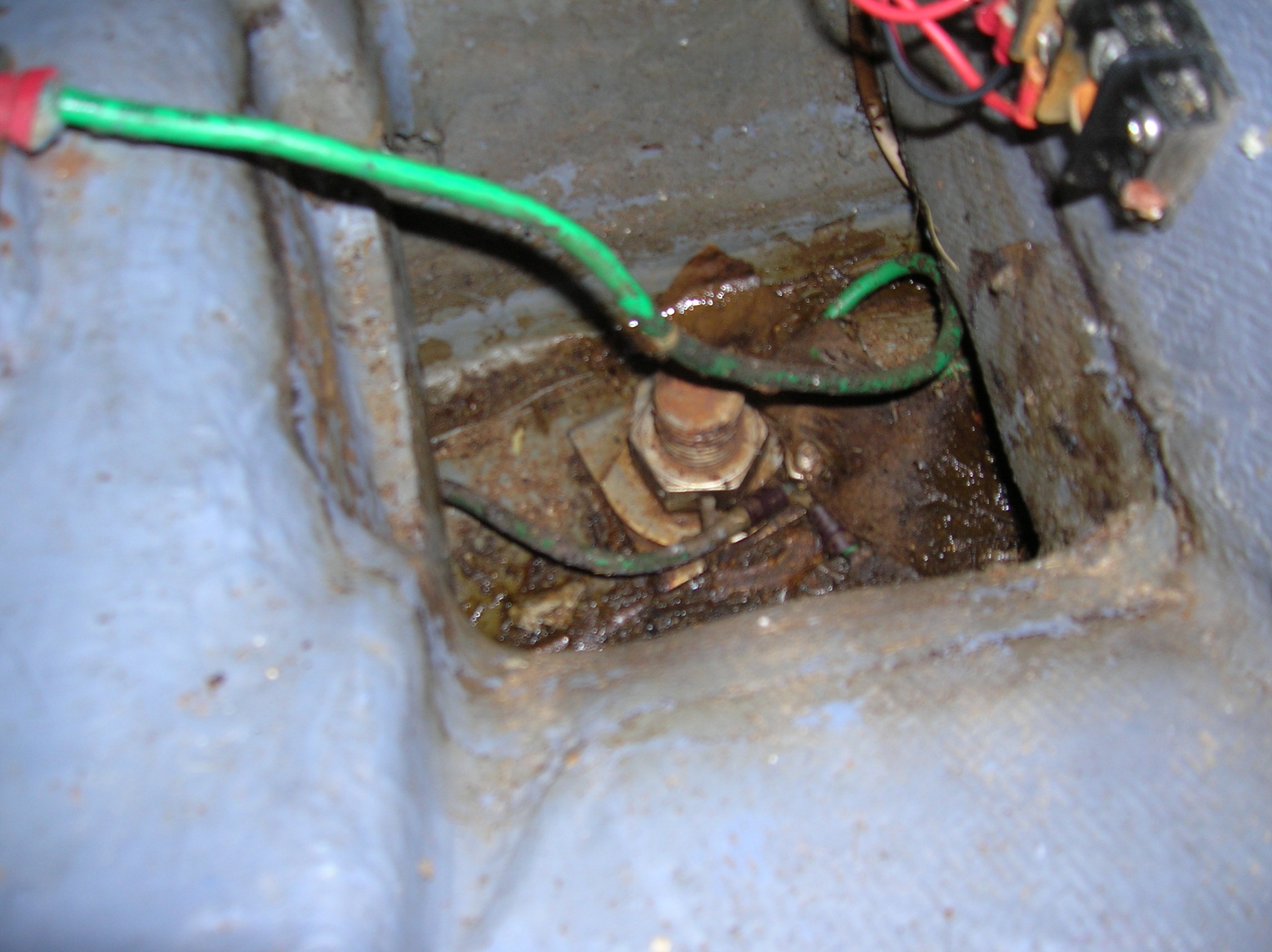

Lots of information about the keel joint in various posts on the site. I have not dropped the keel on my 1988 built O'Day 322.
As far as the keel bolts, yours look like mine. Same plates on mine. The aft bolt is smaller diameter than the other 3, and mine only has washers.

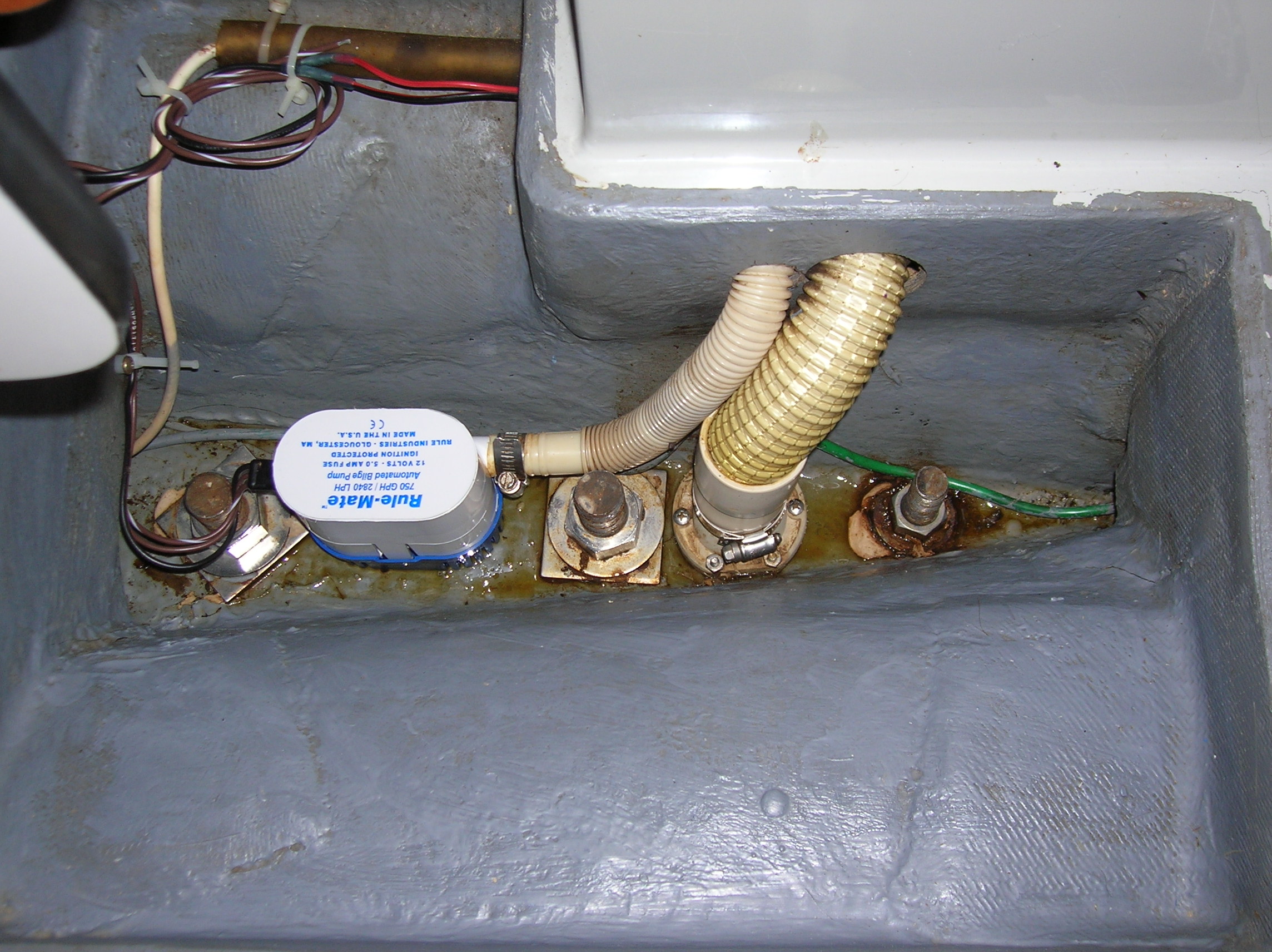

Hi there,
I think I might have posted this picture somewhere else on the site at some point, but here it is .
Yes, those washer plates are the original build, as you say there are four bolts, three square and one round (not enough space for a square).
