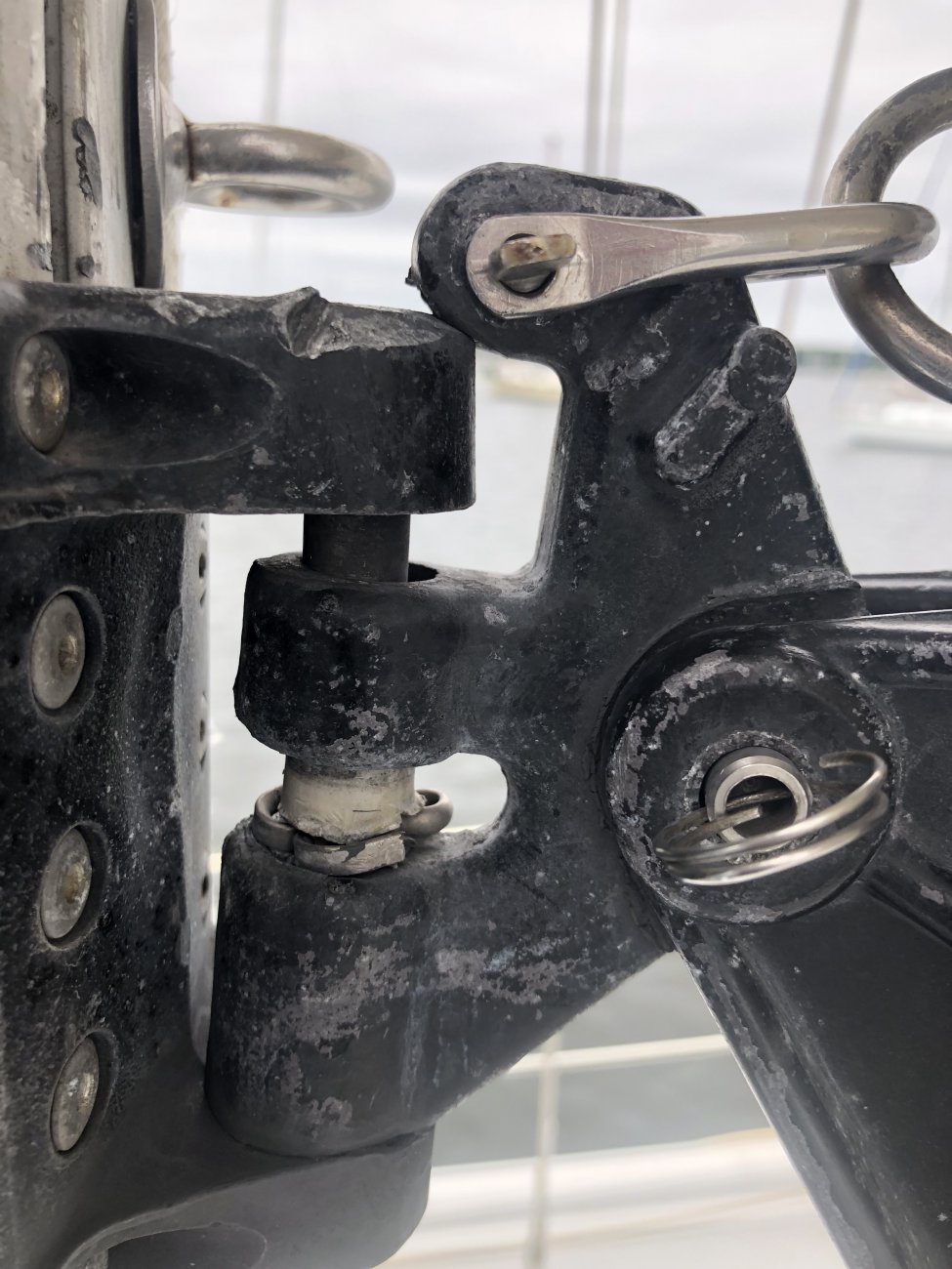

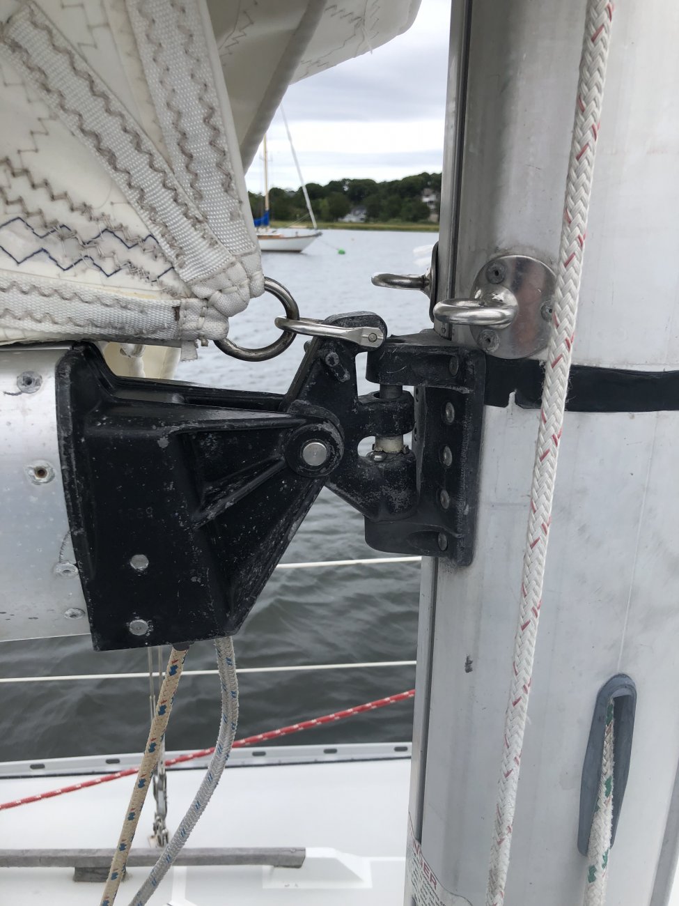

Was looking at my gooseneck the other day (Z-Spar, O'Day 322) and was wondering if I had a problem. It seems to me that there's a spacer on the vertical portion on the left that may have slipped downward and is now creating an angle and a possible stress point. Any thoughts? Should the piece laying on the cotter pin be up another 1/2" or so?

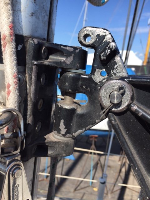

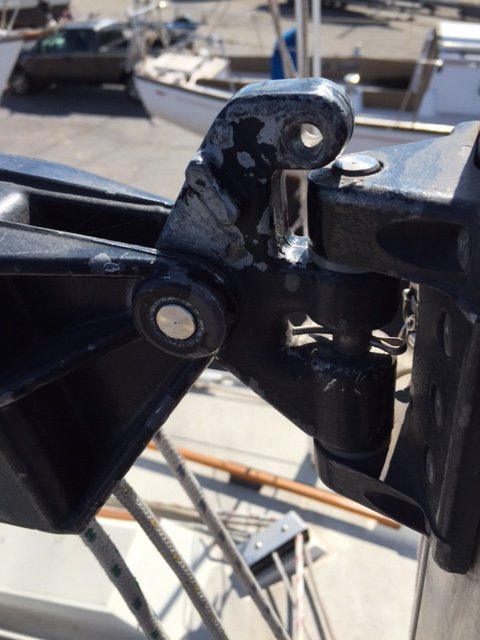

Mine looks a bit different...
Since these pix were taken, I added a reefing hook in the top whole.

Mickstr:
From the pics it looks like you're missing the spacer/nylon(?)bushing that Tally Ho has under the gooseneck. That would raise the gooseneck I think. (Looks like you also are missing the top spacer/bushing that Tally Ho has on his.

Hi Mickstr,
My gooseneck looked exactly like yours. I put a couple of stainless steel washers under the boom portion (similar to the bushing Tally Ho shows on his rig), which lifted up the boom portion an 1/8th inch or so and stopped the rubbing on the top and bottom.

SS might cause corrosion with the Aluminum. I think some Delrin would be better?

I agree the possibly the missing spacer you note is the culprit....I'm going to the lake tomorrow and will take a look at mine at the goose neck....this trip assumes it will be warmer tomorrow....it is windy and frigid today. .
