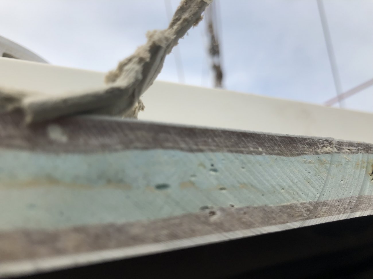

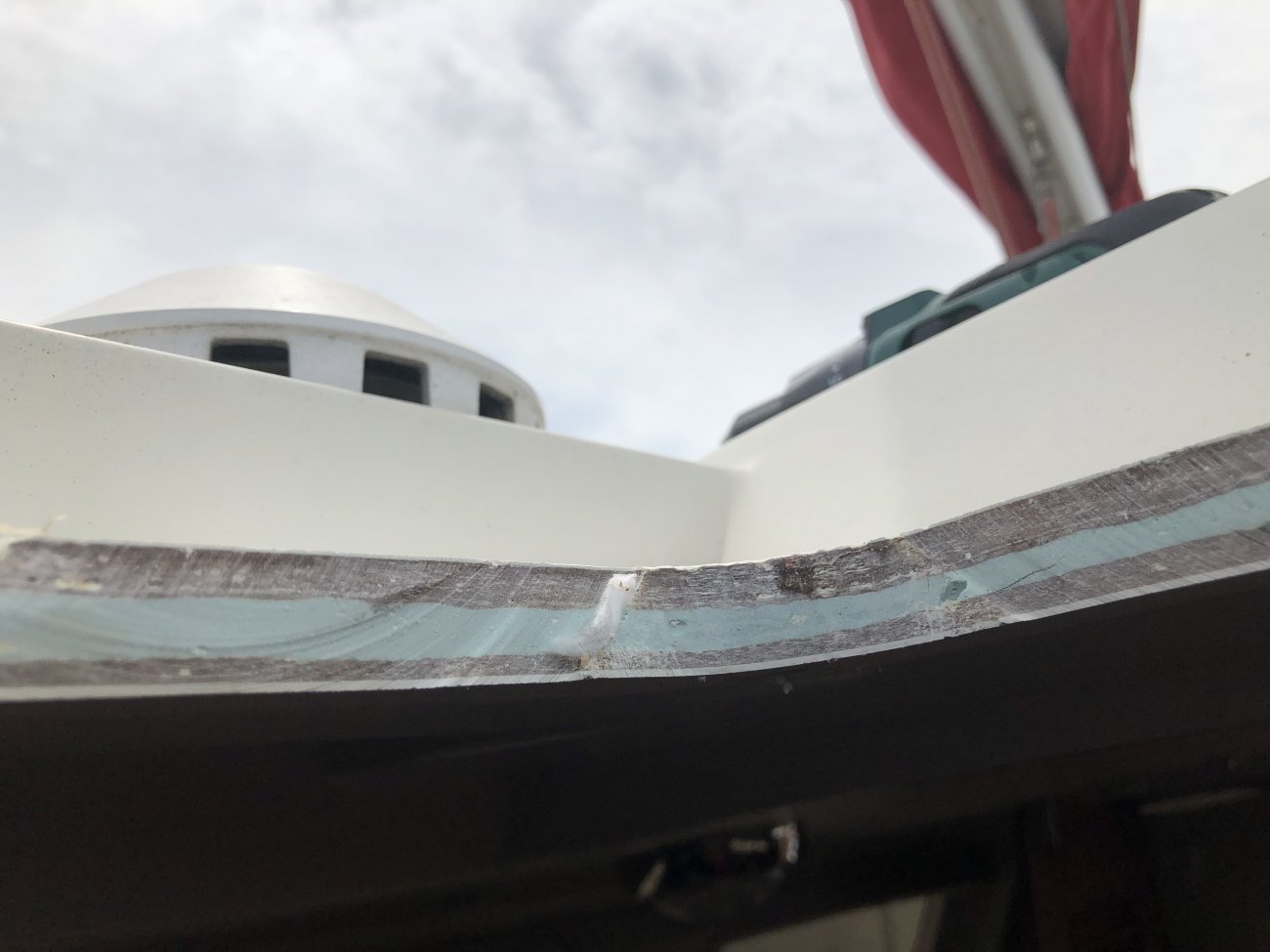

I pulled my salon hatch today to rebed it (work day instead of sail day today :-(.
Here is what the composite sandwich looks:
You can see the top layer of gel coat and fiberglass, then a layer of some sort of foam in the middle and then the bottom layer of glass gel coat (or whatever dresses up the inside liner).

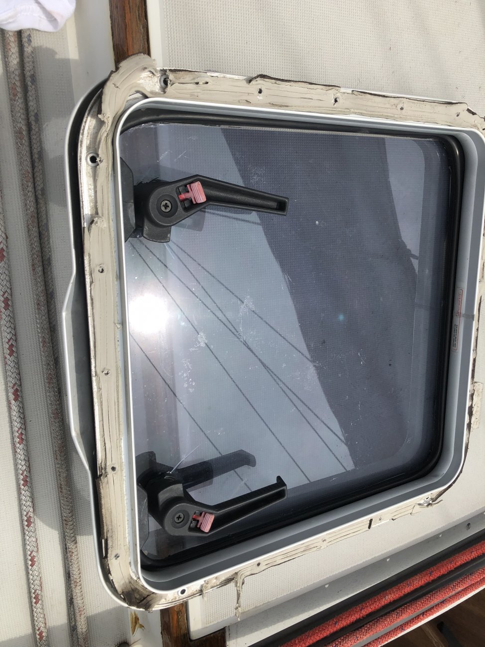

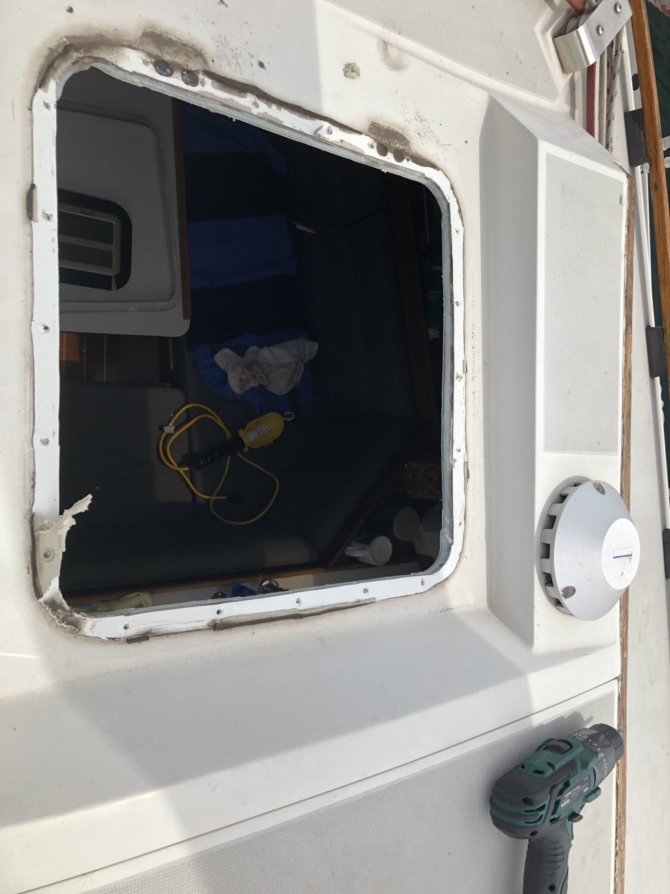

Rebed with butyl tape. Hopefully that seals her up.
She was bed with butyl, but not a great job.
Will see after tonight’s rain!

Just a note to say “no water in the cabin”!
When I was out at the boat on a Friday, no water on the table and the bilge was dry....
So hopefully that means I did a decent job on the hatch rebed.
Will try the front hatch next time I have a work day at the marina.
