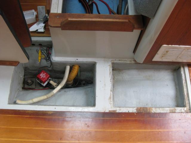

Oday 322 Bohemia River MD
I will take a couple pictures of the floor panels on my boat. The small panel roughly 1ftx2ft fwd of the roughly 3ftx6ftgalley/companionway panel which is on the centerline of the boat does not open to an area with the bilge hose. there is a small well under that panel which drains into the bilge but that is all. The bilge hose exits the bilge area to the starboard side about even with the rear keel beam bolt. it appears to travel under the battery shelf (which does not look removable) and then apparently under the galley sink and is next seen on the port side of the engine travelling to stern.
