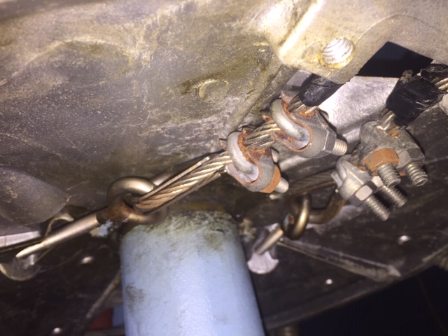

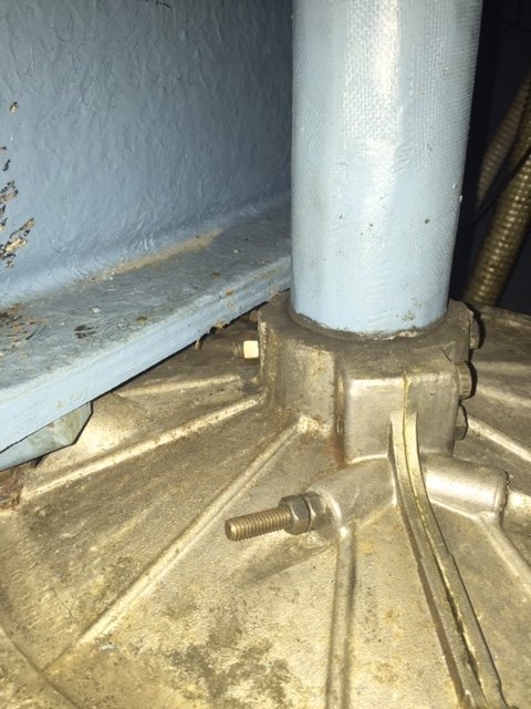

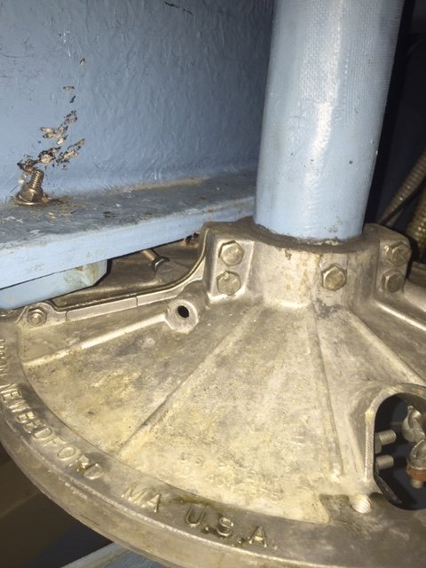

Thank you for the reply. I did what you suggested and my wife worked the wheel while I looked for anything to be tightened. As you can see from my pics, my OD has a different configuration. I have a large 'flywheel' and the single bolt holding the rudder post on. You were also right about the play'; an 1/8 - 1/4 inch play is yeilding a two inch play in the wheel. I clearly detemined that the play is internal, that is either the through hole in the rudder post has worn a bit larger over time, or the through bolt has worn down for the same reason. Previous posts indicate the through bolt is the only thing holding the rudder on. I'm reluctant to try to partically slide out the bolt while sliding a new one in from the other side while it's in the water. Any last thoughts?
