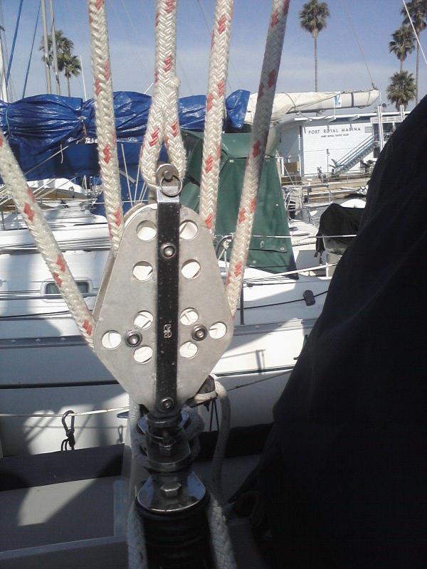

I removed my main sheet on newly purchased ODay 31 to clean it. Now don't know how to route it.
There are 3 blocks on the boom and a triple block on the traveler. But I do not see how to route the main sheet using more than 2 of the 3 pulleys at the traveler. Also the main sheet emerges from the traveler too high to turn on the deck mounted winch efficiently.
Here is a pic from my 31. Hope it helps. If it looks the same as yours but you still have problems let me know and I'll explain where the lines run.
