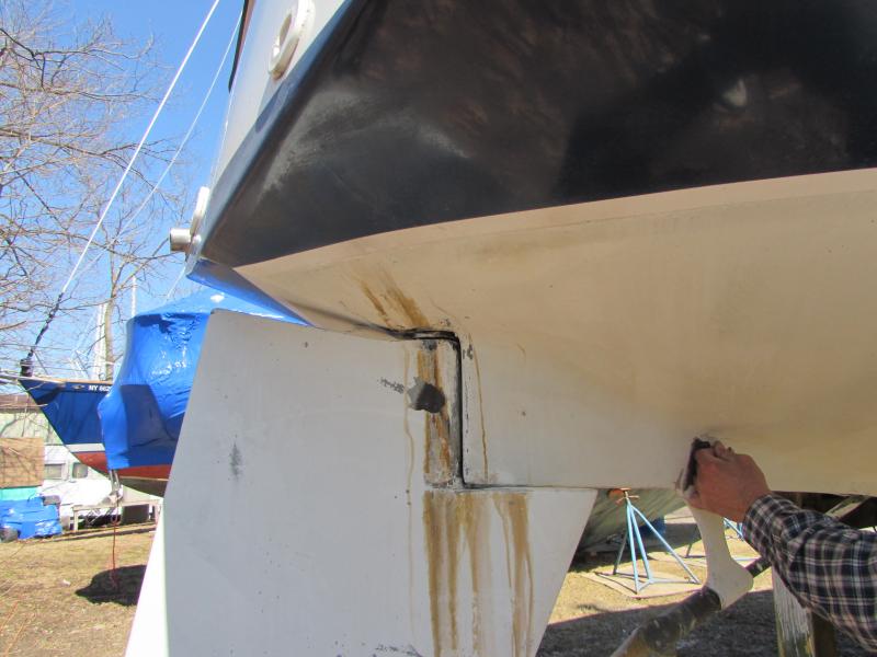

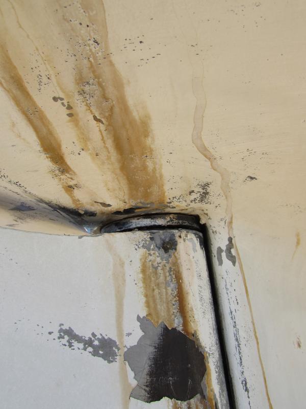

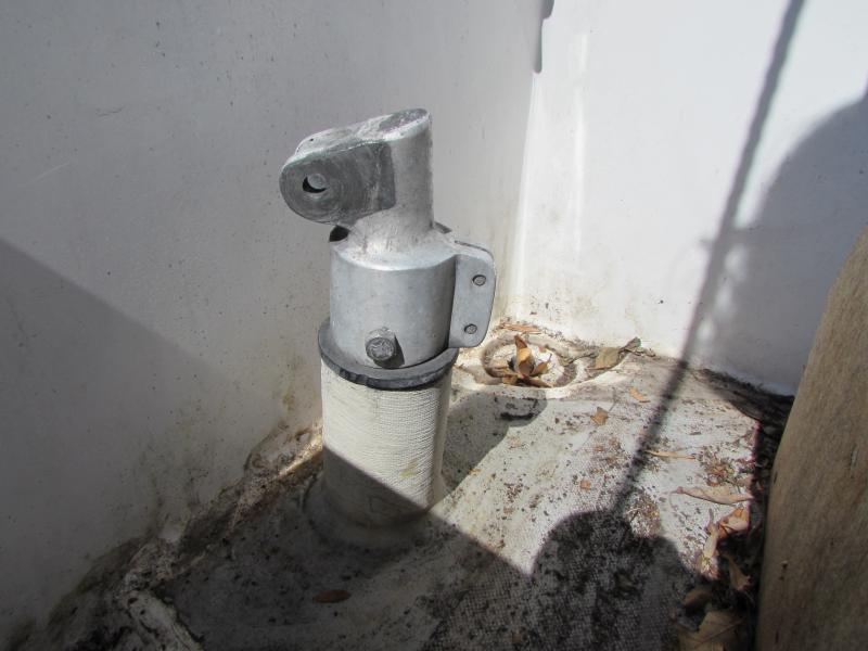

OK Apex here we go. There are two delrin spacers, one at the top under the rudder head and one at the bottom between the hull and rudder. Ideally they should not allow for any play up and down in the rudder. Good luck with that. The more critical spacer is the bottom one. This prevents the rudder from rising up to contact the hull. So here are some pictures to better understand the setup. Not a bad little project actually.
