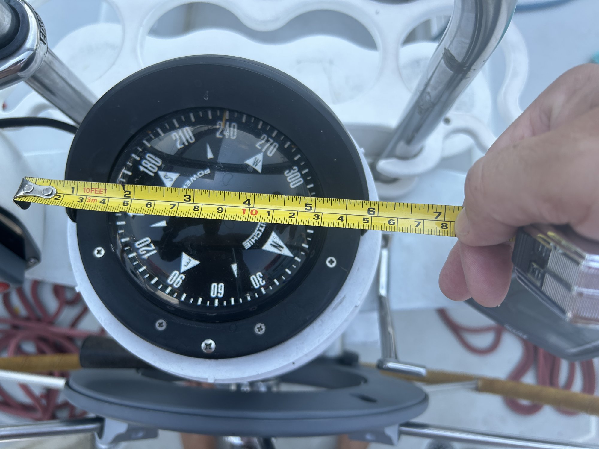

I necked the size of the Ritchie Powerdamp on my O’Day 322, and is about 6” diameter, 20” circumference.
a bit hard to measure In place due to the bubble… and as I look at the Ritchie units, I am not sure what exactly they measure…the entire compass housing or just the “card”.
There are only 3 screws that hold it on the binnacle, so you should be able to remove those, pull the compass and check for an ID tag.

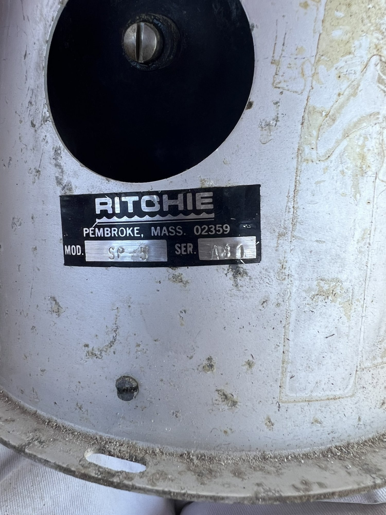

Pulled mine off my 1981 O'Day 34. It's a model SP-5, serial # A81which is a 5" Globemaster. The screw above the label is where oil is put in. Richie sells the oil for it on their site and can supply several smaller seals, but you have to call to get the seals ordered.
