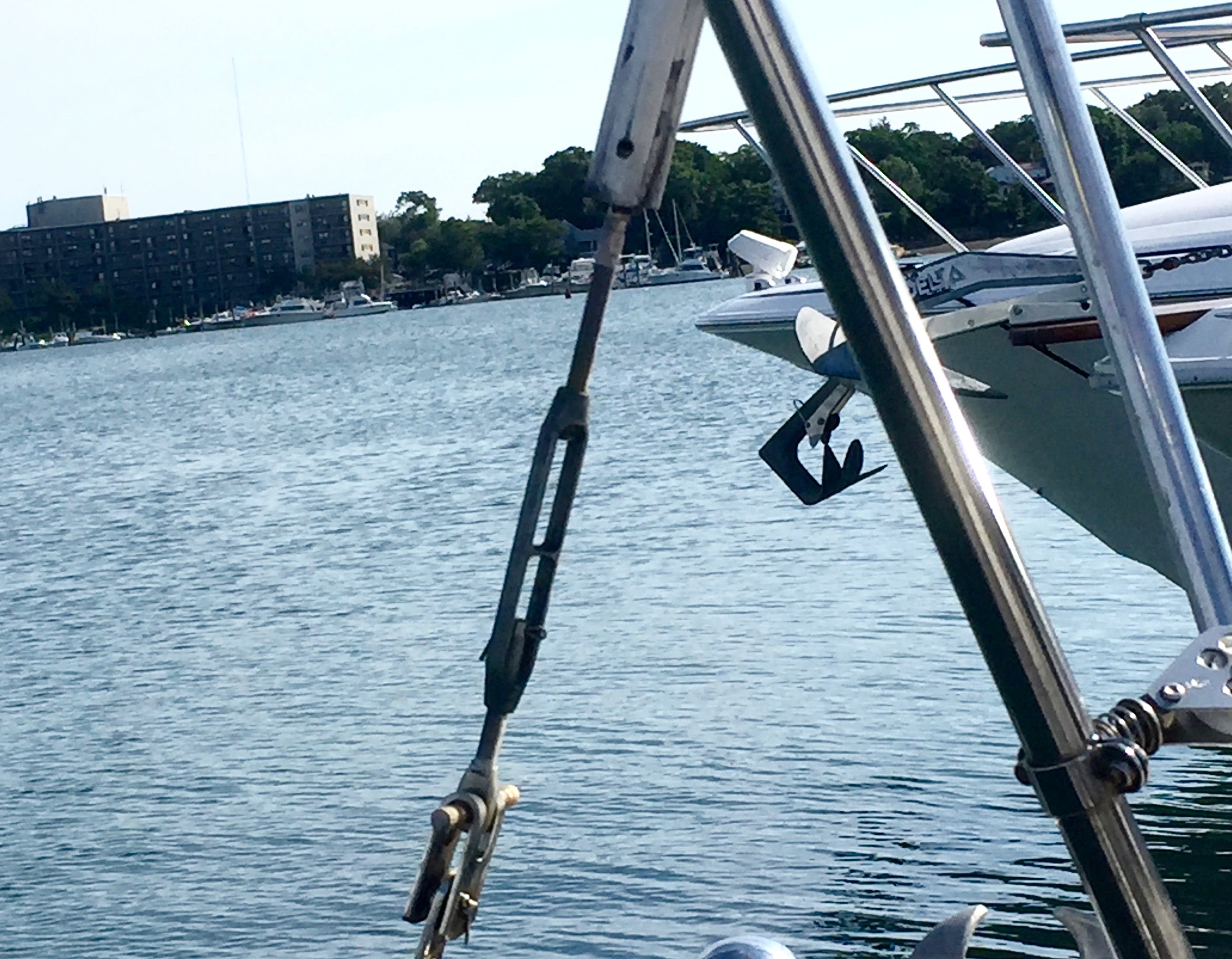

So my new rigger figured out the problem.
As you will see in the picture the barring was jammed on to the swedge and the set screws were tightened into the barring tightening it to the swedge. As you can see the turnbuckle had barely any thread left and had I sailed off as is and unfurled my Genoa 130 It would have come out of the turnbuckle and the mast would have lost all forward support.
The repair was easy. He persuaded the Profurl Up. Got out the twisted barring. Replaced it ($30.00 part) and Voila! my Profurl was moving freely again :)
24,708
Good for you. Sounds like you may have been turning the turnbuckle not just the furler.
Fair sailing.

Yes.
Could have had a serious problem had it come free.
Chris
