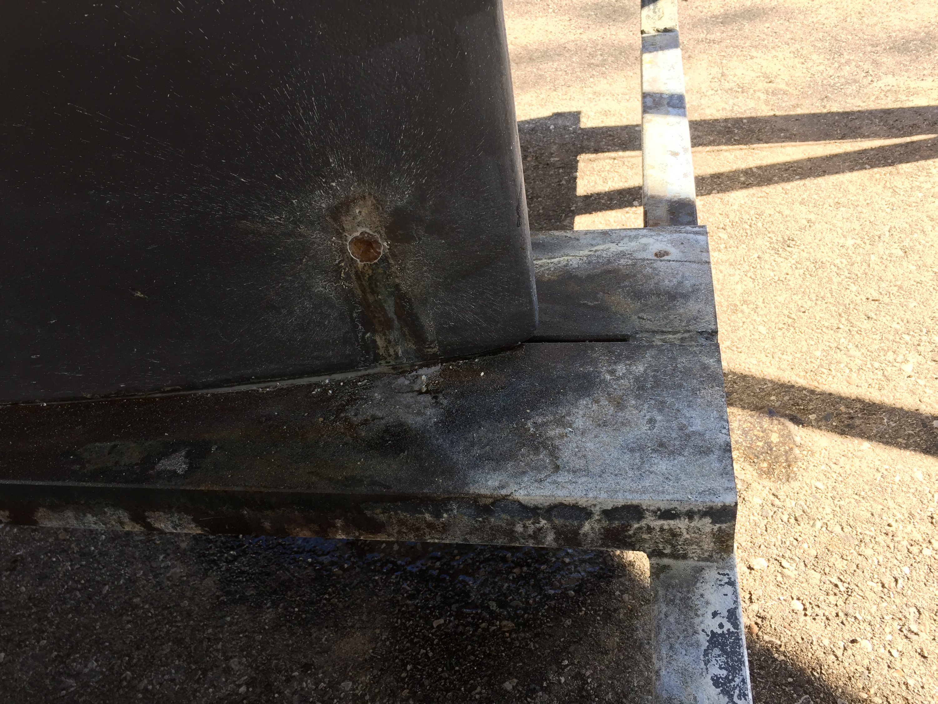

Does anyone know how the encapsulated keel on the O'Day 28 is made? Is it random chunks of lead in a hollow fiberglass shell or lead shot encapsulated in epoxy? I have a small crack on the lower portion of my keel, about 1/2" long that is weeping water and feels kind of oily.

Yes, mine is a 1981 model. The keel is part of the hull layup with no keel to hull joint. This past spring when I painted the bottom for the summer I noticed the leak but didn't have time to address it. It had an effervescent like material sort of like that which builds up on a battery post. It was easily wiped off with my finger and crushed into a sand like consistency. My boat is in fresh water, Lake Michigan. Because the material at the site appeared over the winter with the boat out of the water I don't think it's anything electrical but either the lead reacting with water inside the keel or maybe a blister although there is no bump or lump.

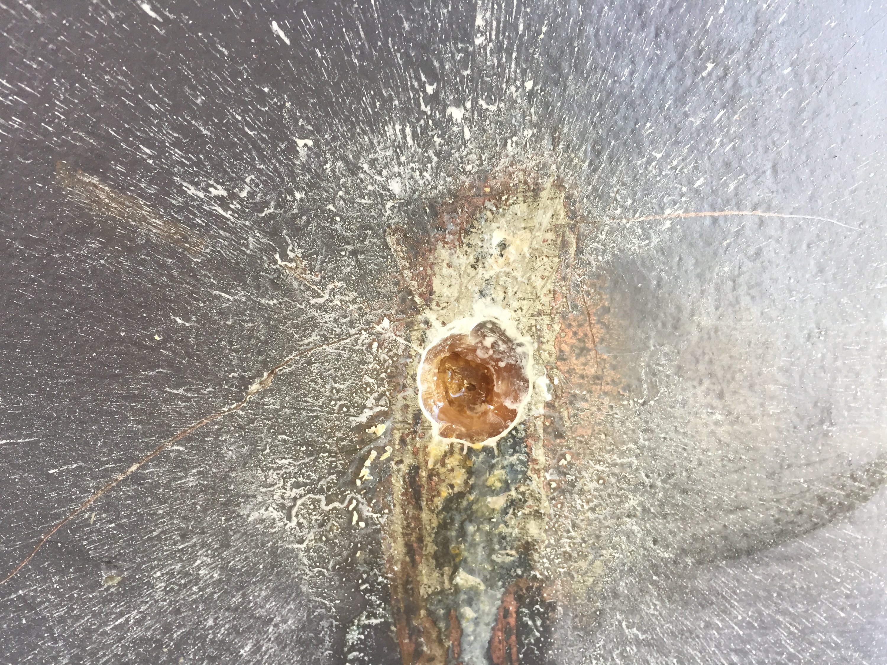

This is why I was asking about the makeup of the keel. This has been ground out to the size of a quarter with a Dremmel. About a quarter cup of liquid came out so there is a substantial void in there. There was no bubble or bulge so I'm not sure if it was caused by osmosis or if there is water inside the keel. Any ideas or suggestions would be appreciated. Oh, those aren't cracks radiating from the hole, they're scratches.

cleanup, and leave open for the winter. Re-clean in the spring and monitor it is completely dry, then patch it back up with thickened epoxy, barrier then anti-fouling coats.
If that much came out, open a similar hole lower, and inspect the bilge and exterior of the keel for any areas water can get in.

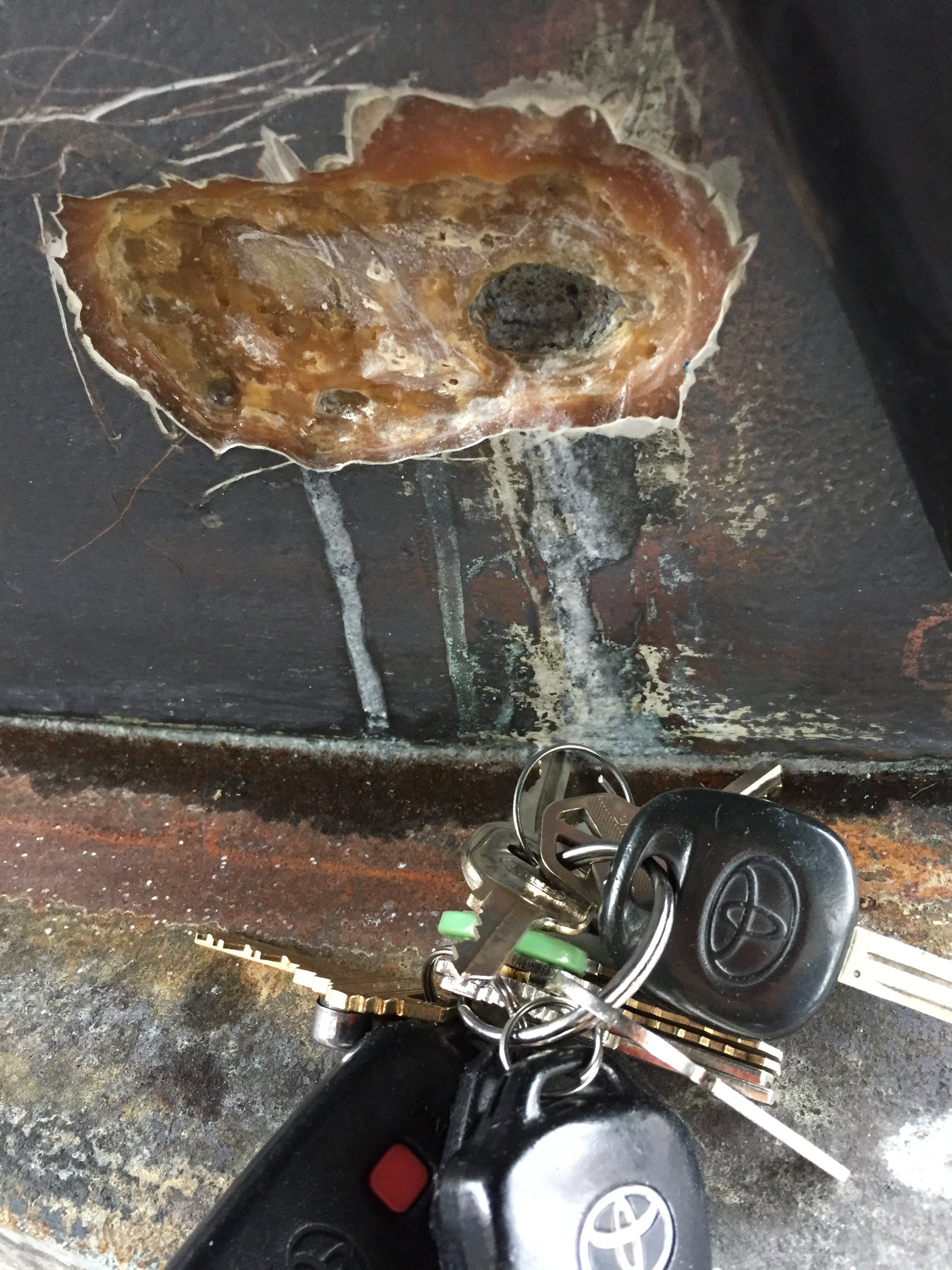

This is where I am with the removal of the blister and surrounding delamination. Keys are there for scale. It's still oozing a watery kind of slick liquid, not water or maybe water with something else mixed in. I have found a gray aggregate as seen in the darkened area. It looks like cement or at least sand in some kind of binder. So I'll let it sit until March or April and hope it's dry by then.

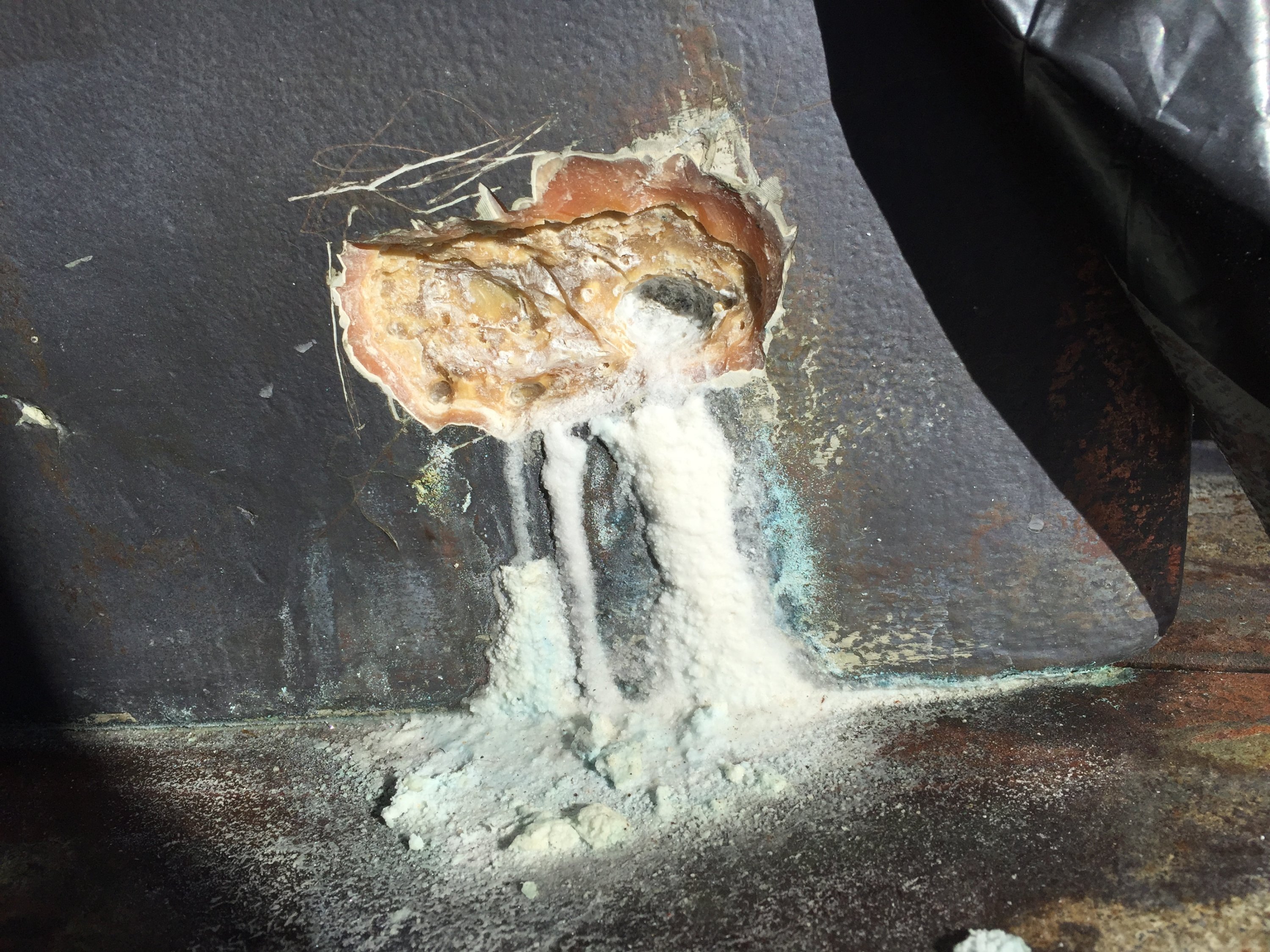

This "blister" that I opened last spring is still slowly seeping the oily liquid and it dries into the white powdery matter seen in the photo. I have been washing out the cavity with acetone regularly this winter and the build up you see is over one months time. I'm going to give it another 3 weeks then wash it out again then try to seal it with a coat of epoxy before I re-glass it. Any ideas at all what this is? Is this normal for an osmotic blister?

Maybe it's salt? If it was salt water inside the keel you might have had a build up of salt over many years as water went in then dried leaving the salt behind? Was the boat always in fresh water I see you are in Mi?

I don't think it's salt. The boat has been used in Lake Michigan for the last 23 years and I don't know prior to that. I'll send you some of the white powdery substance if you can find someone to taste it ;-) I'm at a loss.

VERY common boatbuilding practice was to throw whatever they had on hand in there and then epoxy it up. Lead if have it, but if you run out, iron, then bricks.

put some in hot water and stir, see if it dissolves. Maybe it is sand as per JackDaws suggestion. They might have thrown chunks of metal in there like ingots and then used sand to fill all the gaps so it doesn't rattle around then sealed it all up. Sand would be a lot cheaper than resin to fill the gaps and probably denser.

I did that. It dissolves in water. In fact, when it seeps out it is an oily clear liquid and the white powder is what is left after more and more comes out and dries and it builds up like a stalagmite.

Take a sample to your local mass spectrometer and see what it is. Otherwise you can guess until the cows come home. A local university might be able to test it for you, might cost you a donation to the school.

I have completed the repair, faired the keel and applied antifouling paint. I think that my keel is not a solid mass composed of lead and fiberglass and resin but full of tiny channels and spaces sort of like marbles in a jar because it leaked liquid all winter and that liquid did not freeze and there must have been at least a quart. When the boat was put away last fall there was about an inch of water in the bilge and I put some RV antifreeze in there when winterizing the head. Today I checked my bilge and found it dry. The pump, float switch and manual pump pickup were attached with 1" screws into fiberglass with no sealant. I'm now wondering if all that liquid that drained from the keel came from the bilge. In any case, next fall I'm going to make a small opening to see if I get any more liquid out.
