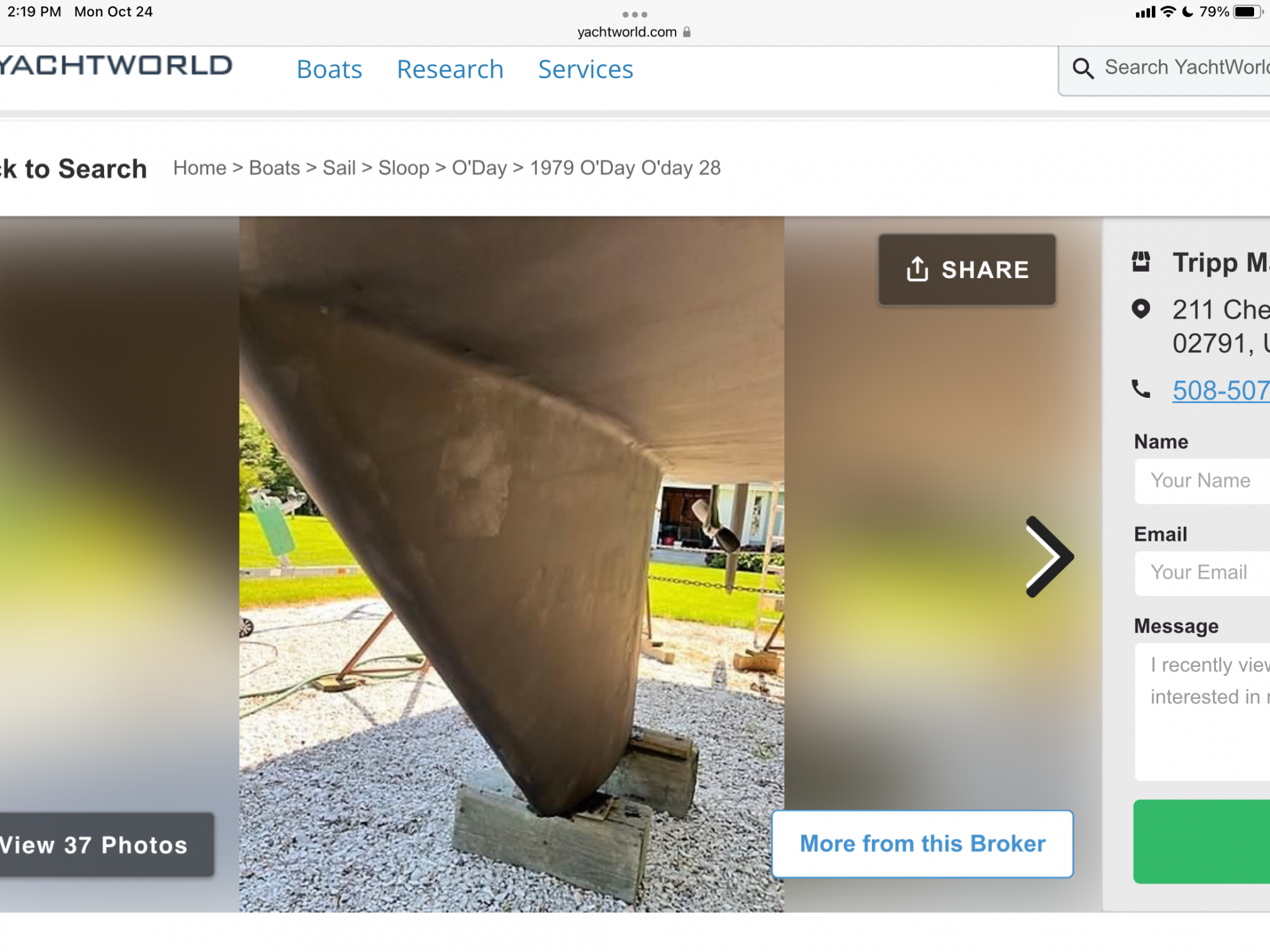

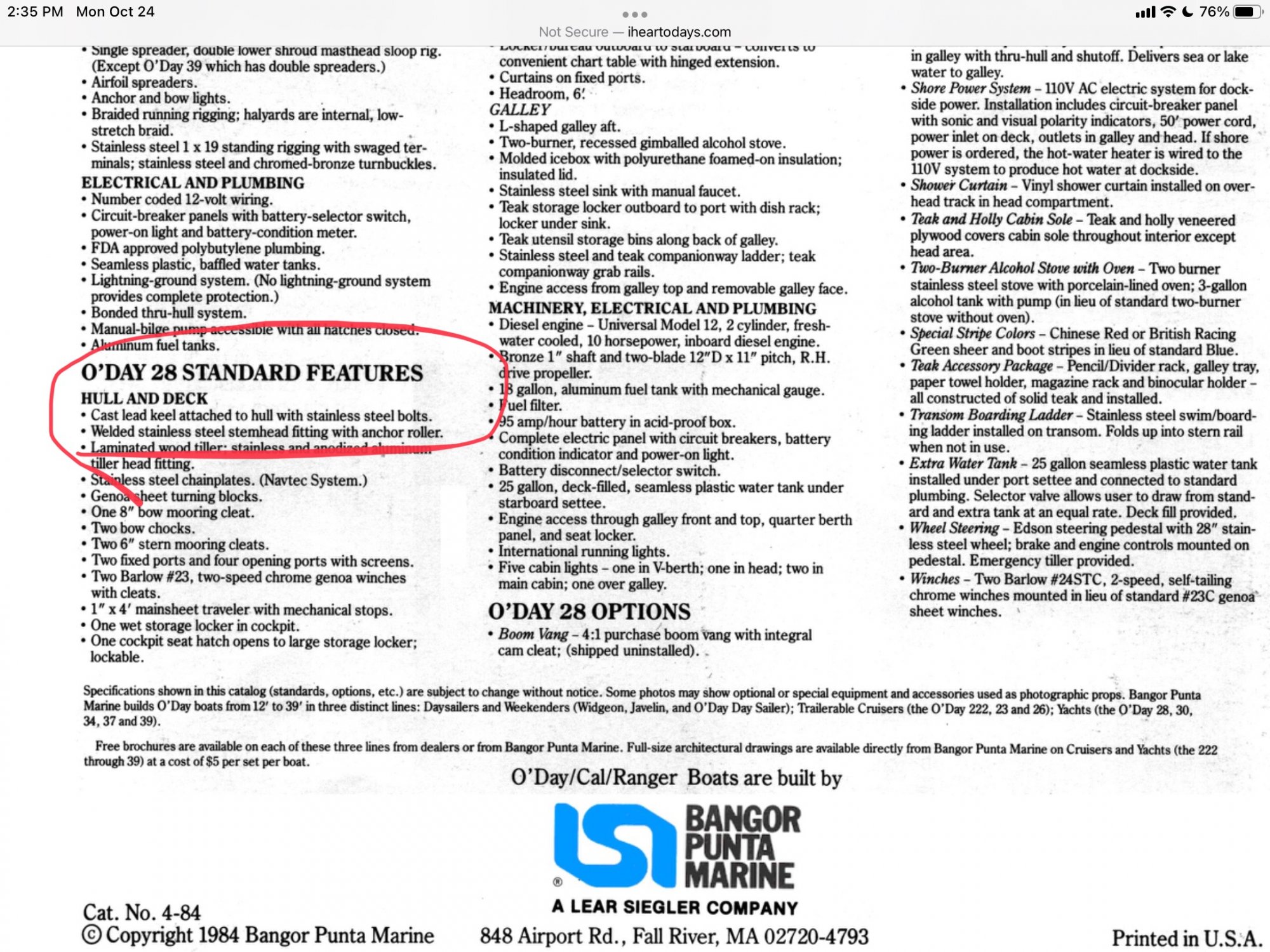

If it wasn’t for the lack of keel bolts, I would say that you don’t have an encapsulated keel. But with no visible keel bolts, it makes me wonder.
I searched the inter webs and found some photos of another 1979 O’Day 28, which look similar to the OP’s photos.
then I found this brochure on IHeartodays.com
It calls out a lead keel attached with SST bolts…
I am having a hard time confirming one or the other ;-(

Greg, I think they switched to an attached lead keel in the early 80's, prior to that is was encapsulated. The brochure has a 1984 copyright.

Safe to say, then, as a '78 model he's looking at an encapsulated keel. The smooth keel surface with no sign of a joint (after all this time) would bear that out along with the recent (excellent) research by others...
That does, though, make the 'wiggle' more of a mystery.... Presuming the boat yard guy had it right....
