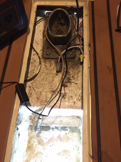

Post some photos of the keel joint, keel bolts, and the bilge when you get a chance.
4” of play sure seems like a lot, and you should see something moving in the keel joint.

This doesn’t look like an encapsulated keel to me…
Maybe the OP has a centerboard version, and the board is moving 4“ laterally….that would make a whole lot more sense.
Still waiting for some photos…that would tell us a lot. Until then, we are just speculating.

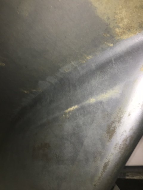

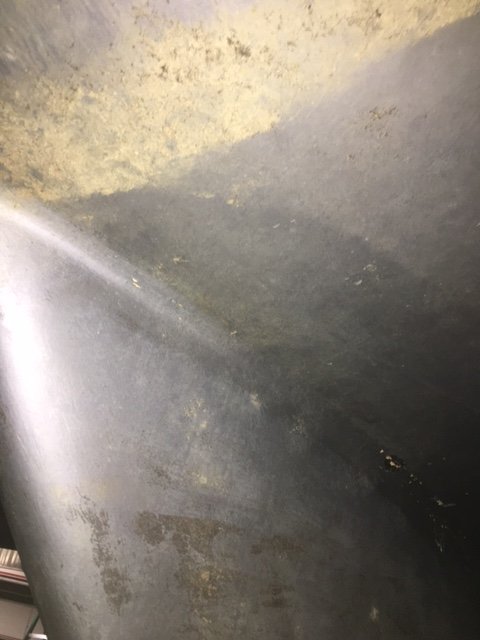

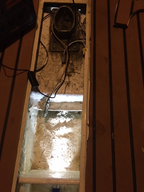

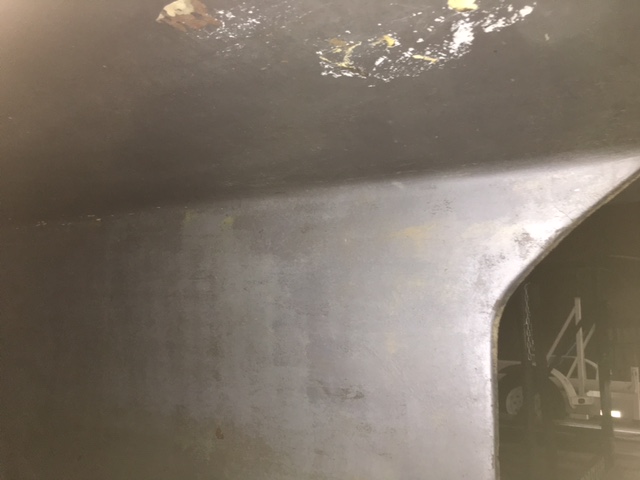

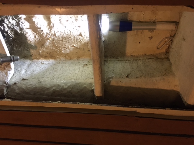

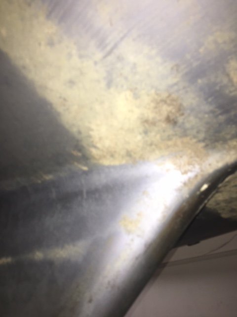

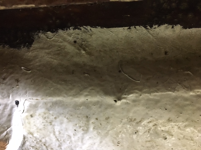

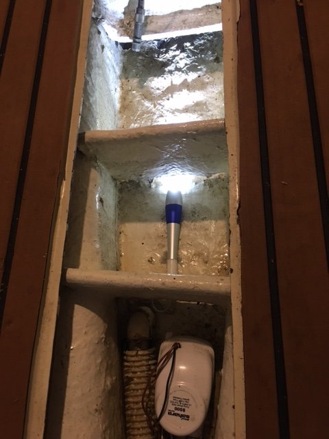

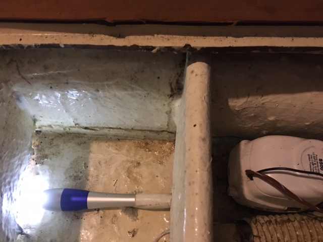

Hi Greg,
Thanks for asking me to get some pictures! It was a beautiful day to see fall colors, so I drove up just to get some pictures for your post. If the attached photos are not enough, I'll go get some better ones of anything you suggest. We're stored indoors, but it's an hour's drive one-way.
I tried to find keel bolts, but there are none visible. A nice fellow with a 33' boat next to me let me take a look at how his keel is mounted. With 12 large bolts and a lot of structure, I could clearly see mine is nothing like his.
While there today, I looked very closely for stress cracks and signs of a hull breach, and I tap-tested for hollow sounds. Aside from a few touch-up paint spots, there is nothing notable. The bilge stays dry when we're in the water and I rarely have to pump bilge water out.
I'm going to talk to my marina guy to get a better definition of what they observed. I was in too much shock to ask whether it was it 4" of total movement, or was it 4" in each direction. I also need to ask how hard they had to push to make it move. It's not on the sling now, so I can't easily repeat the test they did.

I don't see any bolts at all. Unless I don't know what I'm looking for - I searched very closely - there are none. I can't imagine supporting a 2500lb piece of lead with nothing but fiberglass, so I really hope I am just missing something.
