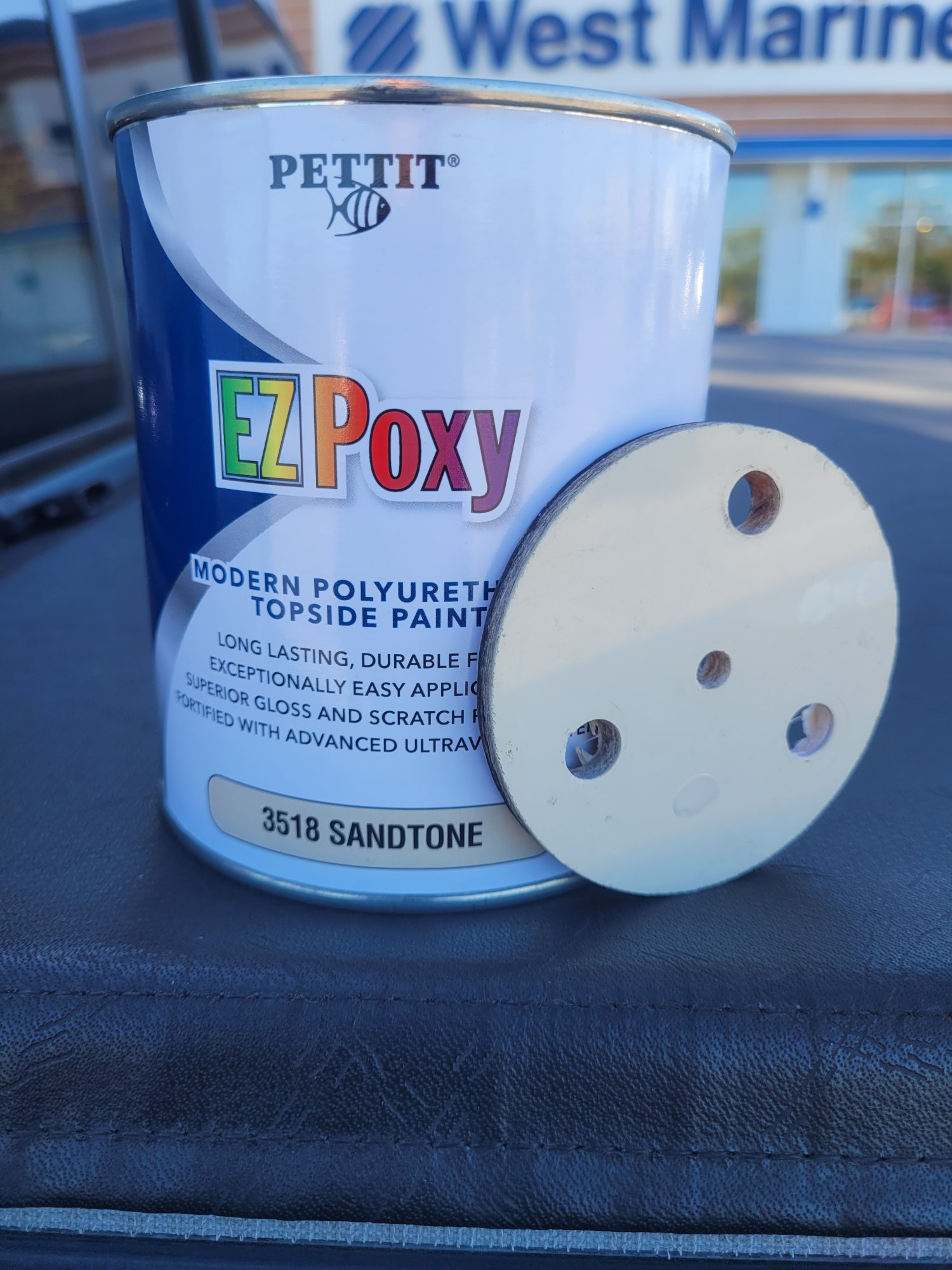

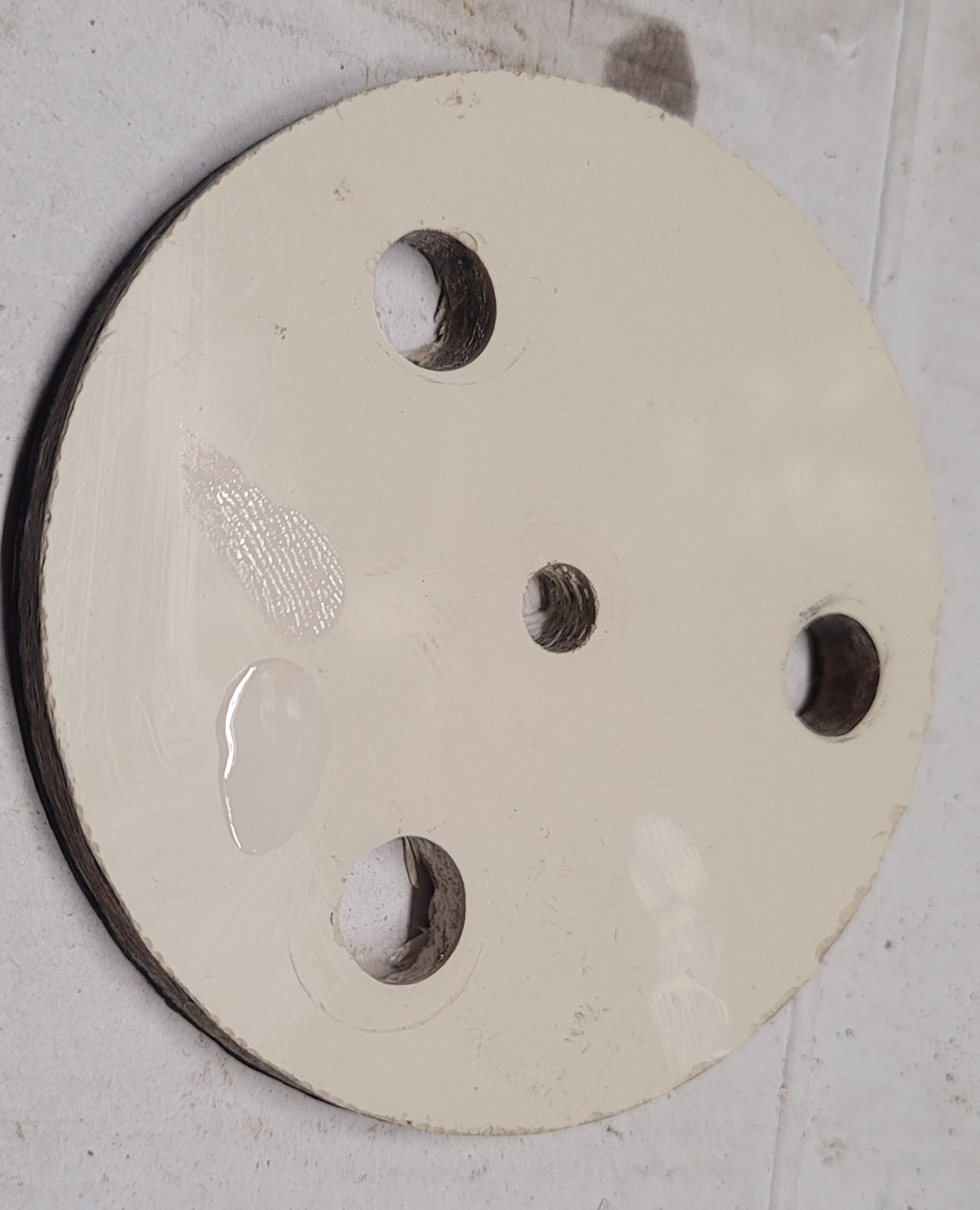

I have a piece of scrap that O'day kindly left in my hull. I believe that this was a cutout for a bow pulpit base in the inner hull liner. I found this piece of scrap when I rebedded the pulpit and added G10 backing plates.
I brought it to my local West Marine and did a color test with the scrap piece. Here is the closest EZ-poxy that I could find. The two colors shown are Hatteras Cream (at 2:00) and Sandtone (at 6:00). I chose Sandtone.
I still wasn't happy with it, because it seemed to be a little bit dark to my eye. I therefore added some white tint from a gelcoat tinting kit that I have to a small sample of Sandtone and placed a drop of this mix next to the straight Sandtone (with my fingerprint in it).
I think that I'm there...:beer:

My pic above was taken shortly after I tried mixing and applying the paint. The paint was still wet at the time, and it is STILL tacky this morning!:rolleyes: I guess that the optimal color may be a mix of Sandtone and a "whiter" color...
