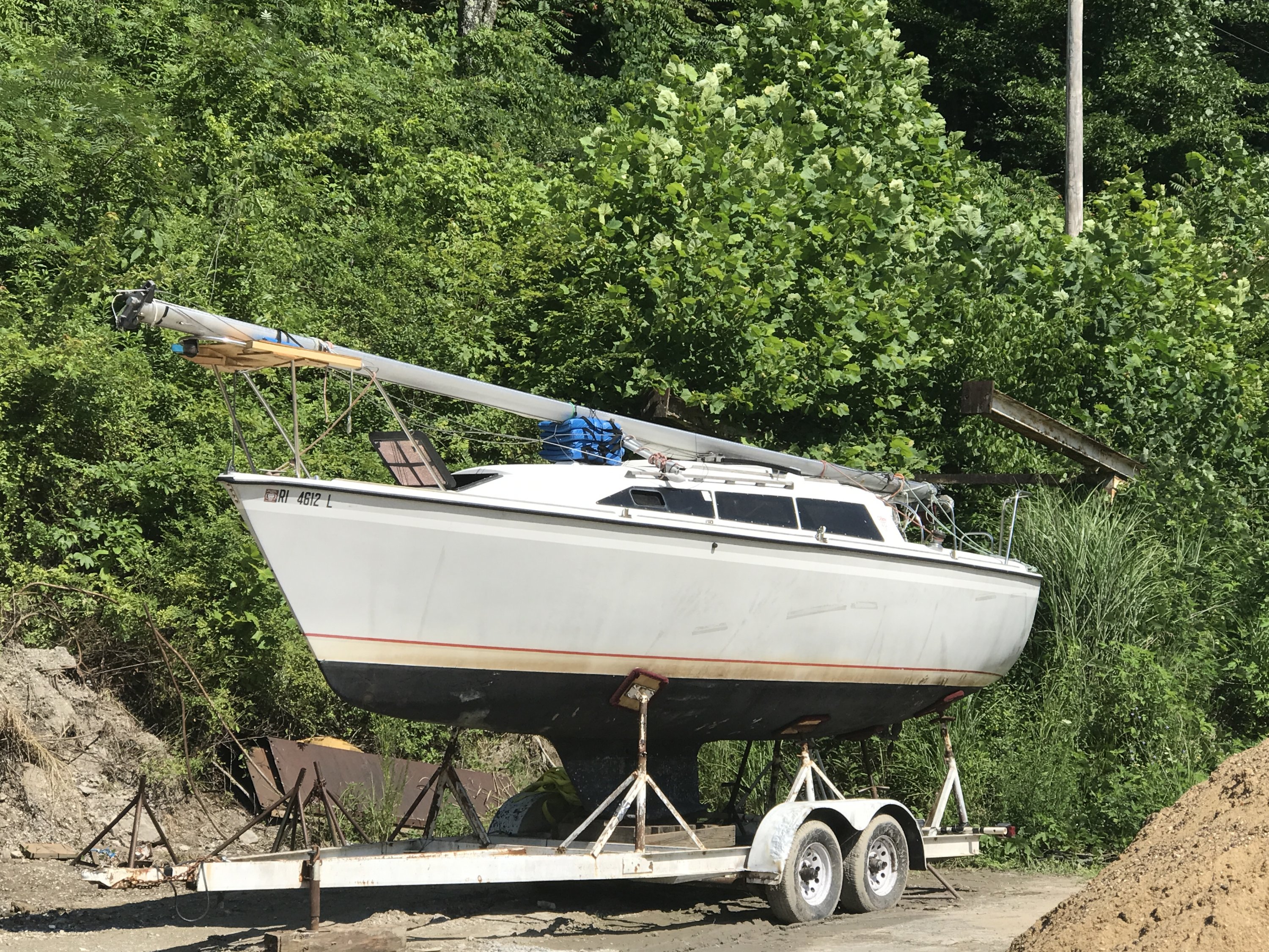

Any reason the hatch is turned around backwards on this boat? I assume all I need to is unscrew the hatch and reseal to turn it around.?
All on my to do list. The list I am sure will get longer as I dig into her.The hinges fit into the frame, so you will have to remove and rebed the frame. The holes will probably not line up, of course, so you should fill the old ones and drill new ones. This is a good time to remove all your through deck fittings and pot them and rebed your fittings with butyl rubber.
Where can I get the upgrade hatch at? The plexiglass or whatever it is is cracked all over and needs replaced. While I'm at it I would like to upgrade the farm as well.It is interesting that it has the cheaper, plastic frame hatch. I would guess it is an 87 or 88? My 87 has aluminum framed hatches. I replaced my plexi with 1/2" while I was restoring the boat, so stepping on it would not break it. However, I am not sure that would be effective with the plastic frames.
Oh, and I see no reason why someone turned it around. It will catch sheets if opened just as well as if it were reversed, and it will not catch breeze nearly as well, as the boat will most likely ride bow to the wind. Perhaps they had it in a slip with the stern facing the prevailing winds?
I don't know of a hatch with a plastic lens that a grown person can step on and not risk breaking it. Don't think like that. Stay off the hatch and tell guests the same thing.I want it heavy enough I can step on it and not busy it.
Well, I agree that I would not plan on it being a common occurrence. However, I weigh 157, and my aluminum hatch with 1/2" plexi doesn't suffer if I step on it. I do not make a habit of it, but it is nice to not have to avoid it.I don't know of a hatch with a plastic lens that a grown person can step on and not risk breaking it. Don't think like that. Stay off the hatch and tell guests the same thing.![]()
